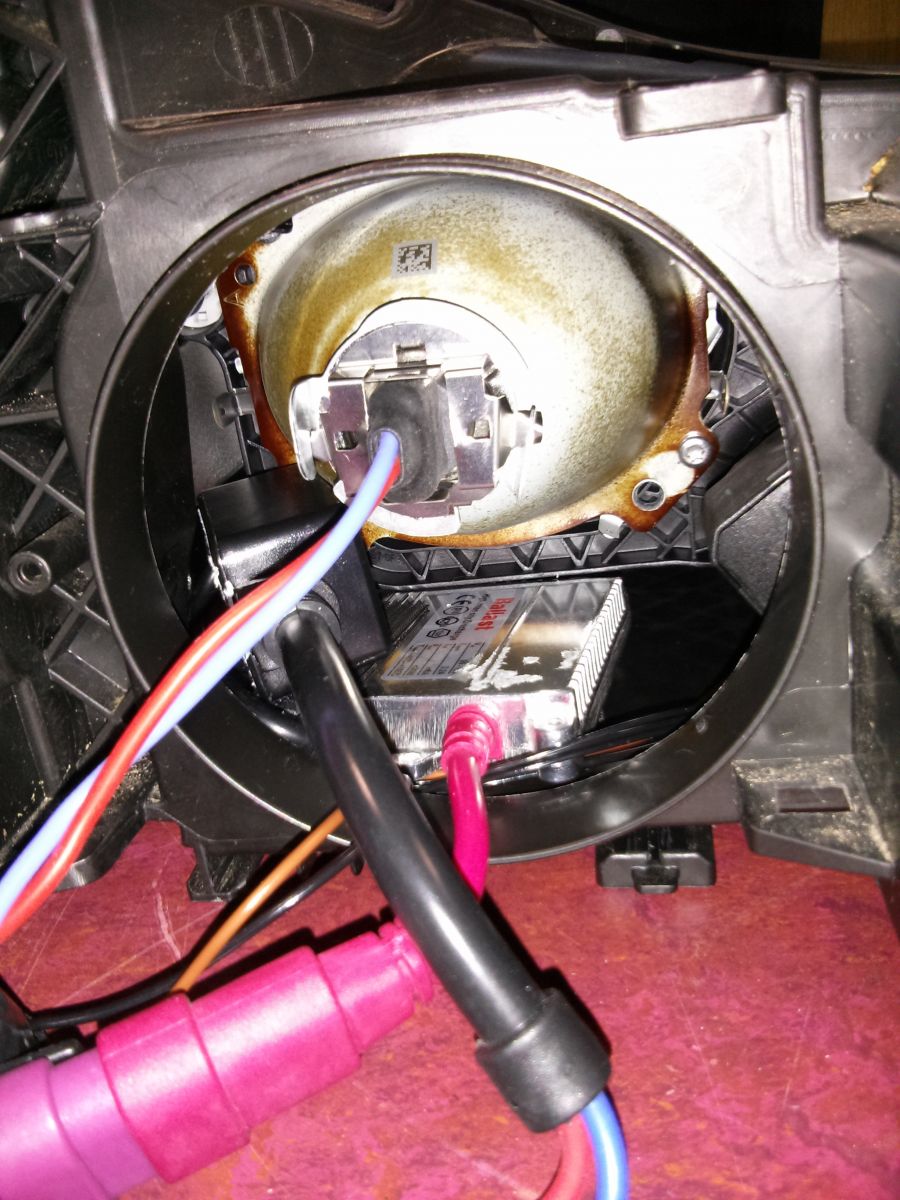

Yes, that is what I discovered a definite dark line down the centre of mine. I definitely had to do a slight mod to my bulb base / headlight clip for it to sit right. Here is the picture I took of the back of my FL when I put the HIDs in. You can see if you zoom in the clip is not symmetrical so only goes up one way, the seating of the bulb needed to be modded to get it to seat in the clip, as you can see the tab sticking forward at the top of the clip, would normally stop the bulb being put in the other way up.
