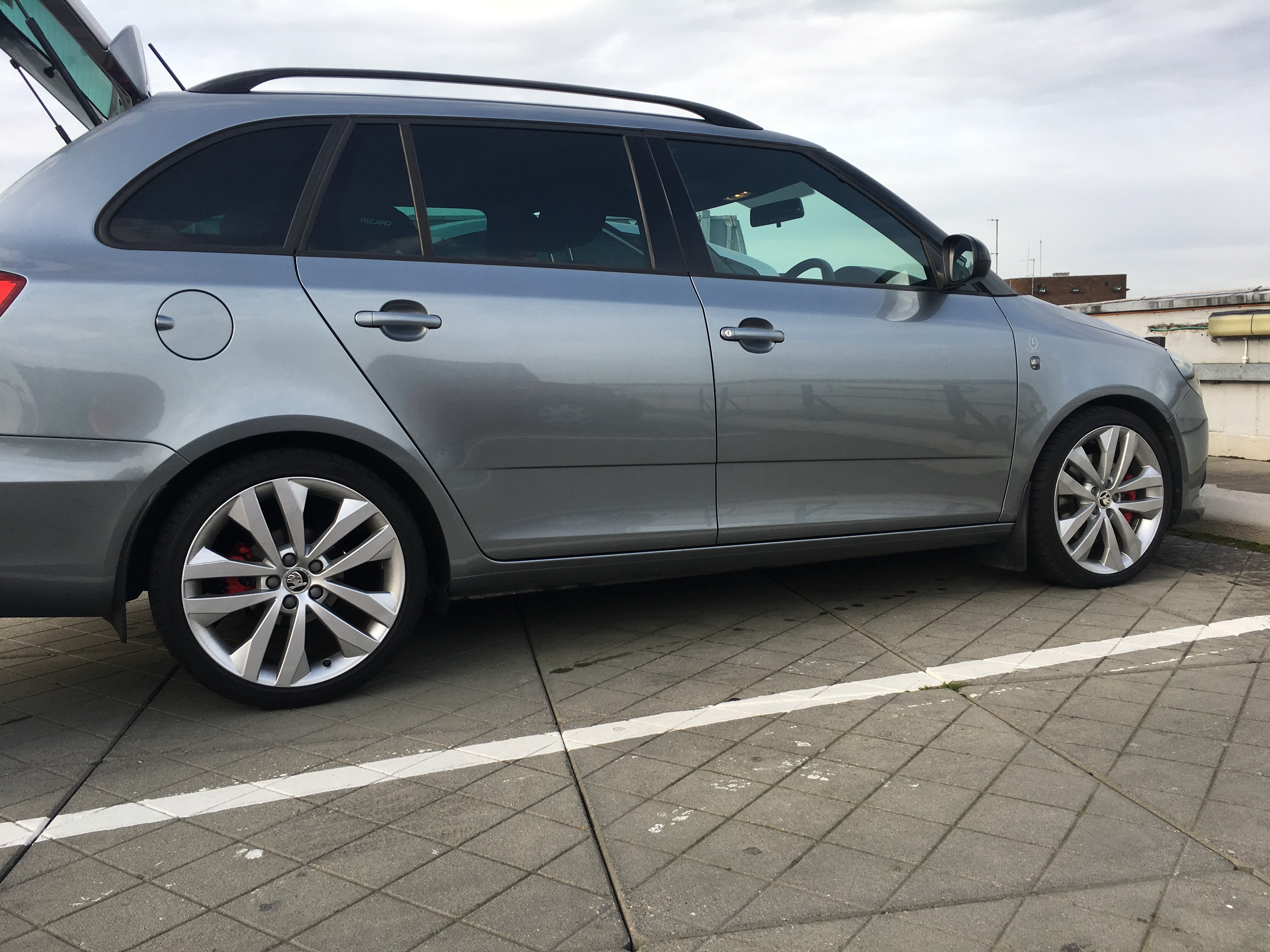

Just send an email to H&R in Germany and they will come back to you really quickly with part numbers etc.. for arb and lowering springs..then just Google the part. I bees or pop it into eBay.de and you will get a bargain.. they are a really comfortable ride even fully loaded with ski kit, roof box and 2 kids. Never looked back on my estate. Was so impressed I have them on the wife's Fabia vrs too.
Looks lovely that does Esseesse200 :)

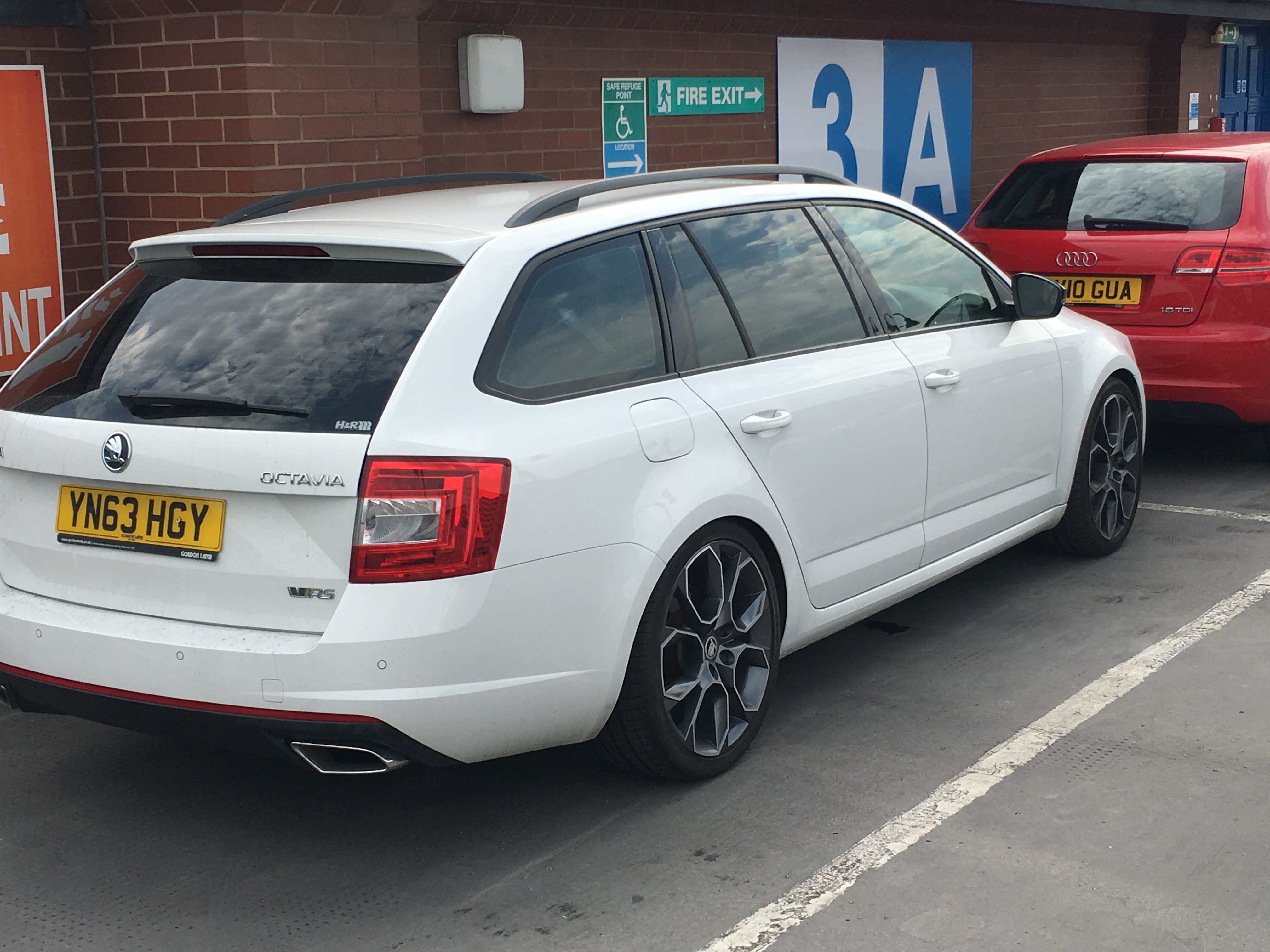

Get a pic up Stu, wanting this done to my VRS.
Here we go - I've posted some on my build thread. I'll get some more up once the car isn't embarrassingly filthy!
