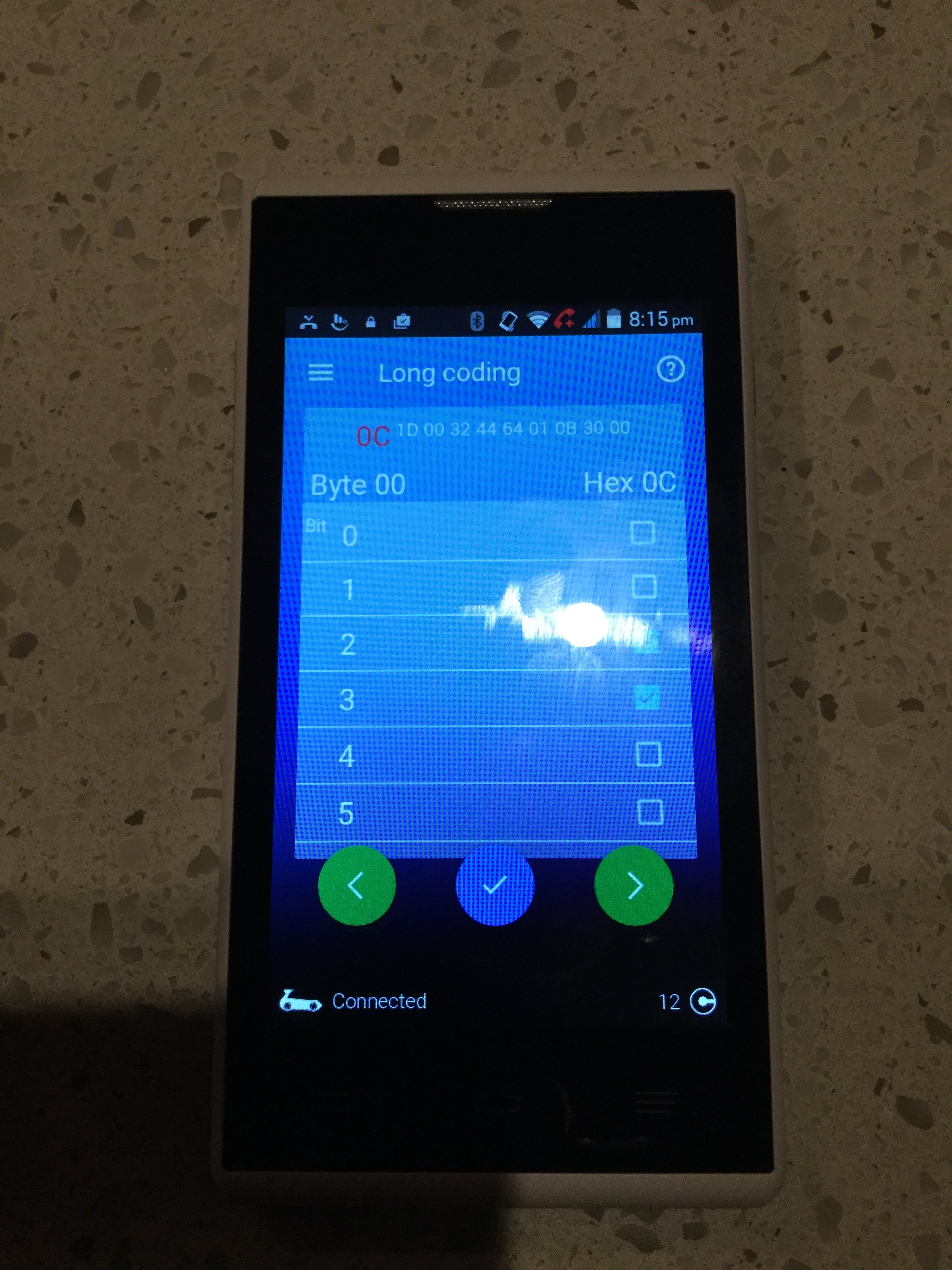

I'm the same bit 0C. Does anyone with vcds know what should be set to have the audi mode? I have obdeleven and superb mkIII made in october 2017.
But VCDS is not OBDEleven and consequently without knowing your current binary code it will be hit and miss.
The coding (and binary) are in the link posted by the OP.
Personally I would try contacting OBDEleven as previous owners have screwed up their coding with OBDEleven
Hi. My configuration is this. I have seen that other people, having bits 0C have put 02 and have not had problems, but I do not know what to do.
Thanks.
