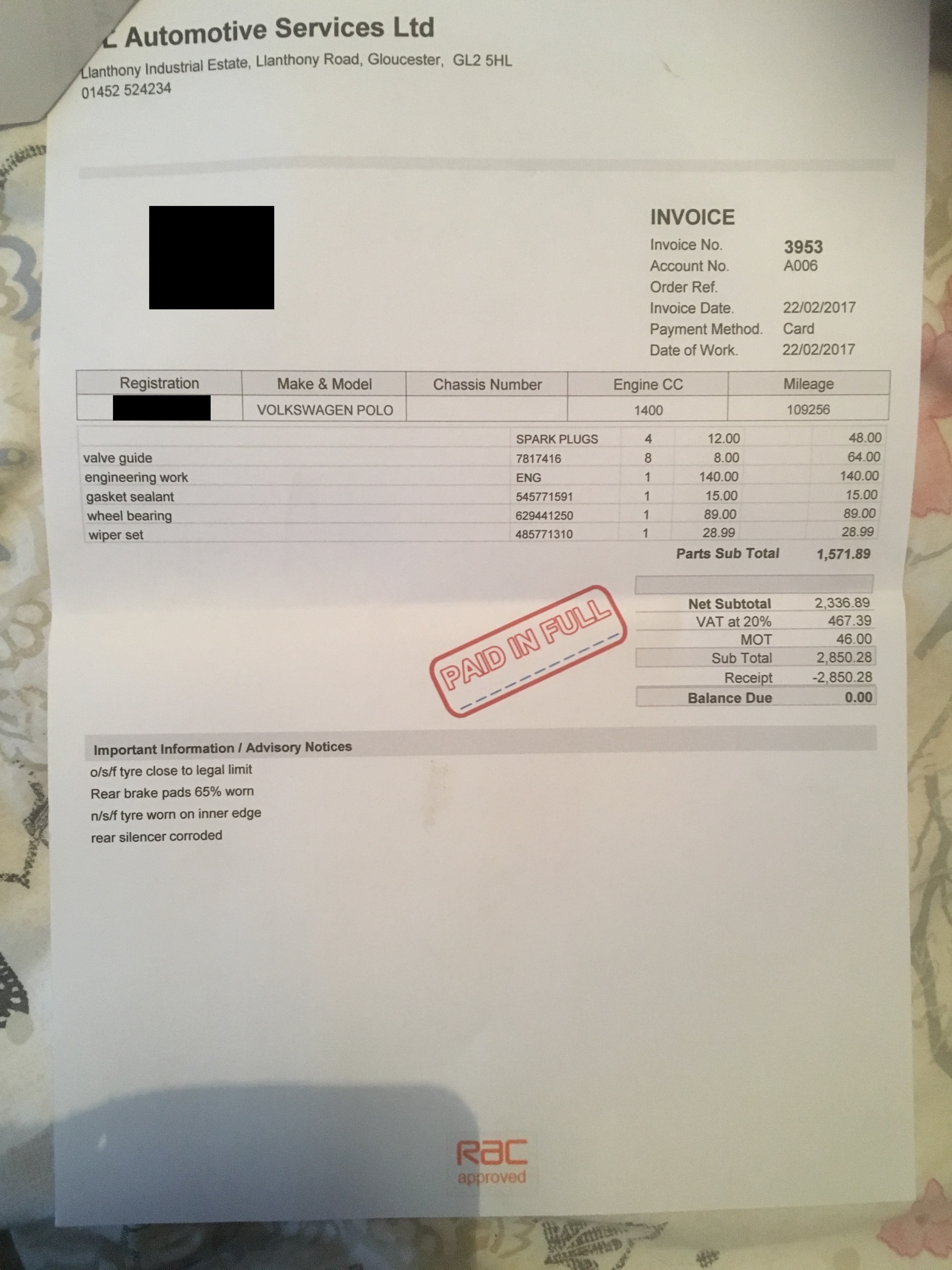

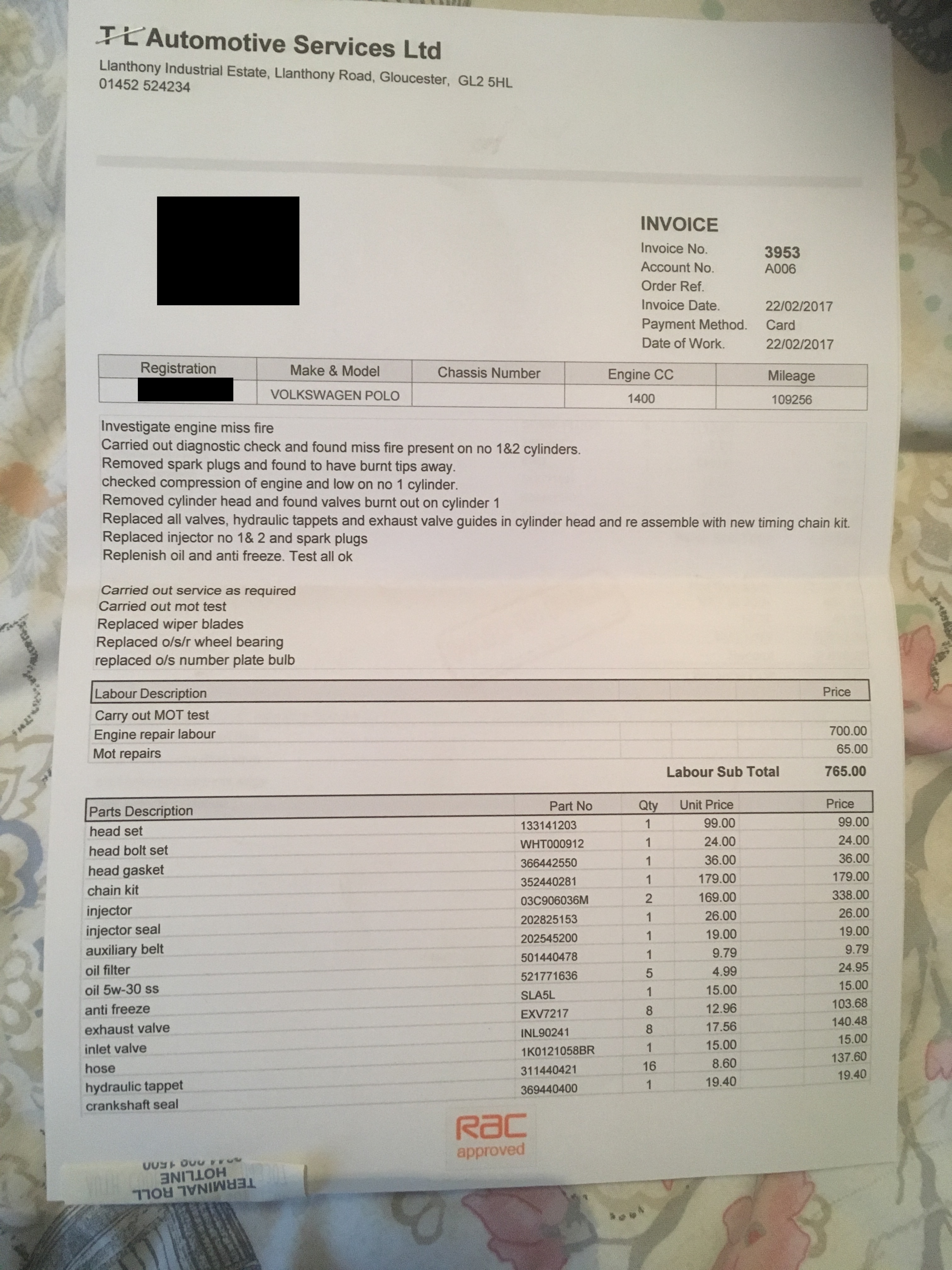

Thank you for the reply.
Work done shown in the pictures!
Basically top-engine rebuild. Garage was chosen as the RAC recovered her and that was where they recommended to go...
109,256 miles.  She bought a rough one there.
 I hope it was a bargain price.
Some list and 5 litres of oil at £4.99 a litre.  Well there is the cheap bit.
IF THAT IS SEMI SYNTHETIC THAT NEEDS REMOVED AND FULL SYNTHETIC PUT IN.
Spark plugs not on invoice but it says injectors 1&2 replaced & sparkplugs
EDIT, i see the plugs now £12 each.

Good point about the oil - will make sure I ask the garage. I wasn't aware she was buying it so who knows what the full history is...
Being an Oil user it would be best to get 5w 40 FS (VW 502 00)  But Semi Synthetic is no use.
DENSO plugs would have been best, if NGK are in that is not so good.
It should have the latest available Software.
(You should check if it ever got Breather Pipe / Valve update and Software done in the 6 years.)
I doubt new Oil Spray Jets are worth having done if that was the real miles and that engine never had a rebuild with new Pistons / Rings.
So good Spark Plugs, Air Filter, correct oil 5w 40 Full Synthetic not 5w30 Full Synthetic Long Life.
Super Unleaded 97 as a min, and 99 ron if she can get it.  Latest Software Update.
Then fingers crossed.
