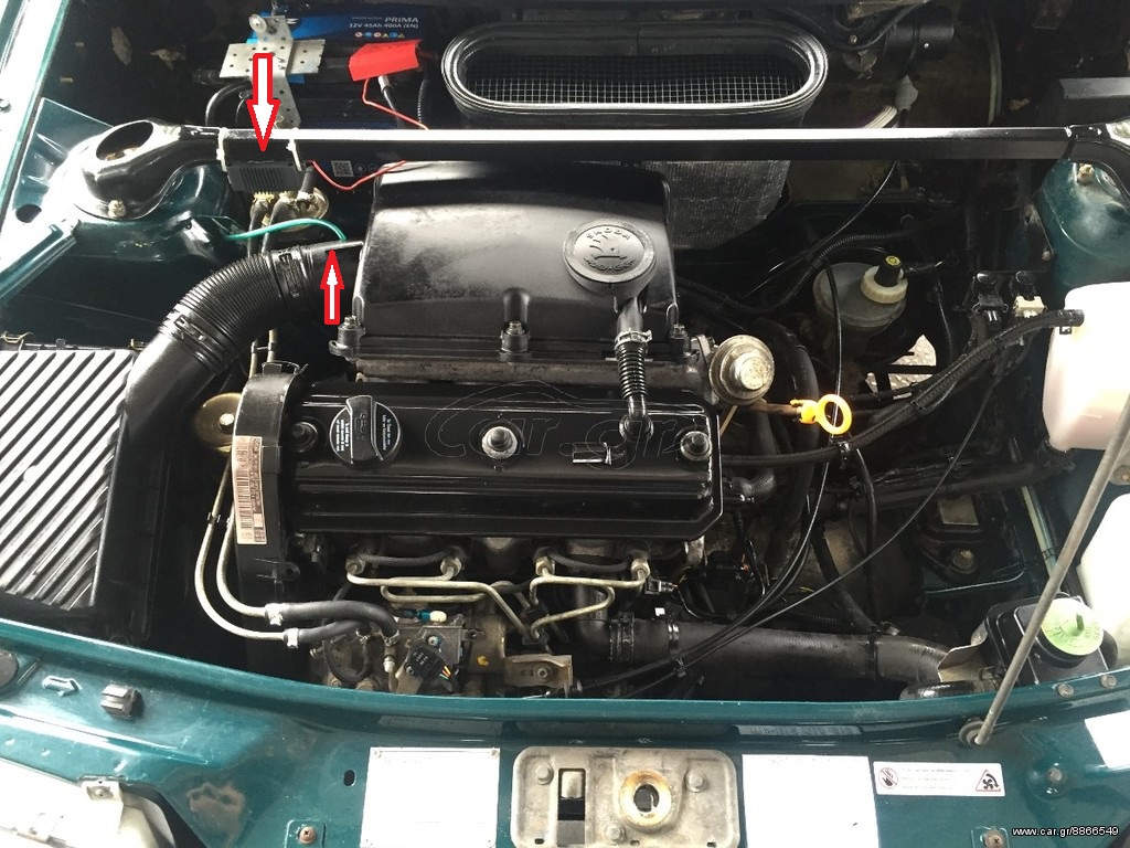

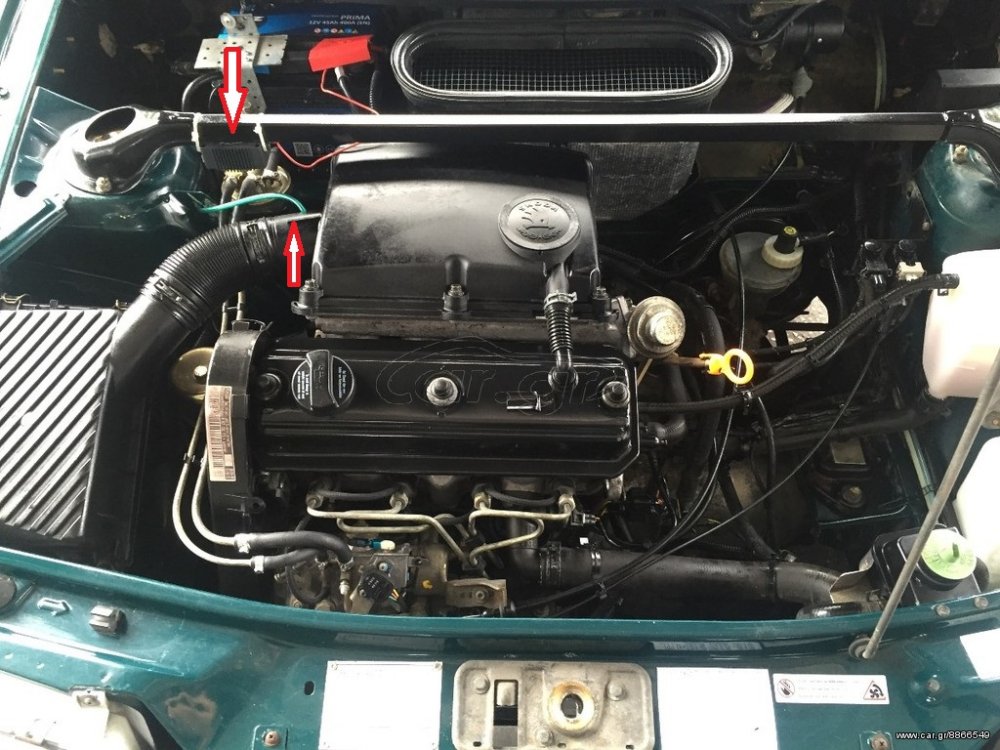

Hello and thank s that i am here
I am going to buy a used pick up and i need help
can someone tell me what are these in the engine s photos
The green pipe goes inside the cabin and it is free at the driver s closet
Thanks in advance
It looks like a relay box or similar for an after market appliance of some sort. Possibly sound system related but can't tell without more info.
Is the "green pipe" actually a pipe or is it a wire?
Thank you for your answer
So really the green is pipe and goes from the air filter intake connection to the drivers cabin closet and ends there free
Hi there, I'm sorry for taking some time to get back to you. I think the pipe is possibly something the previous owner had fitted, possibly a vacuum gauge. You should be safe enough to remove it and plug the hole in the intake pipe.
Thank s again for your post, so finally i took the car today morning and on monday ill take it for check at my mechan .Driving 370 km (to my home)  it was very nice for a 2000 car (first time diesel driver) the documents said that there was 1 owner at austria since 2000 , so i hope everthing will be ok, anyway thank for your kind posts keep heavy or hard my friend.
Thakns for the reading (it mean that someone has try to help) So i went to my mechanic and told me that the first i about mice (to sent thme away)
Second the pipe now is out it was not necessary
Anyway thanks

Good news then. Just to clarify, that'll be an ultrasonic box to keep the mice away. Looks like its worked, your engine bay is quite clean.

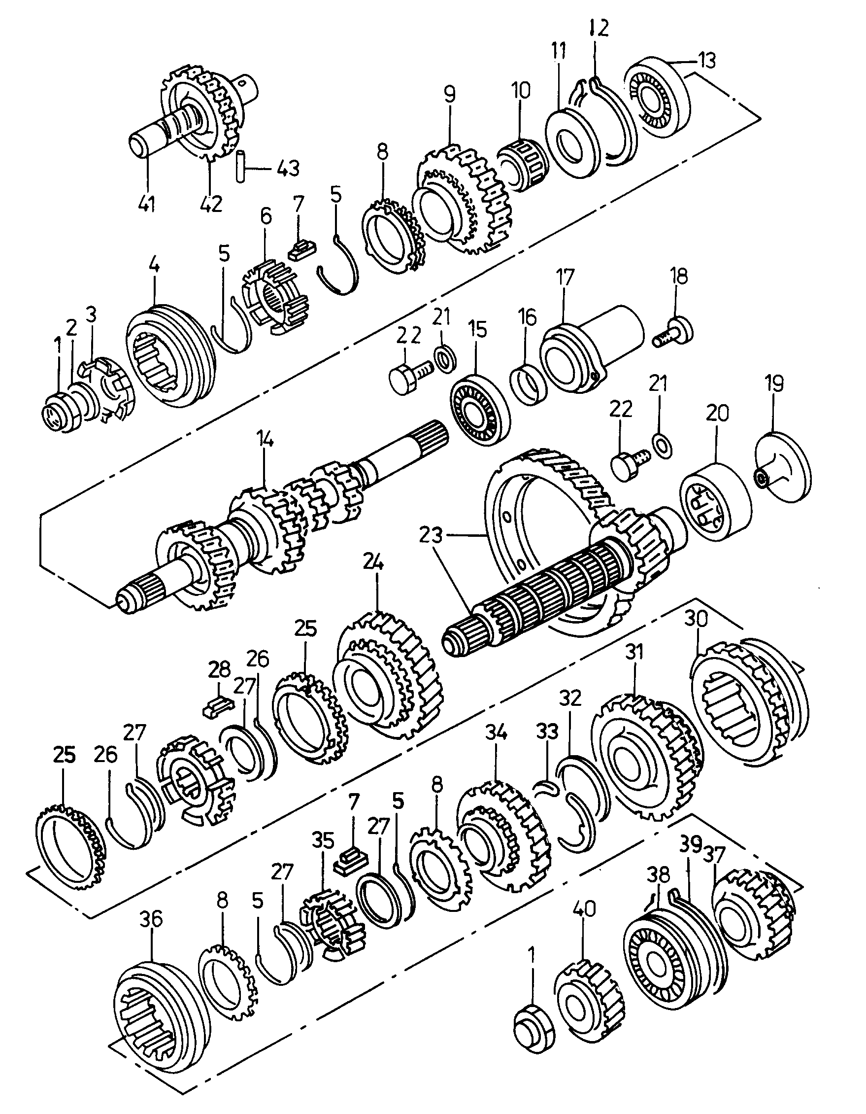

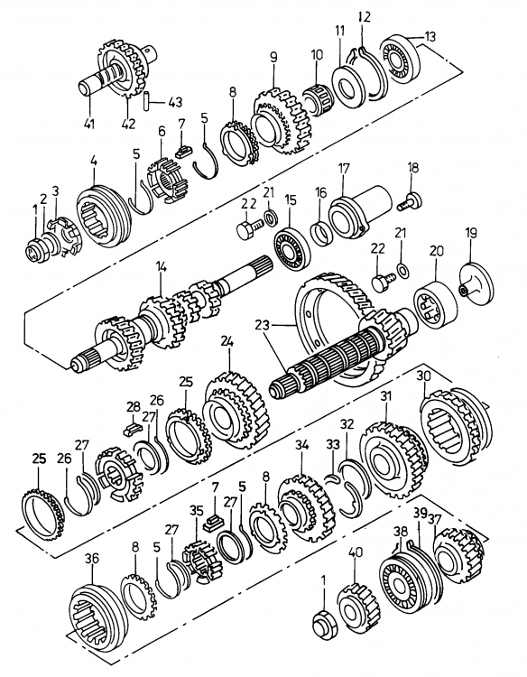

Yesterday a strange noise came down from the engine . Pressing the clutch noise stops and everything is ok. After about 200 km today i came back from farm, so in the morning i went to mech. He drives it and the result is , problem at gearbox bearings! we change the oils (valvoline) he put a magnet were the oil runs out
 the results= TINY metal FILINGS
at the end , when the oil finishing outcoming more of them
 :( so sad . From Monday he ll start the job.

I don't know where those wheel came from, but 175/70R13 is a direct replacement for the normal 155(/80)R13 that lots of Felicias had, as long as it's on a 5.0 or 5.5 width wheel.
As to the gearbox, if it's a 5-speed, ask the mechanic to check if the nut securing the 5th gear cogs is loose.

Well, magnets only find ferrous metal, which is more likely to be from the gears or gear shafts than from the bearings. Most people occasionally "miss" a gear shift which causes graunching noises, and may take a few flakes of metal off the relevant cogs.
As to the 5th gear nut, if it's still attached to the shaft, it's accessible without dismantling the gearbox.
My friend hello again. The results after opening:
Nr 10 needle bearing OFF (destroyd in small peaces)
Nr 13 mounting OFF (not in small peases)
After of 3 hours hunting we found them and tommorow i ll know the price
Until know nothing more but you never know
Thanks for your interesting anyway, it was the first used car and i not gonna do it again.
If the bearing surfaces on the layshaft (#14) are still good (needs inspection), and if such places as bearings factors (specialists in selling nothing but bearings) exist in Greece this might be re-buildable for reasonable money, if you can get the specialist information on setting clearances.

So yesterday i took the car
money: 300 euro
nr 10 & 13 from the national dealer in Greece + the job from the mech
I think it s a little bit expenc but what can i do ,
So the car goes silently now and i m happy, hope nothing else bad comes.
