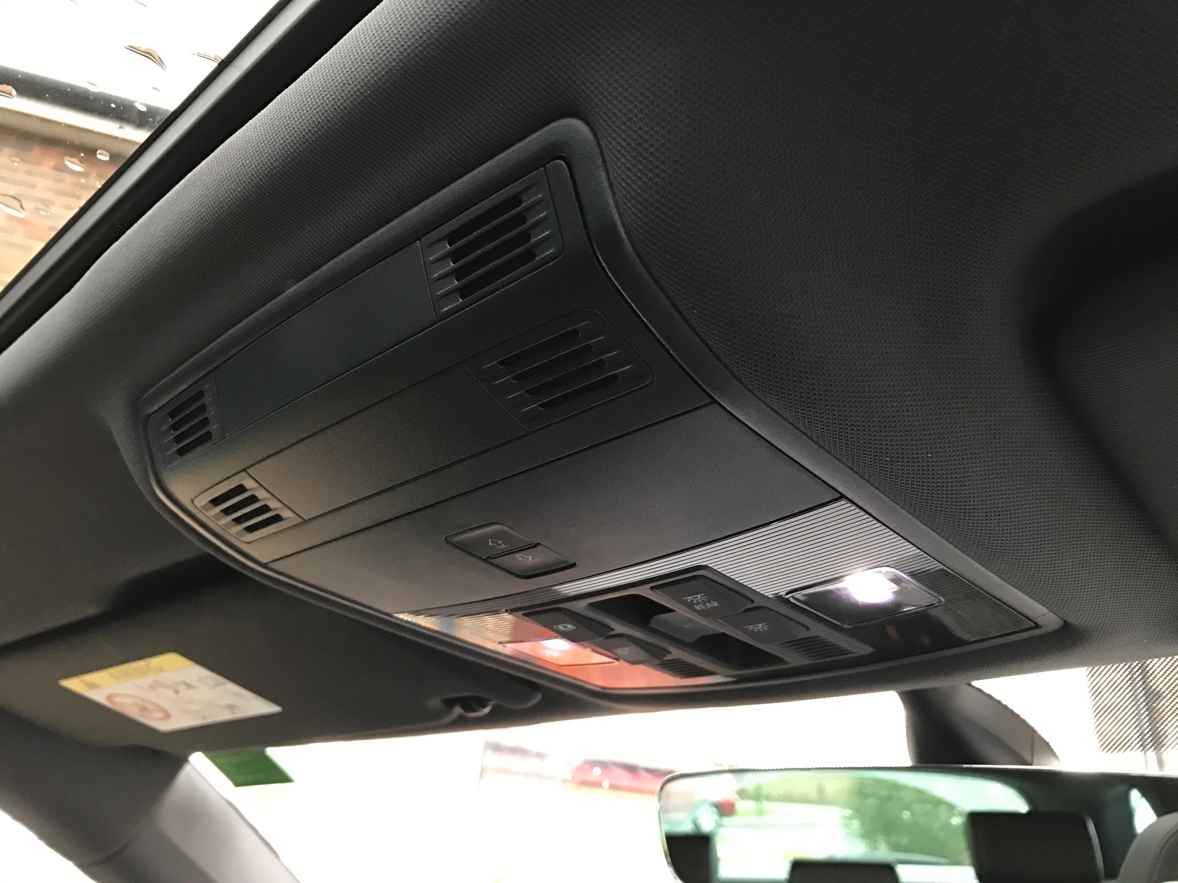

I've got a dash cam that I want to fit (suction mount to the windscreen next to the rear view mirror). However I don't want to have a cable run all around inside to power it. To this end I've got a 12v USB power converter that I intend to wire into the overhead interior lighting pod at the front (image below). This way I can then just have a short cable to the camera and sit it next to the rear view mirror.
My question is how do I pop that lighting pod apart to get into it? I'm good on the electrics side and will find a switched 12v feed in there once I'm in, but I'd like to open it up without damaging it!

I may be wrong here but most on this forum have fed from the fuse box, I suggest this is because that the feeds to this pod will be permanent live..... all function without ignition on, even in your case the sunroof which can be closed from the  key fob...

There might be something in the manual as if the sunroof fails there's usually a hand cranking point hidden in this pod and the manual should tell you how to get to it (It does in the Superb II anyway). If you use plastic tools to lift the edge of the panel it'll probably pop out. I'd start at the back corner and work from there.
I ended up going back to the fusebox and hiding the wiring in the A pillar trim and tucked inside the front of the headliner. Added a split-fuse holder to the rear washer fuse and ran it from there. All nicely hidden away and not a scotchlock in sight!!
