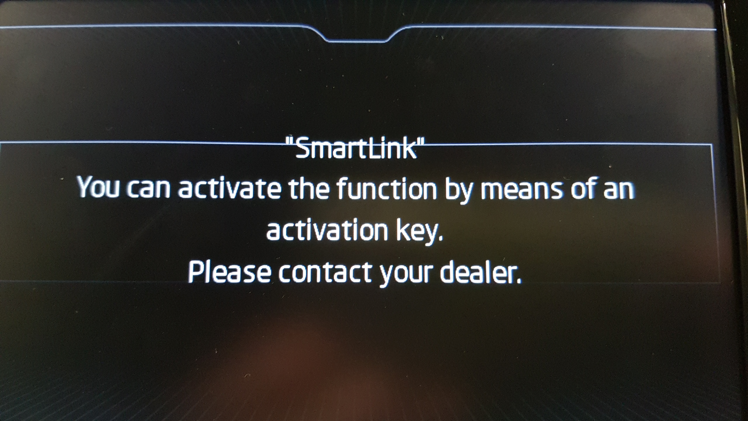

I collected a new Octavis SE Sport model last Tuesday. I wanted Smartlink, but the was already manufactured. The sales guy said that they could fit it in the dealership.
When I collected it, the sales chap said there was a problem getting the Smartlink system to be accepted by the car's systems and that their technicians were working with people back in Germany to get it sorted out. I chased it on Friday and got this message back from the sales guy, " From what I have been told it is a Skoda UK issue and they are working to resolve it as soon as possible. There are a few with the same issue so as soon as we have one resolved we will be able to sort them all."

Had mine "activated" by dealer, no problem at all. Smartlink just needs a code, but Smartgate requires installation.
Interesting. The sales chap gave me the impression that they had installed something; like a physical module. But I'm not sure he/they really know what they are talking about.

Yeah I know you know the difference, but smartlink doesnt include any kind of module. My dealer activated my smartlink for me even though they werent aware it could be done before I told them. Hence the garage you are using seemingly dont know their @rsehole from their elbow and could be doing anything.
Hope they can get it sorted, should be a 20 minute job for someone with instructions or someone competent.

The procedure is:
place battery on charge>connect diag machine>select activation>enter activation code>remove machine and charger>test
Thanks for this James. I will chase them again.
