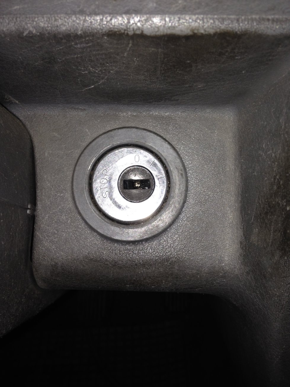

PS, it starts with a push start, so the ignition circuit must be on, somehow ? Or am I showing my ignorance here ?
As usual, Generic Ken has no idea how things are and work on Felicia. The ignition barrel is marked Stop, 0, I, and II (see photo). logicaljohn said clearly that he can turn the key to 'ignition on' position. But who has eyes to read?

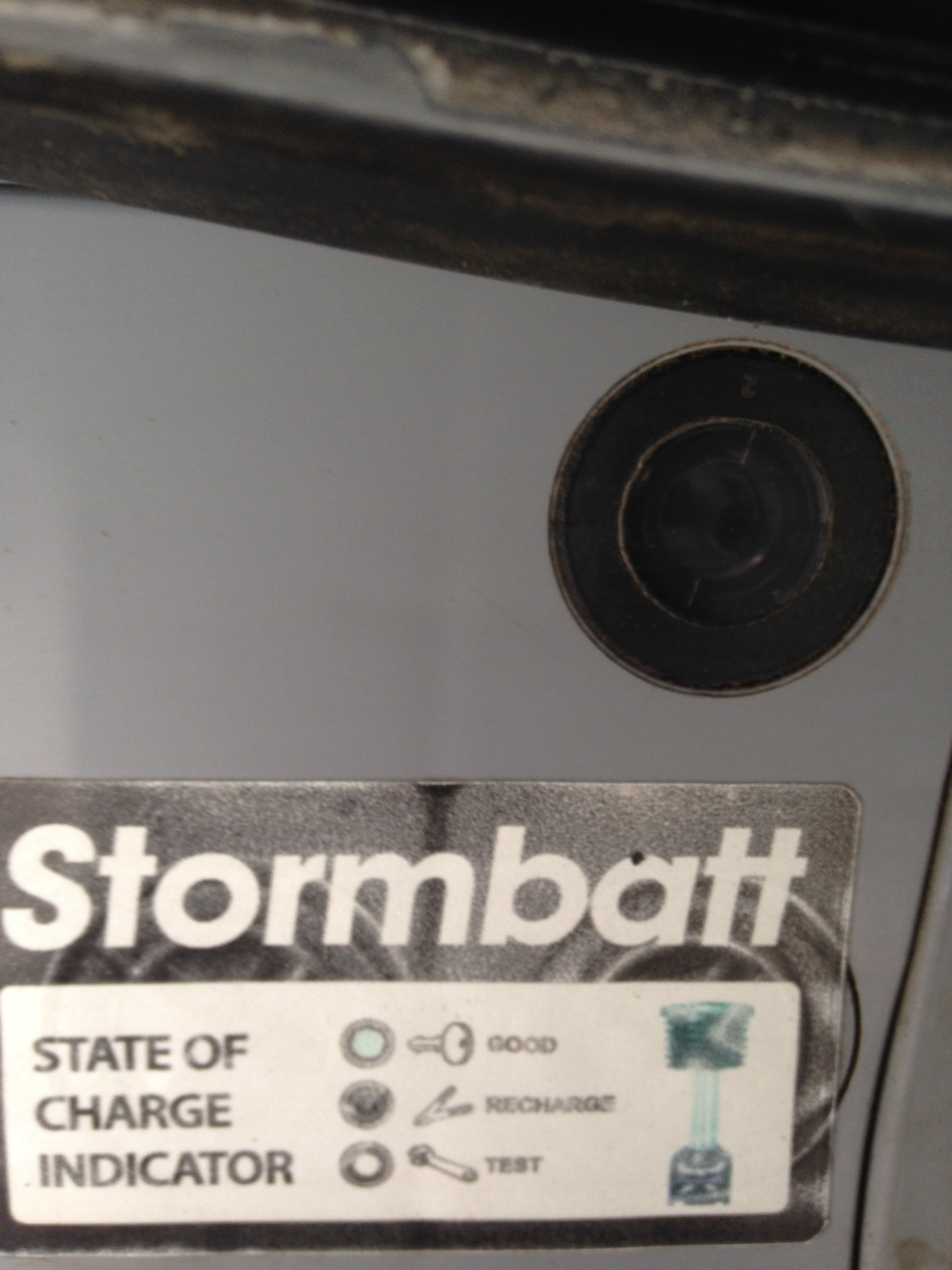

I've taken a video - not sure how useful - of the key not turning. I've checked the battery, which is about 3 years old (the car had a faulty voltage regulator when I first got it, which effectively boiled the previous battery on its maiden long-ish journey. So this was replaced then. I recall that when I returned to Bulgaria from the UK in March 2016 the alarm appeared to have drained the battery (I was away for 3 months or so) so I disconnected the alarm and fully recharged the battery over a couple of days, the car has been fine and done a number of longish trips since then 2 -300 kms. I was away to the UK again for 6 weeks this winter and since the start of Feb have made a number of trips in it (our local biggish shopping centres are both 20 km away, and visited every few days, so I would have thought that - alternator problems notwithstanding - the battery should be being topped up. However, this battery has a charge indicator which seems to say 'recharge' (may need to borrow that battery charger again), also, perhaps significantly the winter was particularly hard this year, with temperatures of -12 to -18 for up to a few weeks. The car lived outside, was used a few times by our house sitter/guest, but it was, by all accounts, bloody cold. And snowy etc. Much more so than normal for these parts.
I've tested the battery - cold 12.45v. with engine running 14.5 v and with the engine revving 14.3/ Trouble is I am not sure what these readings mean but my suspicion is that they indicate the battery is ok. Also I checked connections to battery, starter, and block. all seem good. The fact that it starts with a relatively light push also indicated battery (relative) health to me.
