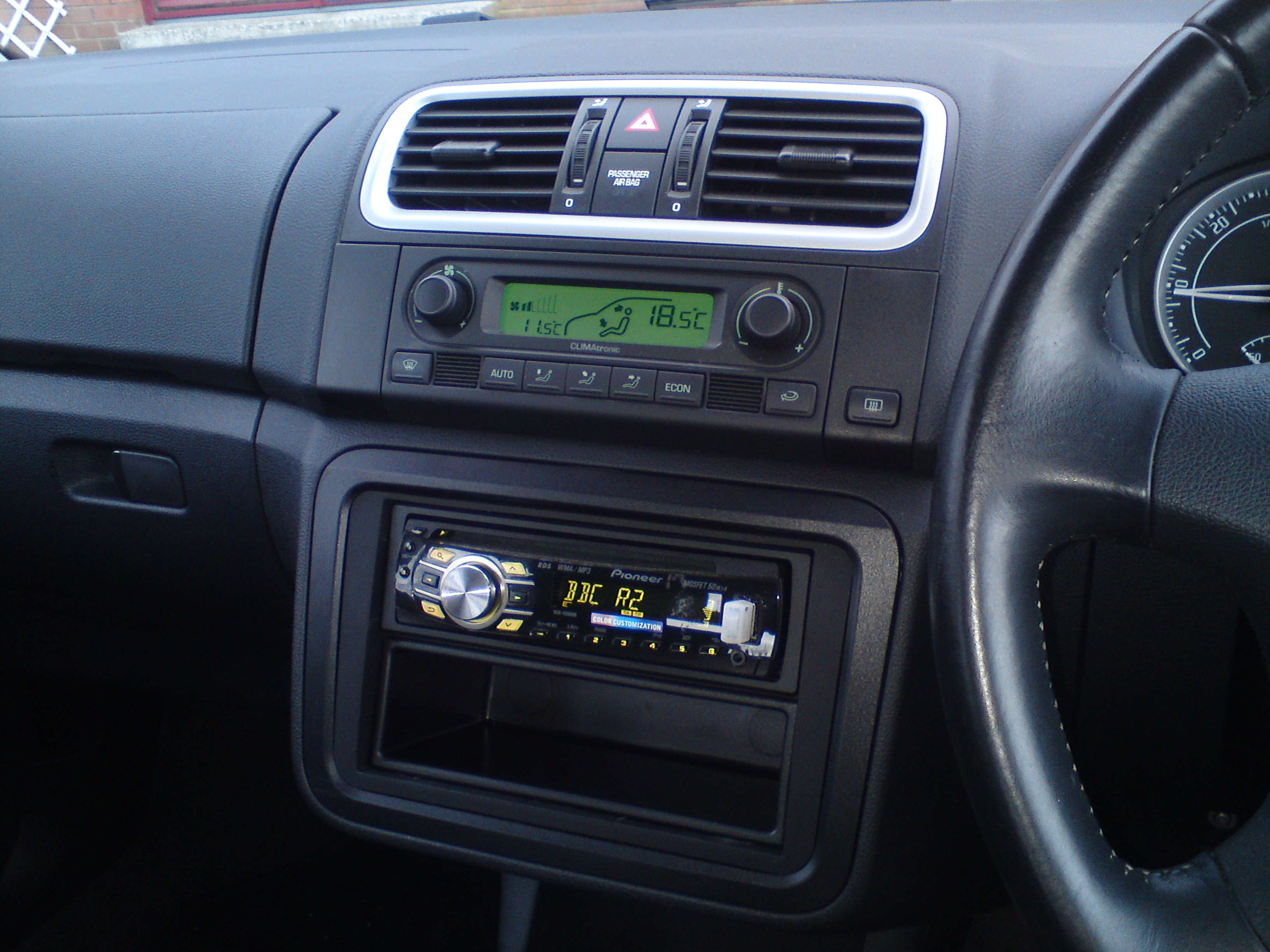

Older cars of course used to have an 'aux' posn on the ign switch so one could listen to music with the engine off.DSC01564.JPG
