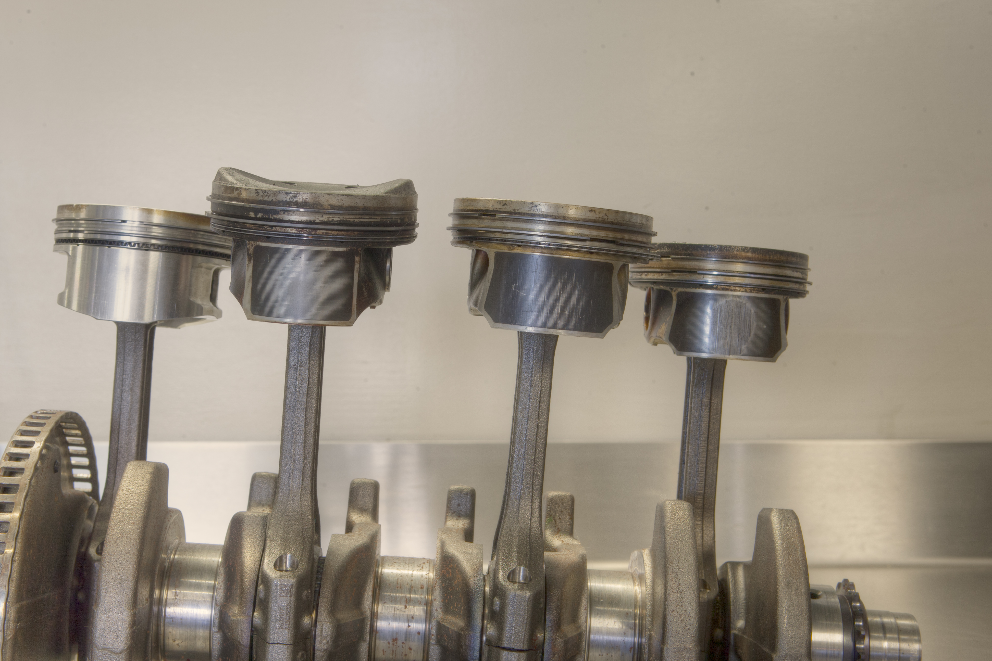

Also for newer 1.8 and 2.0 TSI's, it's better to change to a max 15.000 km (10.000 miles) interval, because the oil consumption problem was definitely not completely cured in 2011. Even last year Audi changed the design of the oil scraper ring again. Now to a very open design similar to the left piston in the picture below. (Picture source is Hartog, a tuning and revision company in the Netherlands, who revise many, many 1.8 and 2.0 TSI engines these days)

That´s true, set of OEM rings with scrapers of "waffle structure" or "Miniflex" for 1.8TSI used on latest pistons 06H107065DL from 2015/2016, same set of rings can be used on previous pistons 06H107065DF used from October/2011, the set of rings alone is 06H198151J.
@andrehj nice compilation for an exhibition, three types of pistons on one crankshaft :thumbup: where did you found it on that site, can´t see it, must be some intern info :cool:
I am sure English and German mutation of that site would bring them much work ... ;)
Edited by rayx
@rayx: The photo's were posted on the Dutch Skodaforum.nl.
Thanks for the numbers of these waffle structure piston rings. Didn't have that yet.
Edited by andrehj
Oops, you're right. There was a link on Skodaforum.nl to your linked article on AMT.nl.
