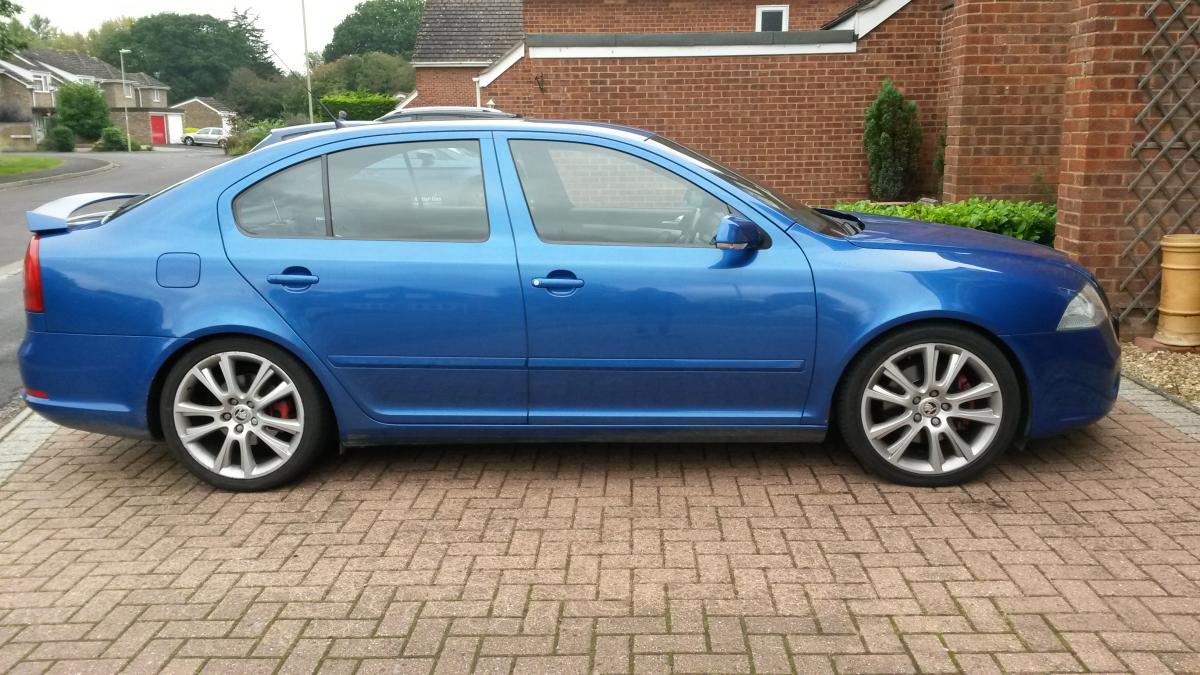

I paid €124 for the springs and the ride is excellent with stock dampers even with 19s, the drop is subtle and for me exactly what I wanted:

An ideal drop for me equalises the arch gap at the top with those at the sides...
Before:
After:
For these kinds of drops coilovers aren't needed unless you need to adjust the ride height, but I'd wager 99.9%, if not more, of coilover equipped cars get set once and then left at the same height forever... ;)

I didn't measure mine before and after but I'm very happy with the result :)

my car on -50mm vogtland springs lowered it about 35mm my drive slopes slightly to the left the car sits nice and level very happy with them for £107 should be £150+
