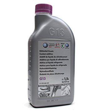

Carrying a can of G13 is good, better if you predilute to 50% (which requires another container) and dont forget to mark the containers as prediluted to prevent confusion.

Strangely, my 1,5 litre can of genuine VAG coolant is definitely undiluted and there even  is a graphic on the rear label showing the dilution ratios (with H2O, no warning of what flavour) for various temperatures (-24C to -52C)
