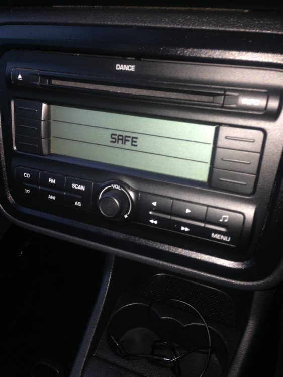

So my fabia had a flat battery it had to be jump started after the jump start the radio decided to put itself into safe mode every time i turn it on it says safe mode and then it shows a four didgit pin code.
Does anyone know what to do with this? The dance handbook mentions little about this
Thanks
If it's the original, with the engine running switch it on and wait a few seconds and it should sync back up.
if it doesn't work and still asks for the code then it isn't your factory radio and you need to get the code from the dealers

my code for my radio was written on the back of the radio strangely
