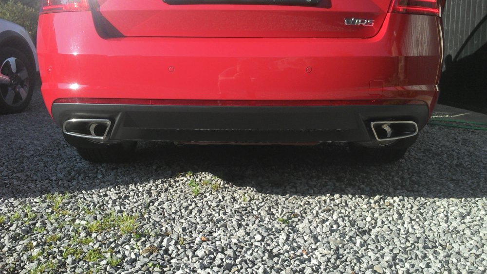

Mine is resonated. If you've driven with the back seats down on your car on the motorway then it sounds like that when the exhaust is fitted and the seats are up!
Here is a link to Scorpion FAQ section. https://www.scorpion-exhausts.com/faq
I have tried to record it in the past but it doesn't really come out good.

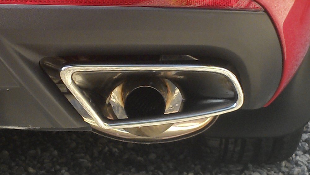

This is what it looks like fitted.
