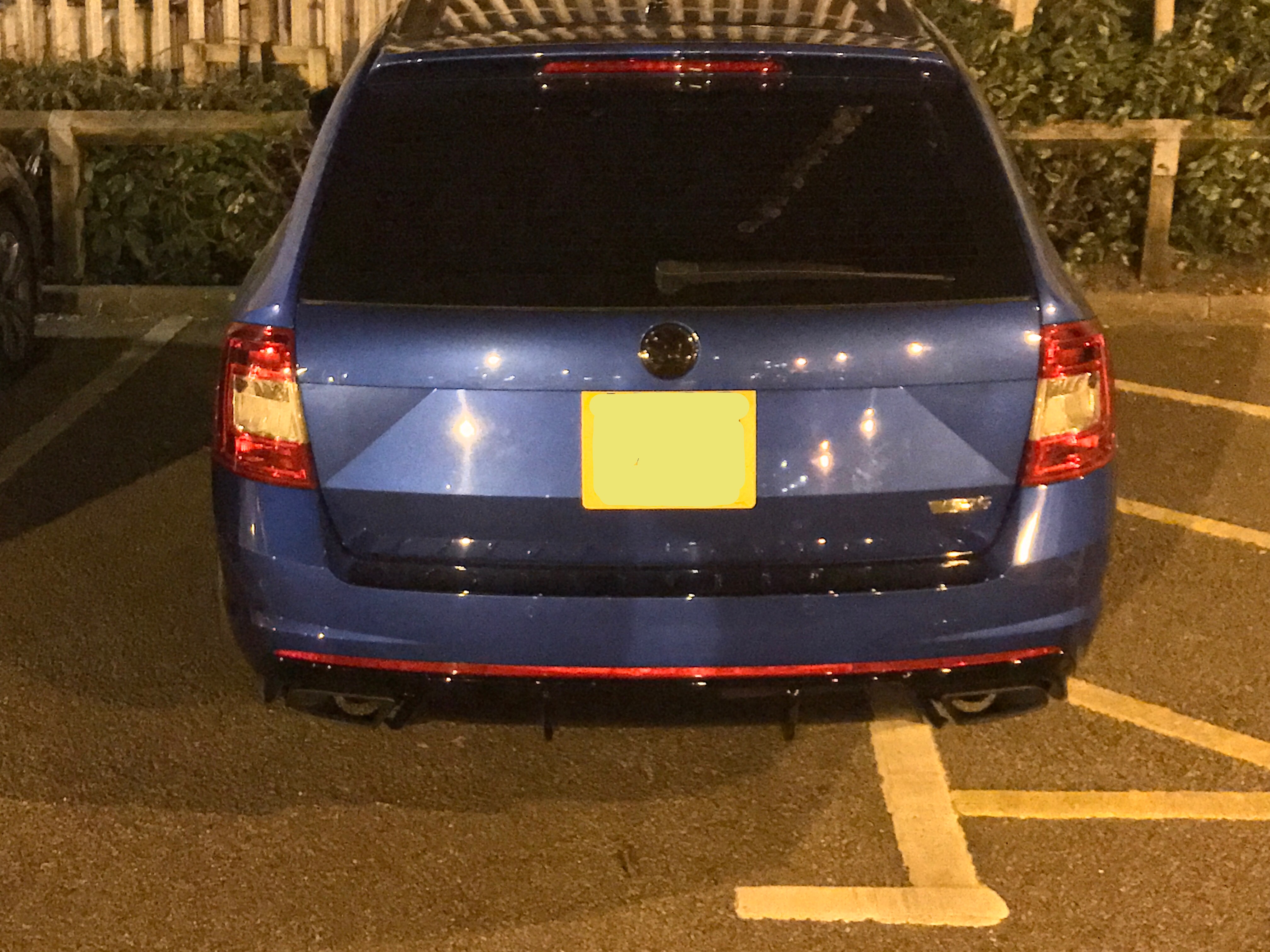

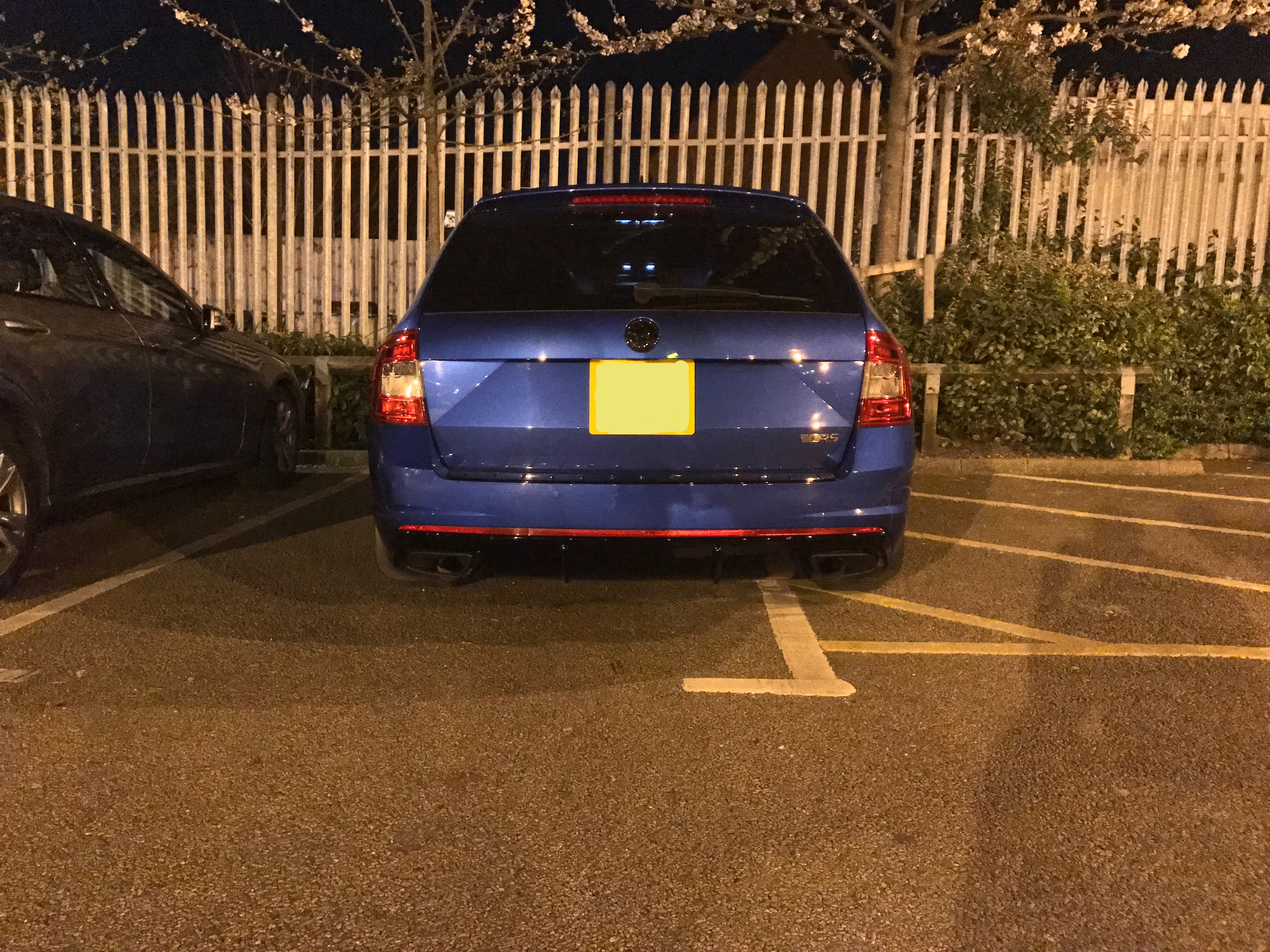

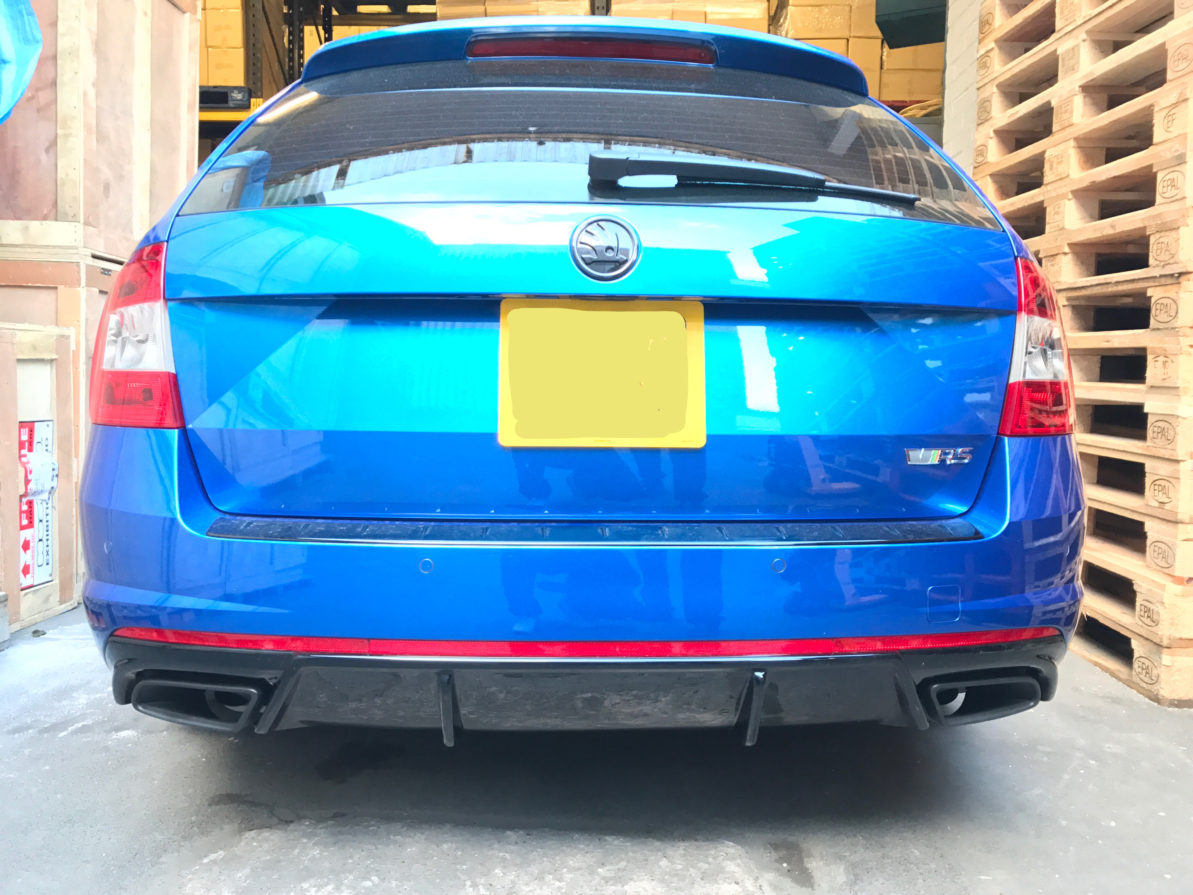

  • So today me & a friend went about fitting the Rieger rear diffuser  & it was quite a simple job  no jack needed, I did re-watch the Hollowman YouTube video just to refresh my brain "on how to
  • All done and fitted, thanks for the advice Batvan

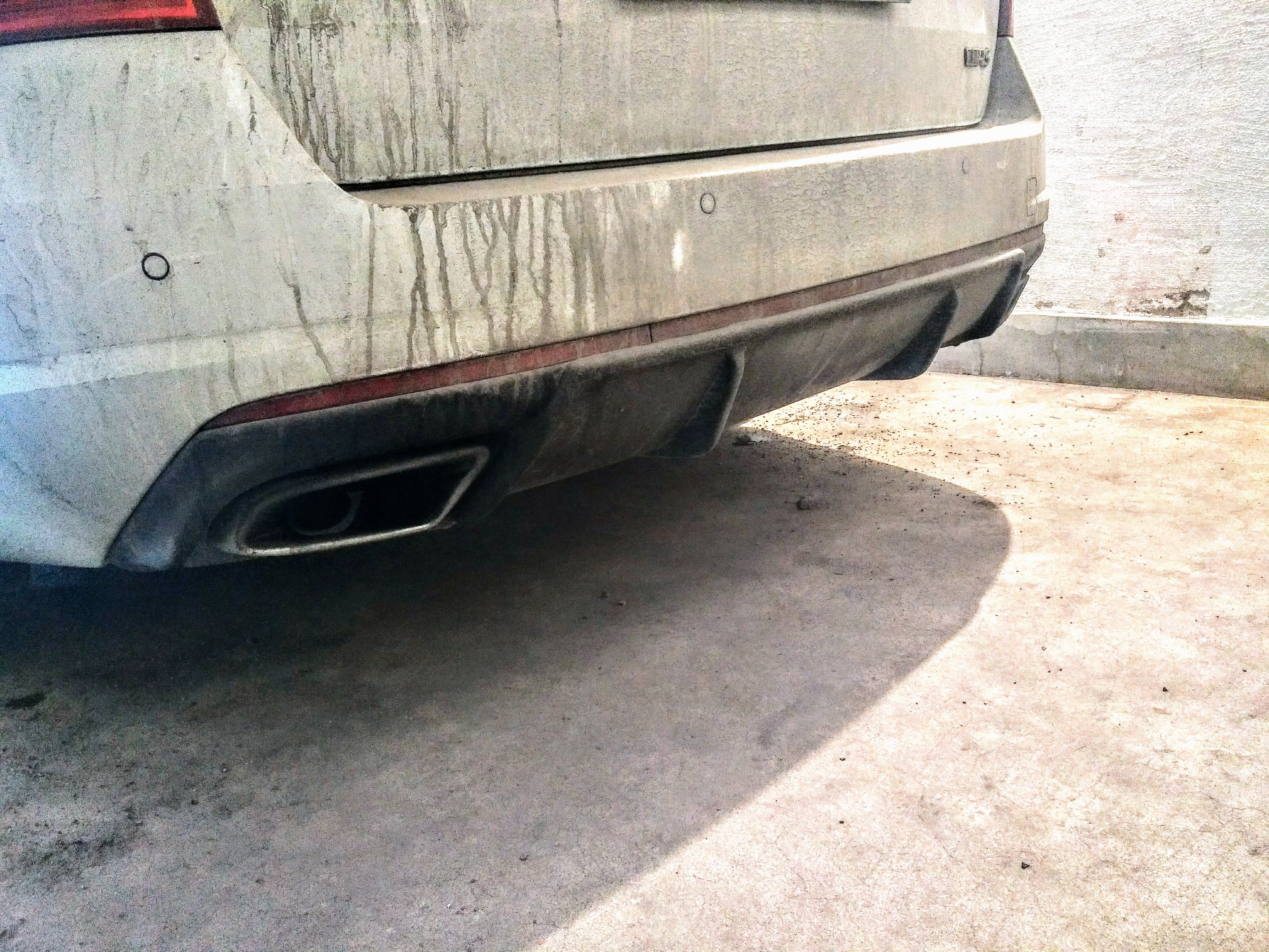

As promised, this is how dirty my glossy black is now ;)
:blink: Spit n polish be good as new :giggle:

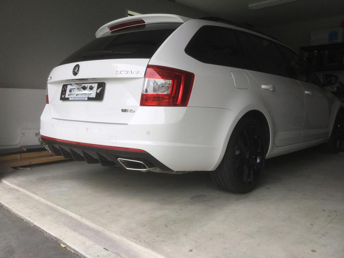

@Ads230 when you got the oem diffuser and the reflector off the cup edition diffuser fits upto the bumper so there isn't a gap.
Ah. The Rieger one doesn't do that..., it fits just below. I'll take a look at other options for removing the reflector then, cheers.

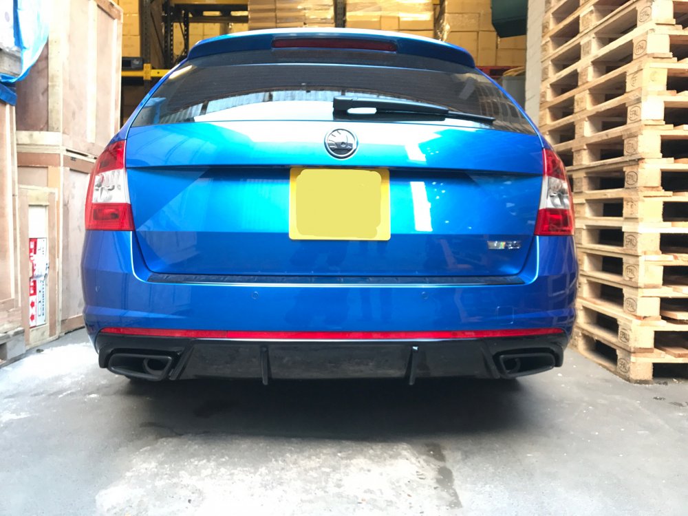

Order placed on Wednesday & received this morning from Ian @ On-Line Auto Sport shop - eBay opened package & all seems perfect :thumbup:so hopefully the weather will be nice over the weekend ready to fit, will take some pictures, before Rieger diffuser & after Rieger diffuser installed, also purchased on last Thursday a square rear number plate which I've fitted already & looks much better B)

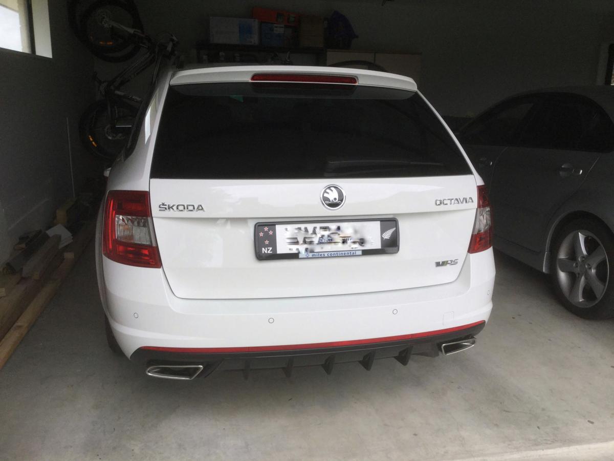

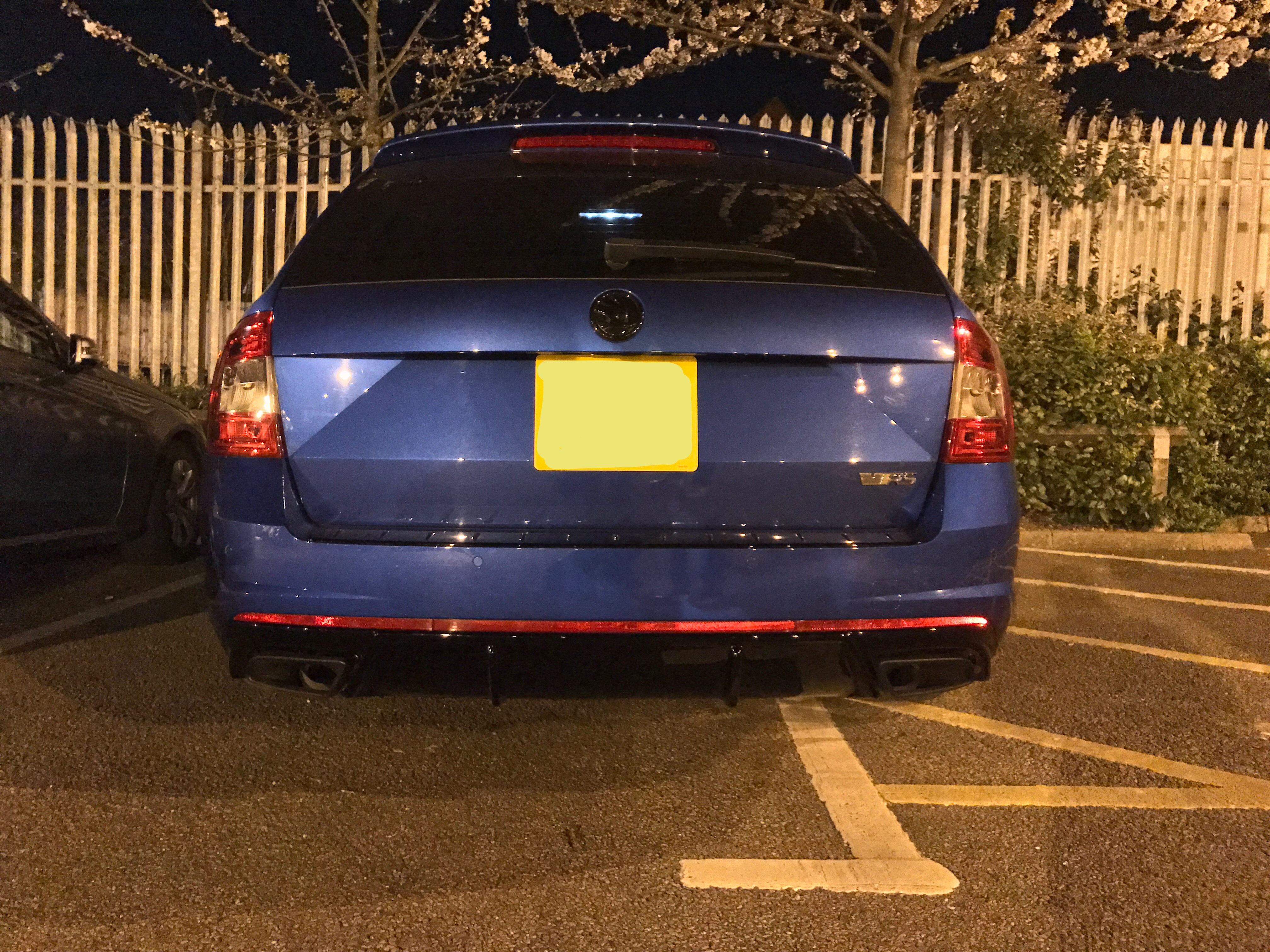

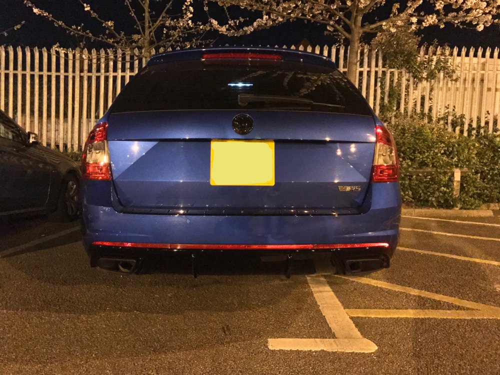

This is mine yesterday afternoon . I hope it's worked today
Please make more pics later- it was hard to tell from SuperSkoda site how it looks in real life ;)
BTW, is it legal to remove those reflectors from the rear?
I will do. The superskoda pictures wasn't the best but I wanted to get rid of the reflector. They're reflectors on the rear lamps plus if they can't see a big white estate car parked up then they shouldn't be driving lol

The size is 11 x 8 as it is a standard British size plate used on trailers & Land Rovers (so you shouldn't really get any unwanted bother from the sweeney) :D be careful if you purchase a 12 x 6 (USA import size) or a 13 x 7 (Jap import size) as you are not fitting it to those mentioned vehicles & could possibly get you in unwanted bother, but it's down to the good cop bad cop routine if that is unfortunate to happen.
The 12 x 6 will fit better thou, where as the 11 x 8 is just to short to meet up with the rear screw holes (few mil each side short) so I used a clear protection film to cover the screw holes (so they won't get rusty) & then used 2 x 5cm double sided tape either side of the screw holes to stick the plate on, which looks a lot neater & cleaner compared to the screw holes. B)

So today me & a friend went about fitting the Rieger rear diffuser B) & it was quite a simple job :thumbup: no jack needed, I did re-watch the Hollowman YouTube video just to refresh my brain "on how to fit/install it" the Rieger diffuser completely changes the look of the vRS & 100% agree with @Jaco2k that you do really need to see it in the flesh B) as pictures can't really show how much better it actually looks.
@BATVANVRS - looks great, mate. I agree that the gloss version looks epic on the blue cars.

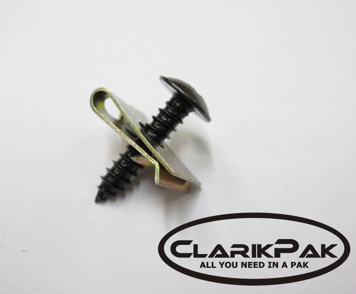

@BATVANVRS Have you got some pics from underneath regarding these clips?
I'm dropping mine into the garage to do and any guidance I can give them will be appreciated :)
@VRS230 I will quickly take a few pictures now for you :thumbup: you will need a couple of this speed fasteners (picture below the gold clip) 1 either side of the end of the bumper (closest to the rear wheel arches)
Edit:
Other than that, it really is simple to fit/job, everything comes in the box, all the screws, black round plugs etc...
The instructions are actually very decent, easy to work out & not like Ikea instructions :D If you get any probs just post in this thread & I will do my best to help you out :thumbup:
Edited by BATVANVRS
Nice one!
So do the above come in the pack then or do I need to buy them beforehand? Or have I read that wrong :D
