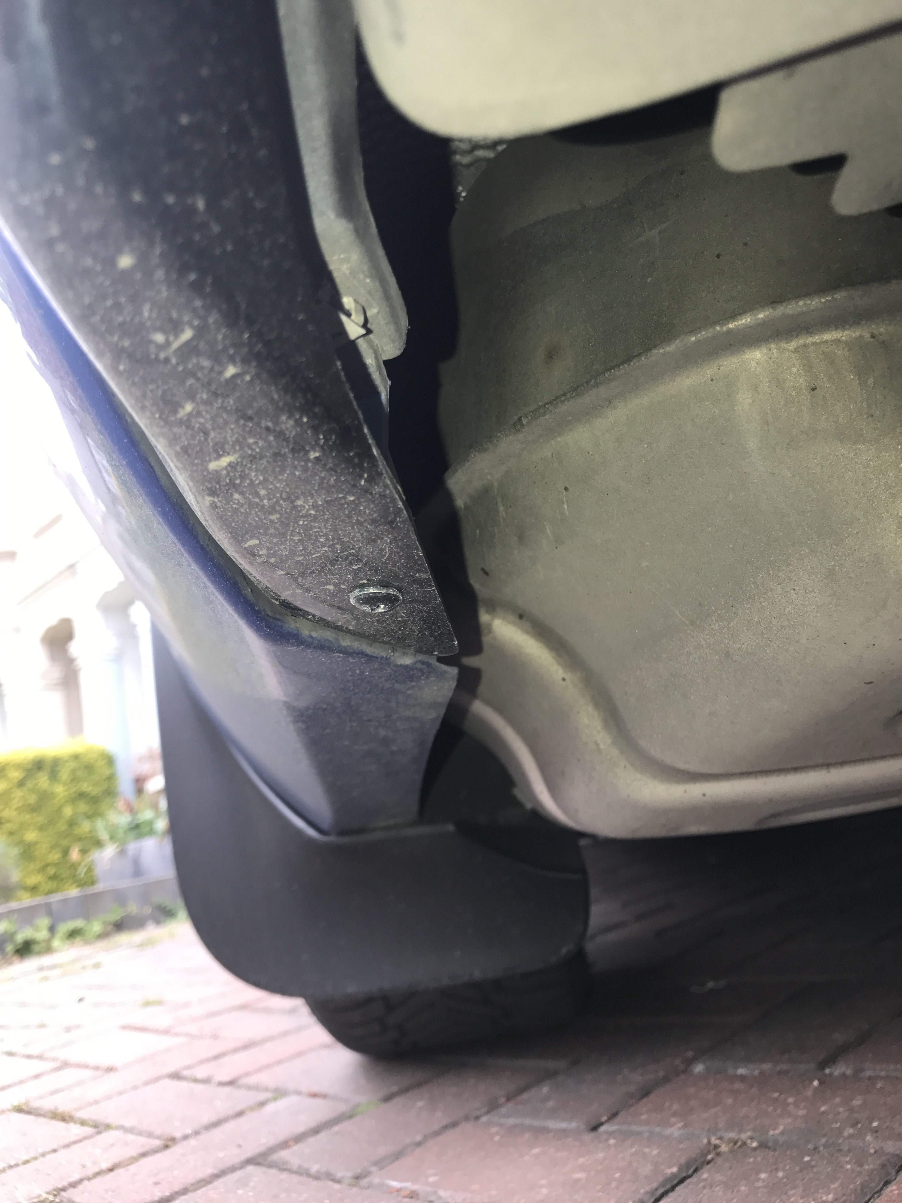

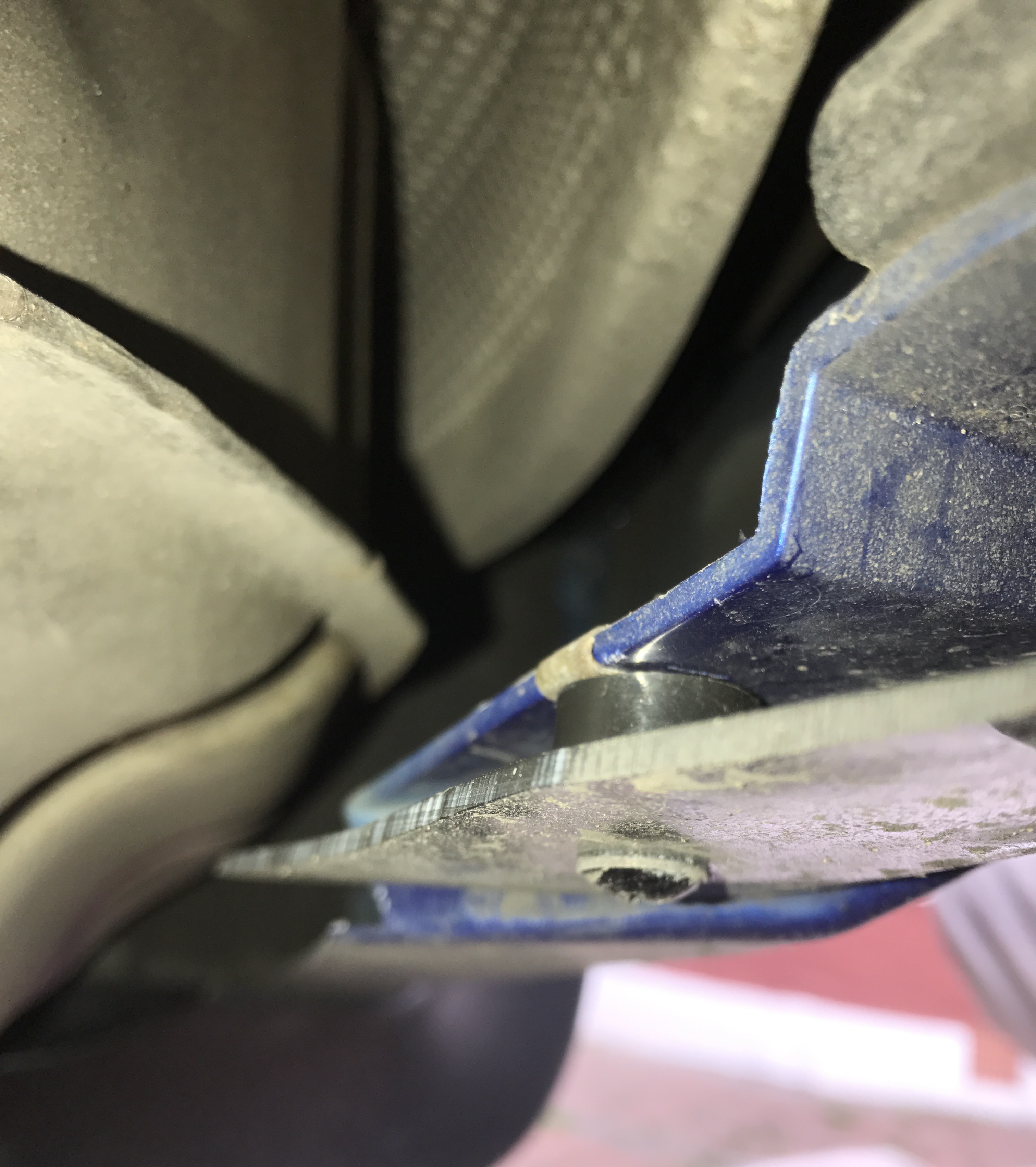

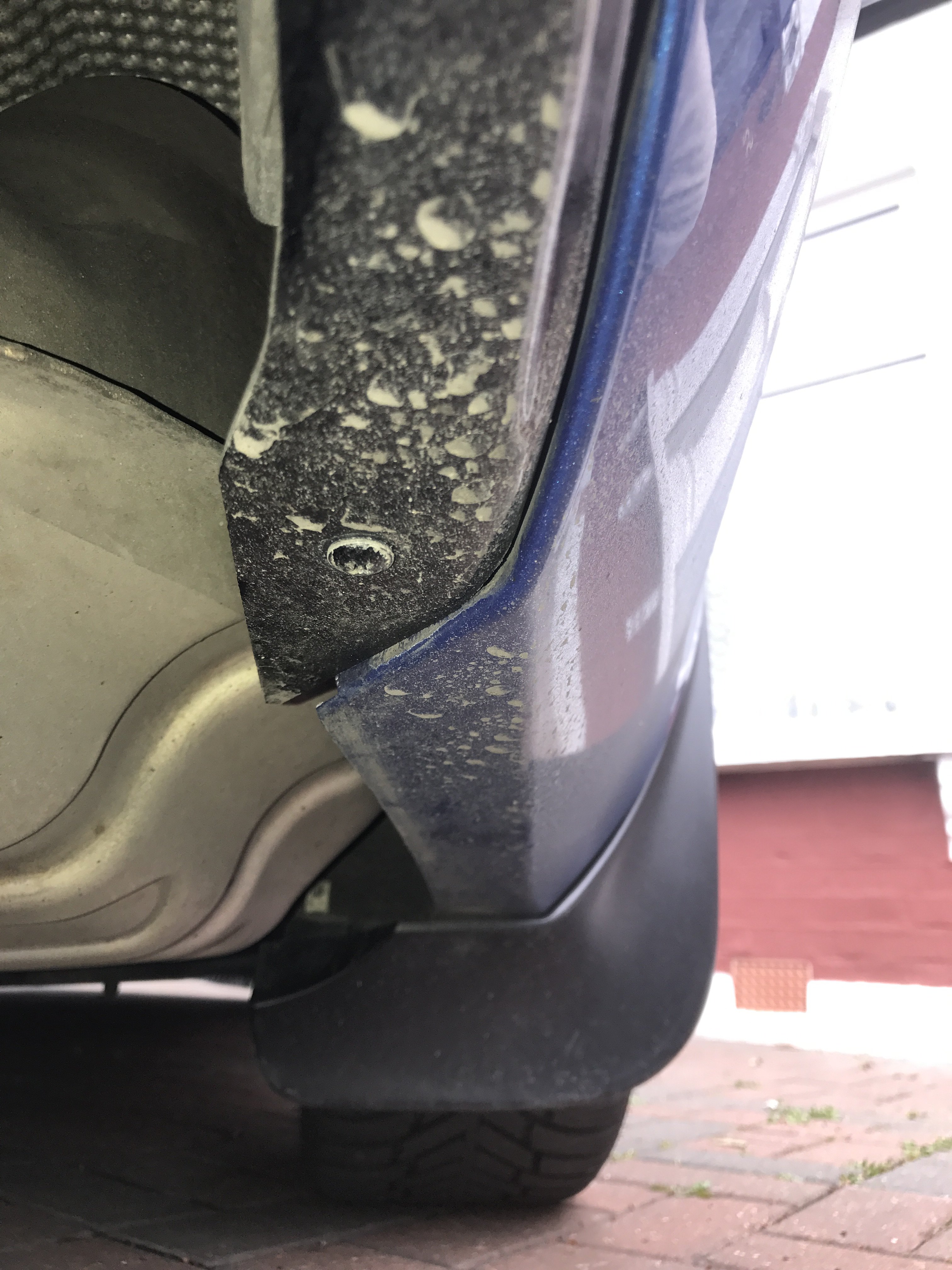

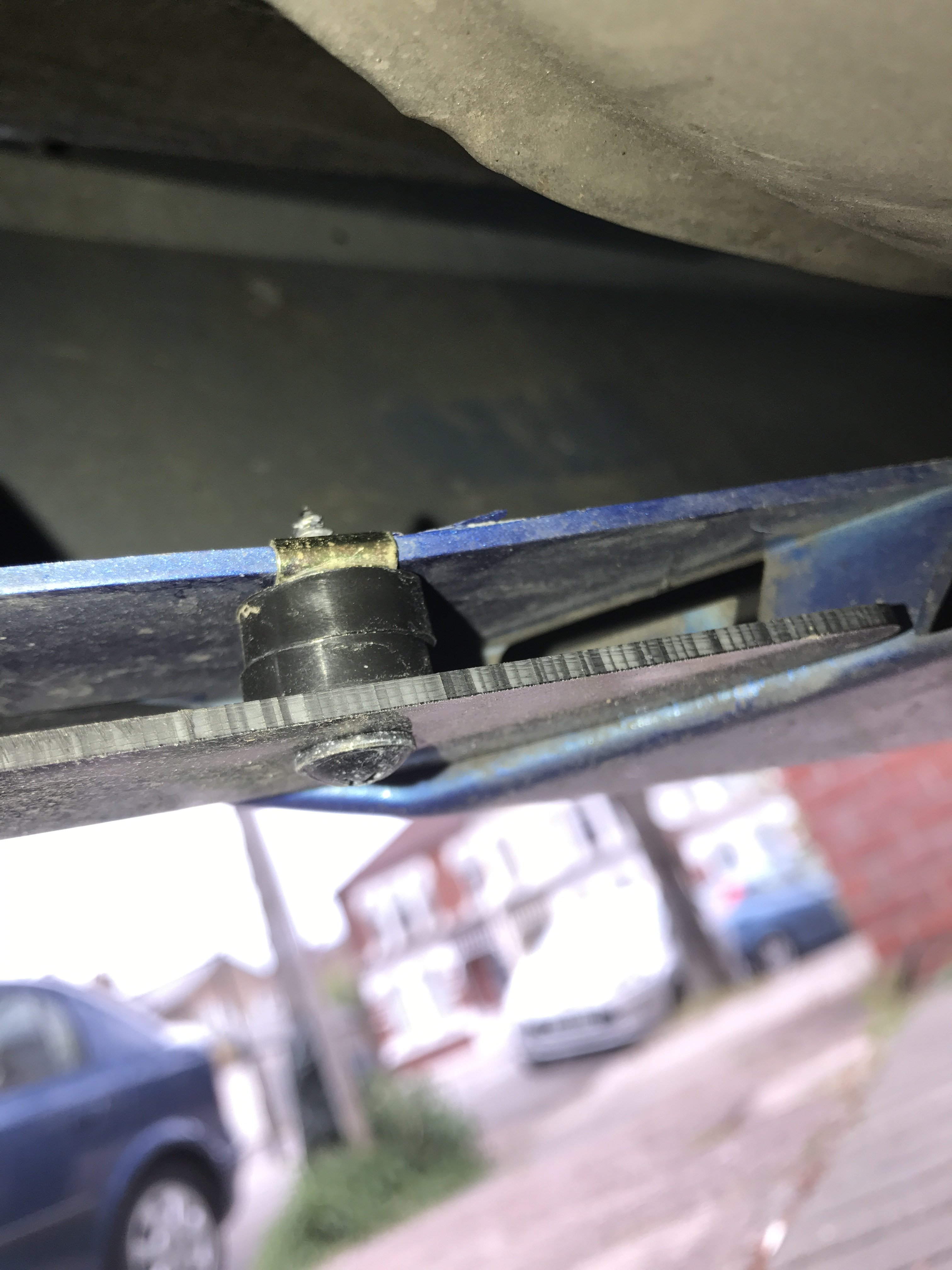

The speed fastener clips don't come with the rear diffuser, you will need to buy a few, 1 each side so a total of 2 but the garage mechanics should have these to hand in all honestly.
Here is the pictures & these are the only 2 holes that need drilling as it explains in the manual you get with the diffuser :thumbup:
Right Side
Left Side
Edited by BATVANVRS
