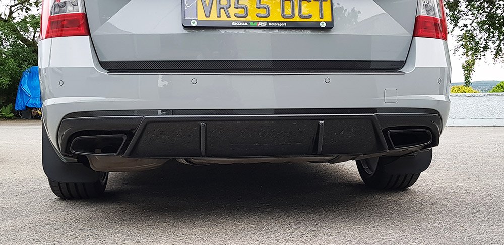

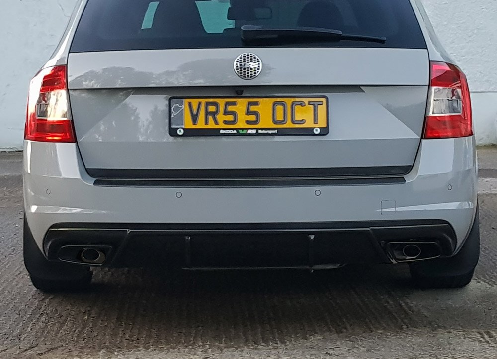

Just now, tunedude said:
Looks very good. You'd think it was an optional extra with it fitting in so well
where did you get that from?
Thanks, yeah I like that it's subtle enough to look like it could have been factory fitted :)
https://rover.ebay.com/rover/0/0/0?mpre=https%3A%2F%2Fwww.ebay.co.uk%2Fulk%2Fitm%2F352362581586
Same place that @BATVANVRS got his from and recommended. Came direct from Germany.
Just typical that the week after I got mine there have been 10% and 20% discount codes on eBay this past week!

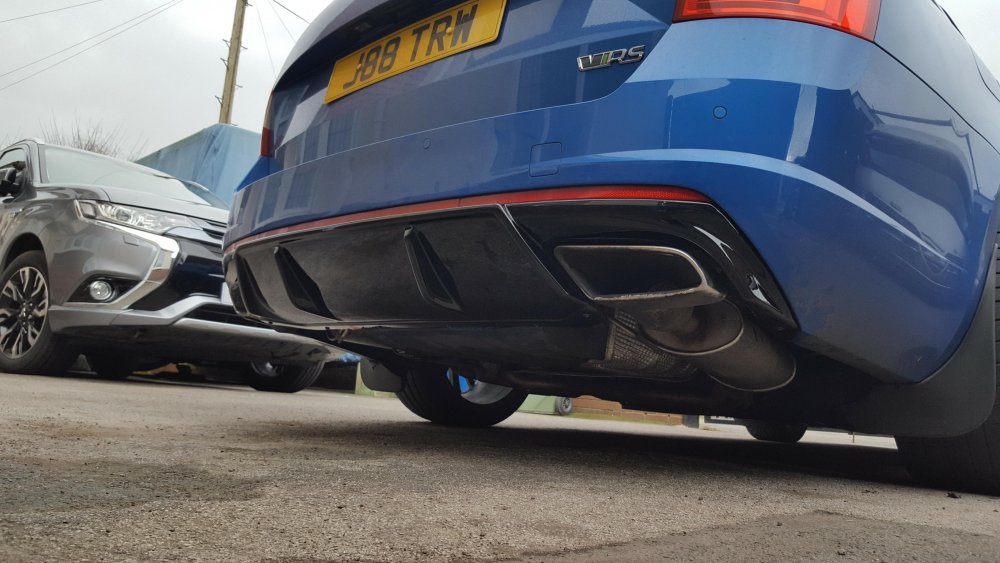

Anyone got a pic of a Reiger showing the extra tube for a tractor? I can't find a manual for how it is fitted, so struggling to visualise where it goes, and whether it can be seen when someone is following you.
Cheers
Cheers
it cant. but you can notice the lack of back box the image below has the extension welded as per Riegers instructions to prevent any damage to the diffuser.
ive done this now...
Edited by JohnnyType2
if you need instructions you need to chop off the right hand pipe as its oval and the rieger extension wont fit over it. You will need a 1mm cutting disc on a grinder and a mig to weld it on. A specialists should be able to do this for you cheaply, i did my own as i have the tools if you need a picture i have the old back box lying in the garage?
Thanks. That sounds like a pain. Saw several videos of changing the diffuser, none showed the bit about the pipe. I'll have to pay someone to do that. WIsh i'd known, would not have ordered it :(
take it to any exhaust fitter they will do it in minutes.
its actually a skoda design fault, when i took off the old OEM diffuser it was melted, the right hand pipe is not long enough and im guessing when you are idling/regen and the engine is hot the exhaust fumes are not exiting though the tip but up and behind it melting the plastic. The Rieger extension allows the exhaust fumes to exit out the tip
