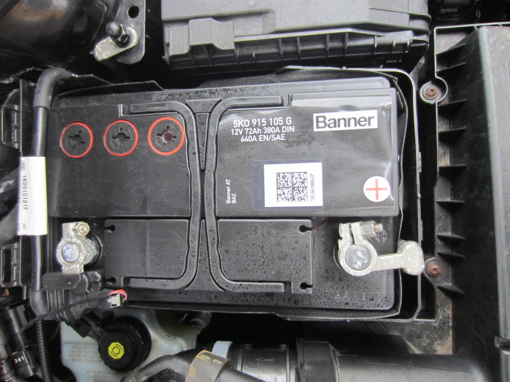

Swap current Banner lead acid battery for an AGM one. I'd kind of like Start-Stop to work during the summer time, but no rush to replace a working battery.

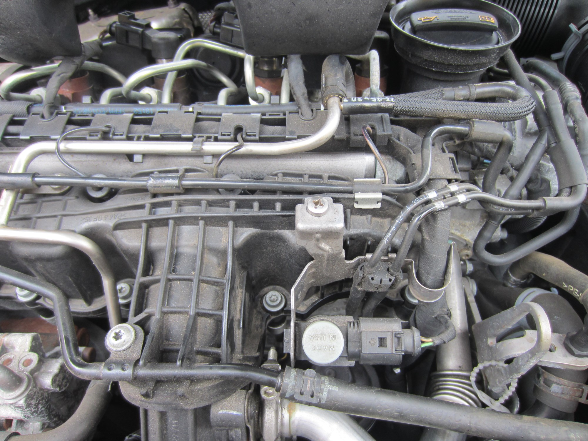

Find the correct Torx screw for a bracket above the oil filter cap. It's Phillips head instead of a Torx.

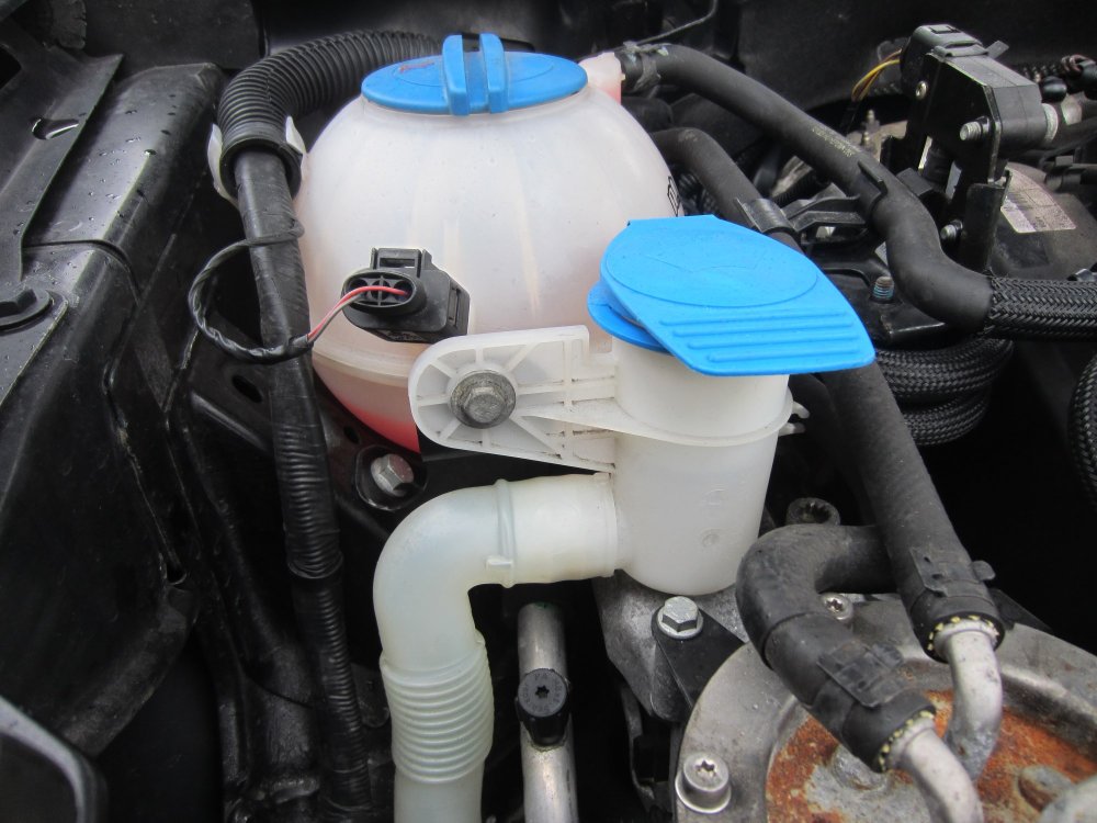

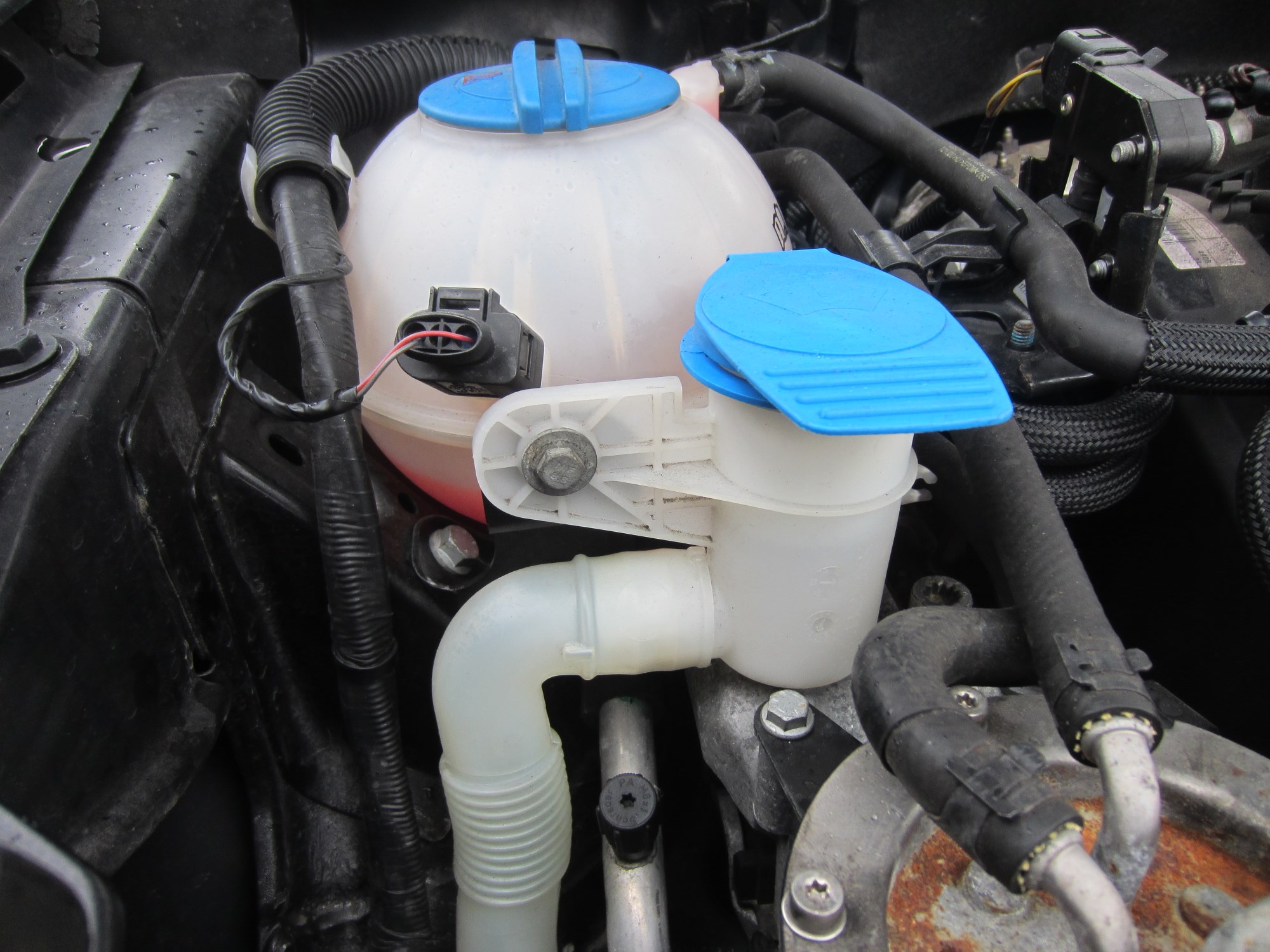

Top off coolant reservoir. It's on the minimum line, I'd rather have it between min-max or at max.

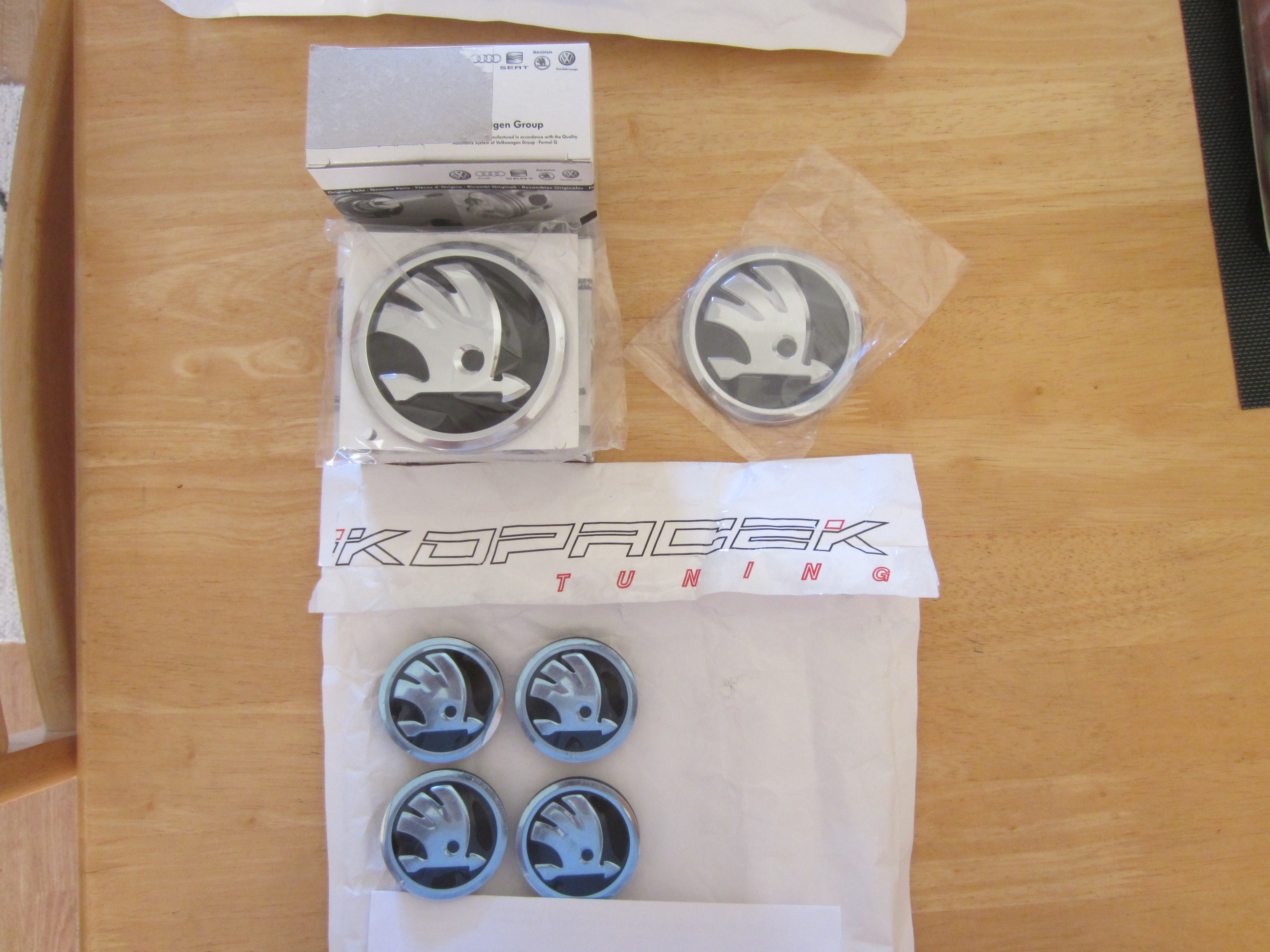

2X Superb II 09-13 - genuine Skoda Auto,a.s. emblem with new GLOSSY BLACK center from Superb III model
Center wheel caps with new 2012 logo - original Skoda Auto,a.s.
The badge on the left is from superskoda. The sticker where I presume the OEM part number should be has been cut off from both of the boxes. Must be some Czech trickery to avoid you from getting the part number to pick up some cheaper from a local dealer. I've heard they're sold at the dealer way cheaper (almost half the price) from the local Skoda club forum, but it would be a bother to go just to ask if they sell badges cheaper. Or it's just my wild imagination and they have a perfectly good reason for carefully cutting labels off boxes. Food for thought, I suppose.
The badge on the right is from AliExpress. They were about fifth the price superskoda is asking, so I ordered two, hoping they'll do the trick. Unlike the superskoda ones, they aren't flat (which I presume is what the Pre-FL S2 Superb needs), the black bit is matte and the chrome bit is nowhere as shiny as on the superskoda ones. What put me off from even trying them on the car was that the chrome bits weren't machined very well, at least on one of the badges. The other one was okay. Not good enough to go on my car. They look pretty much the same from distance, so alright if your badges get nicked I suppose.
Got the center wheel caps from a local Skoda club member for €15. Unused, still have blue tape on them. Shame I couldn't find the OEM badges locally for a decent price.
Not in a rush to put the new badges on, because the car is really meant to have the old style badges. Suppose I could switch back if I wanted to, though the old badges have corroded a bit. Not very badly, but still. Also, the front badge adhesive pad is a bit loose. That's why I started thinking about new badges in the first place. After pressure washing I make sure to press on the badge and it seems to stick, but it flaps a bit every wash.

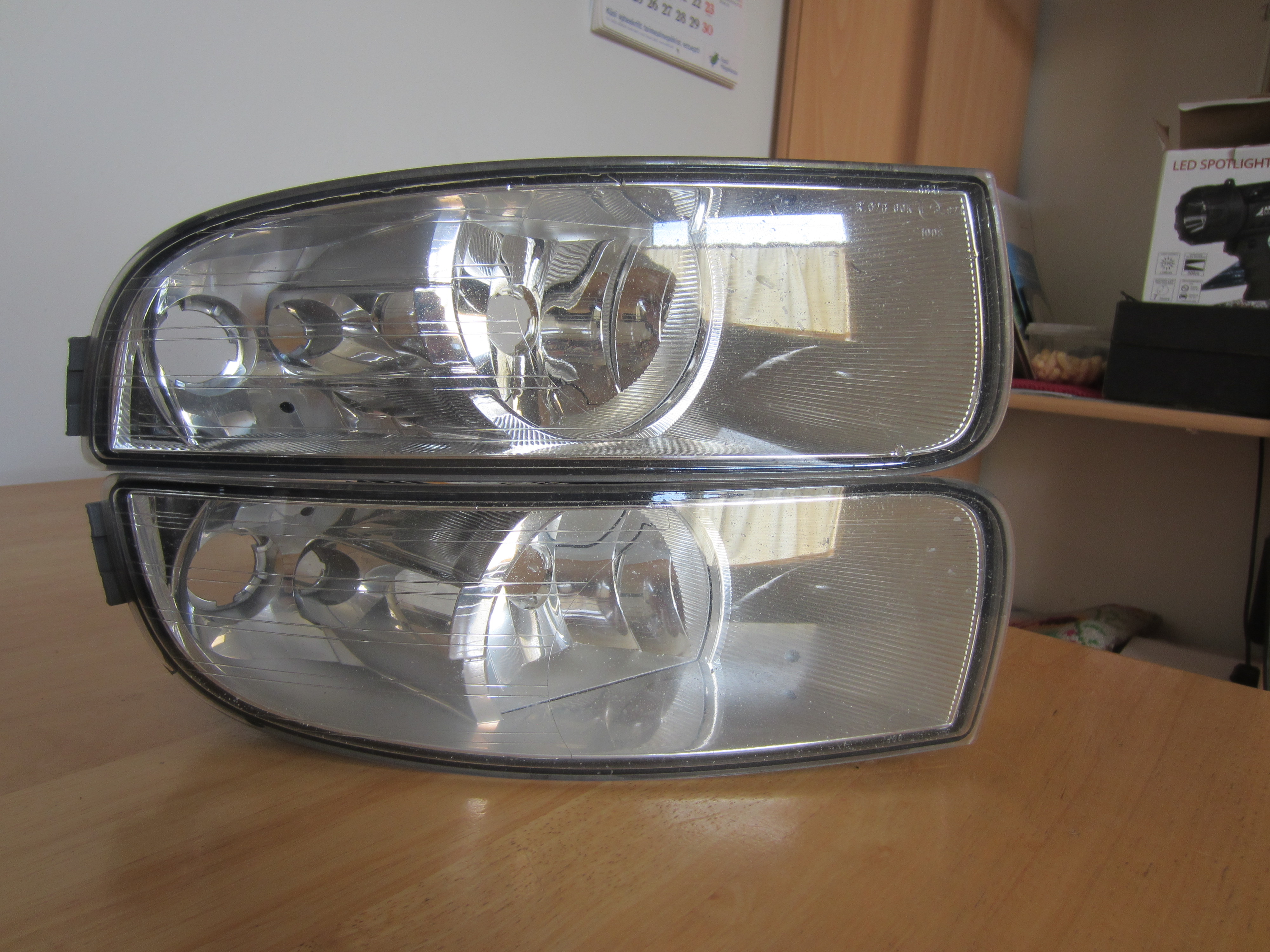

Besides the slightly corroded badges, the only thing bothering me about the looks of the car has been condensation in the foglights. Took them off the car, sprayed windshield washer fluid in the lights, a drop of dishwashing liquid for good measure and gave them a good shake after filling with warm water. Rinsed the bubbly stuff out and tested if they held water. Neither did. The breather tubes were both clear. One of the lights had its seal installed incorrectly. That's one of the places the light leaked. Didn't really bother checking the other light for the precise leaking points.
Rinsing and drying got the lenses quite clear, but the reflectors had a little burnt crud (grayish dust cooked by bulbs) on the bottom. Not very inclined to pour stronger cleaning agents into the lights to try to get that off. Getting some sort of a brush in there is difficult because of the shape of the lights. Suppose the proper way to clean the lights would be to take the lenses off, but I didn't have fitting sealant at hand, so that's not an option. Same with sealing the leaks. Gave the lights a good blowdrying in a cardboard box and put them back on the car. Some droplets appeared on the inside of one of the lenses. Turned the foglights on, hoping it would dry and vent the water out. The lens just got foggy again. Took both lights off, gave them both a second blowdrying and put them back on the car.
Would be nice if they won't turn foggy again at the first sight of rain, but I'm not really keeping my hopes up. They do have quite a bit of rockchips on them, so either it's a restoration in the future (lenses off, wash reflectors, sand, clearcoat and reseal the lenses) or just replace them with new lights.
The difference is quite noticeable.
