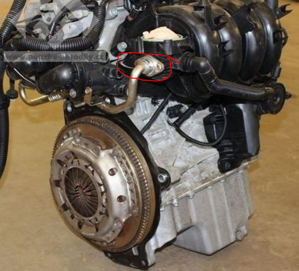

I have read about cleaning the EGR system on this website, but not sure where it is! Please could you point me to it on this picture of my engine? Also the purge valve mentioned

Purge valve ringed in green, EGR valve ringed in blue.  Note though that the metal pipe from the EGR valve to the inlet manifold (entering just beneath the throttle body) is the thing that needs cleaning, at the throttle body end, there's rarely anything worth cleaning off inside the EGR valve itself (cos it runs so hot it self-cleans).
Here's a guide to EGR cleaning on the AUB, a bit more complex than on yours as there's an intermediate plate between TB and manifold that doesn't exist on yours, I think.  Your EGR metal pipe will go straight into the inlet manifold horizontally on the battery side of the manifold.

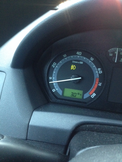

Will take a look in evening; but for me, those rpm sounds/feels totally perfect. And yes- feels like indications in dashb.not really match with reality.
Example from winter, when was fighting with EGR: coolant t* in dashb.goes quickly to 90*C- but scan tool shows only 60...70*C > and it rises very very slow when idling.
And final proof of it is that hot air in cab comes after longer period (despite in dashb.there's rocksteady "+90*C" quite quickly).

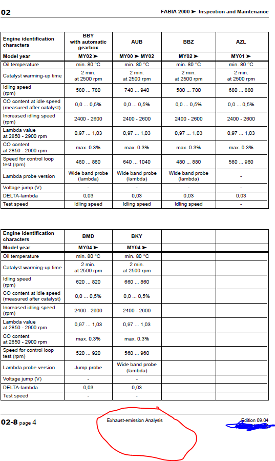

I wonder if the rpm numbers for BBY/BKY and BBZ in the table are the opposite way round to how they should be. That would make sense with respect to the AUA/AUB difference.
BTW, found that table too > for emission test, some rpm interval is given.
Here's mine warm idling = same view last 10 years (bit' bit' under 750min-1). At same time scanners shows ~690.
Coolant t* (as per scanner) was 75*- and it's after 1H driving in normal city traffic, when gauge on dashb.showed steady 90* :-)))

Your (scanner) rpm number suggests that your tachometer gauge is reading a little high, and that 680 really may be the specified value at full operating temperature, for your engine.
I did a log on Tuesday afternoon that gave a specified idle of 706rpm at 75C coolant temp (which happened after 10 minutes of driving). Once mine reaches 82C (11 minutes), the specified idle stops going down, staying at 678 for the rest of the journey, except for a time when I switched on the A/C, where it jumps up to 750 specified.
