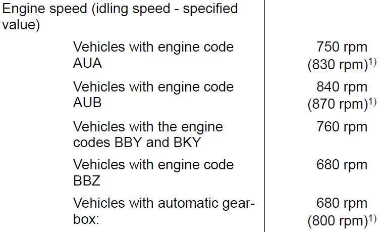

Here's the spec for the various combinations.  Note 1 = A/C switched on.

Wow... thanks guys, very helpful posts just with opposite implications :D
Sepulchrave-i too suspected a vacuum leak would be the issue if indeed there was one, but my engine is indeed a BBZ so this table looks like it could be right. But just for general info, any suggestions where you would look for vacuum leaks? Somewhere between the throttle body and the intake manifold?
Wino-thanks for the table! Is it from a reliable source? If so it seems like i maybe don't have an issue after all
  • Sponsor
That's from an erWin document about Mk1 Fabias with those engine types.
I don't know of a more reliable source.
No problem with your idle speed.
Checking the brake servo vacuum pipe for cracking at all the pipe junctions is a very good idea anyway, if the car is new to you. :)

Yes, mines an AUB, hence 850 RPM, but 1100 still sounds too high when cold so I'd definitely check for an air leak between the brake servo and the manifold.

AUB higher tickover than AUA because of hotter cam/shifted-higher torque band of AUB??
Why is BBY/BKY versus BBZ the other way round? My BBY in the Polo idles at more like 680 than 760, so possibly the erWin data is wrong there?
Don't have the equivalent document with Polo at the top of it, but I guess I can see what VCDS says. Edit: found a log where at anything above 82C coolant temp, 678 is target idle rpm. Would it be different in Polo to Fabia? Can't think why right now?
