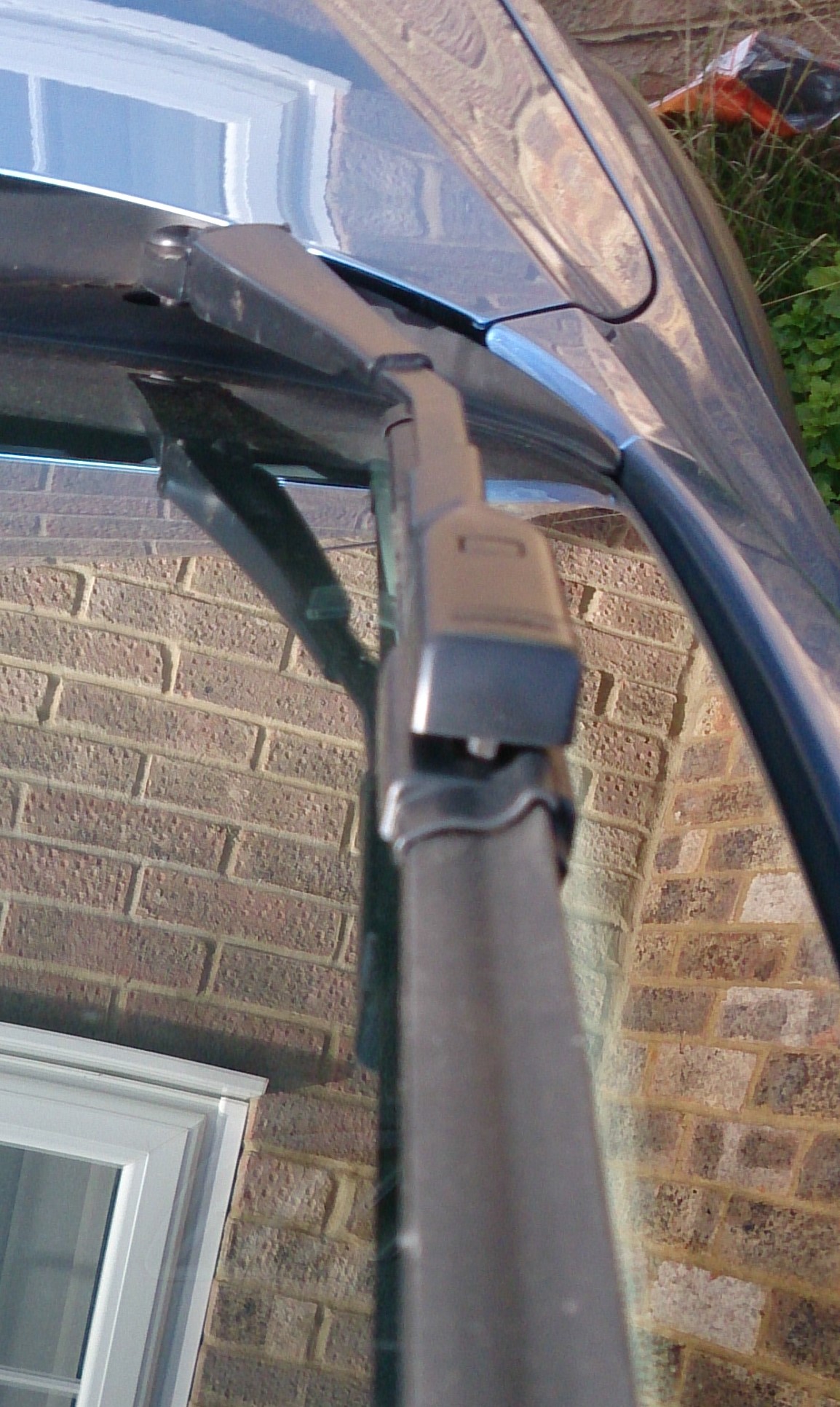

I've attached a picture of the old blade when it's in the maintenance position (not sure what it's called?) and although you may not be able to see it, it is scratching at this point.

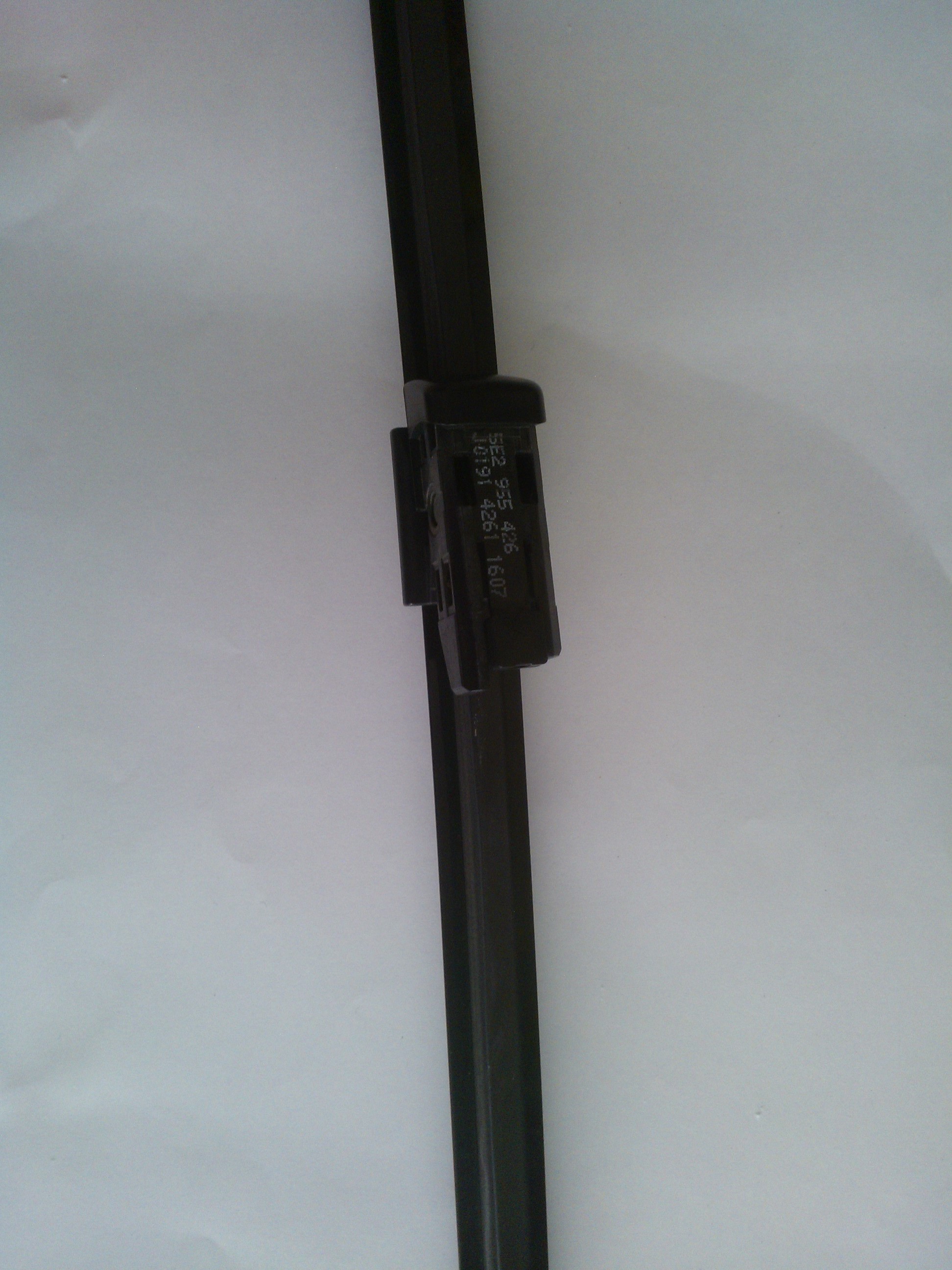

Picture of old blade off the car too - the serial number made me think it might be the original blade.

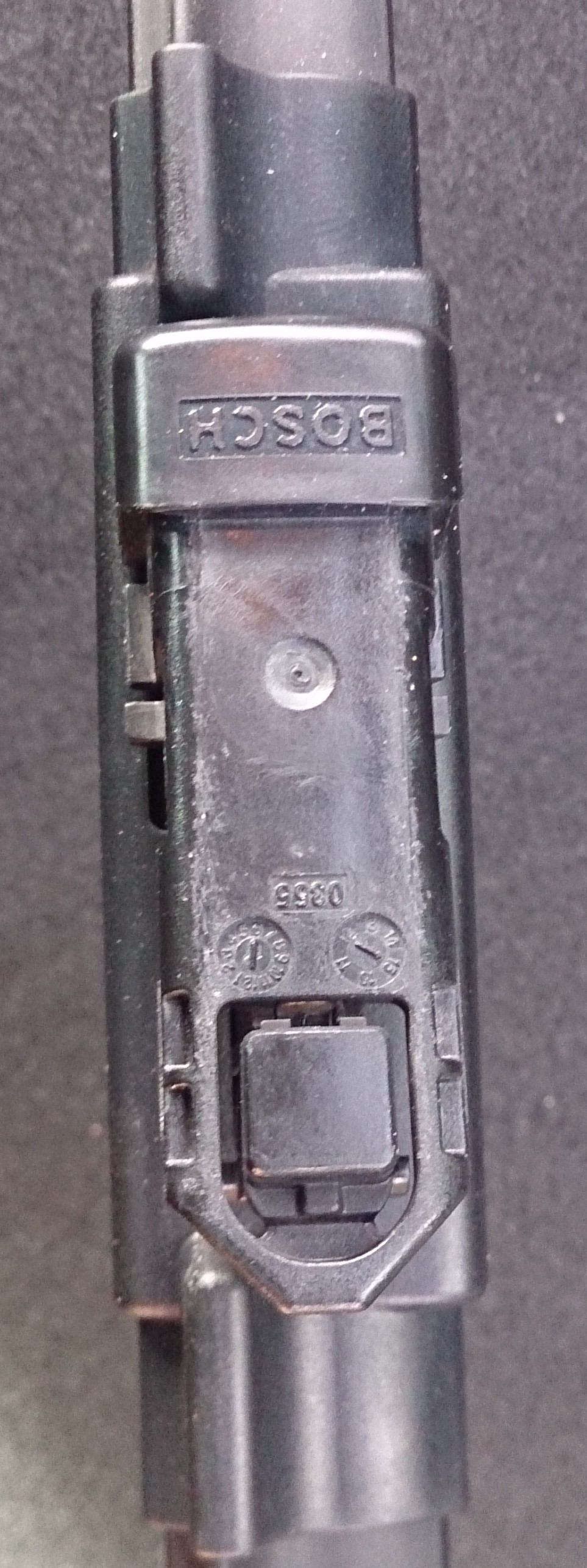

Look different to the fittings on the replacement Bosch aerotwins on mine (sorry for the reflections). Even if I apply pressure to the arms the bracket doesn't touch the screen.

When I compare with my photo I can see that blade in yours is more-or-less parallel with the windscreen pillar, but mine is at an angle where the top of the blade hits the paintwork.
I'm assuming we've both put the wipers in the maintenance position by holding down the wiper stalk after switching off ignition (?) so they should be the same. Also mine has more of a twist in the blade

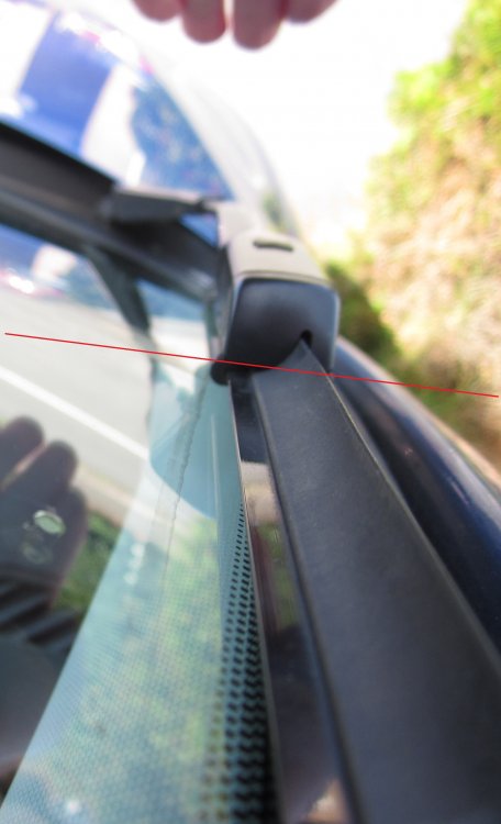

It's not a like-for-like comparison as the photos are from different angles, and my red lines are a bit approximate, but look at my attempt to show the blade angle on mine (first photo) compare to skaut's helpful photo.  Look at the bottom of the windscreen for comparison of the blade angles vs the windscreen edge.
