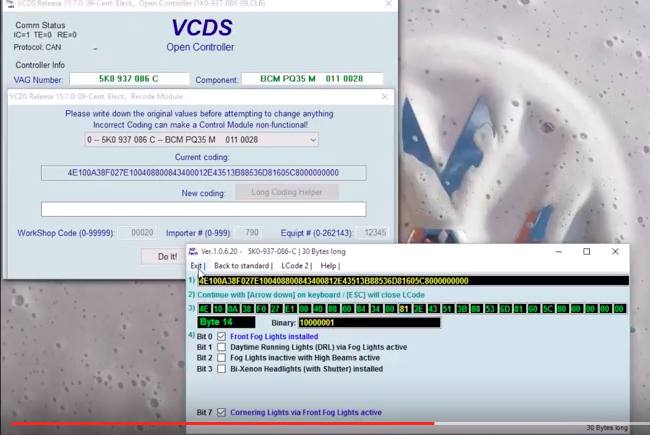

Does anyone know the VCDS channel/adaption I need to change to disable cornering lights?
I found something on Youtube but dubious about trying it..
EDIT: Apparently this coding works on a mk7 Golf so I might try this:
1. Go to the BCM (09- Cent Elect.)
2. Enter the magic number for access authority
3. Go to the adaptation channel (5)-Leuchte12NL LB45-Lichtfunktion B 12. The stored value should be Abbiegelicht links (in English-cornering Lights Left). Change this setting to not active
4. Go to the adaptation channel (5)-Leuchte13NL RB5-Lichtfunktion B 13. The stored value should be Abbiegelicht rechts (in English-cornering lights right). Change this setting to not active
