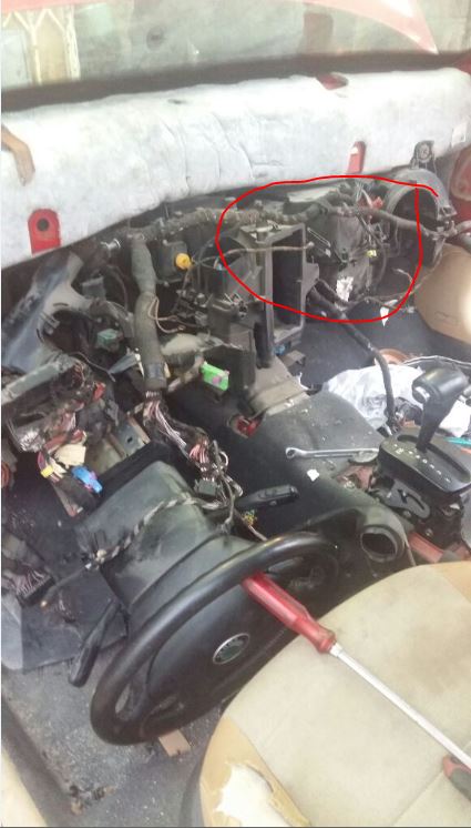

Thanks, yeah we found the evaporator is behind the golve box and found a leak in the evaporator and to remove it the whole dashboard had to be open. have another doubt does the evaporator model differ in a righthand drive and left hand drive car. experts please advice.

evaporator is behind the golve box see the image attached
