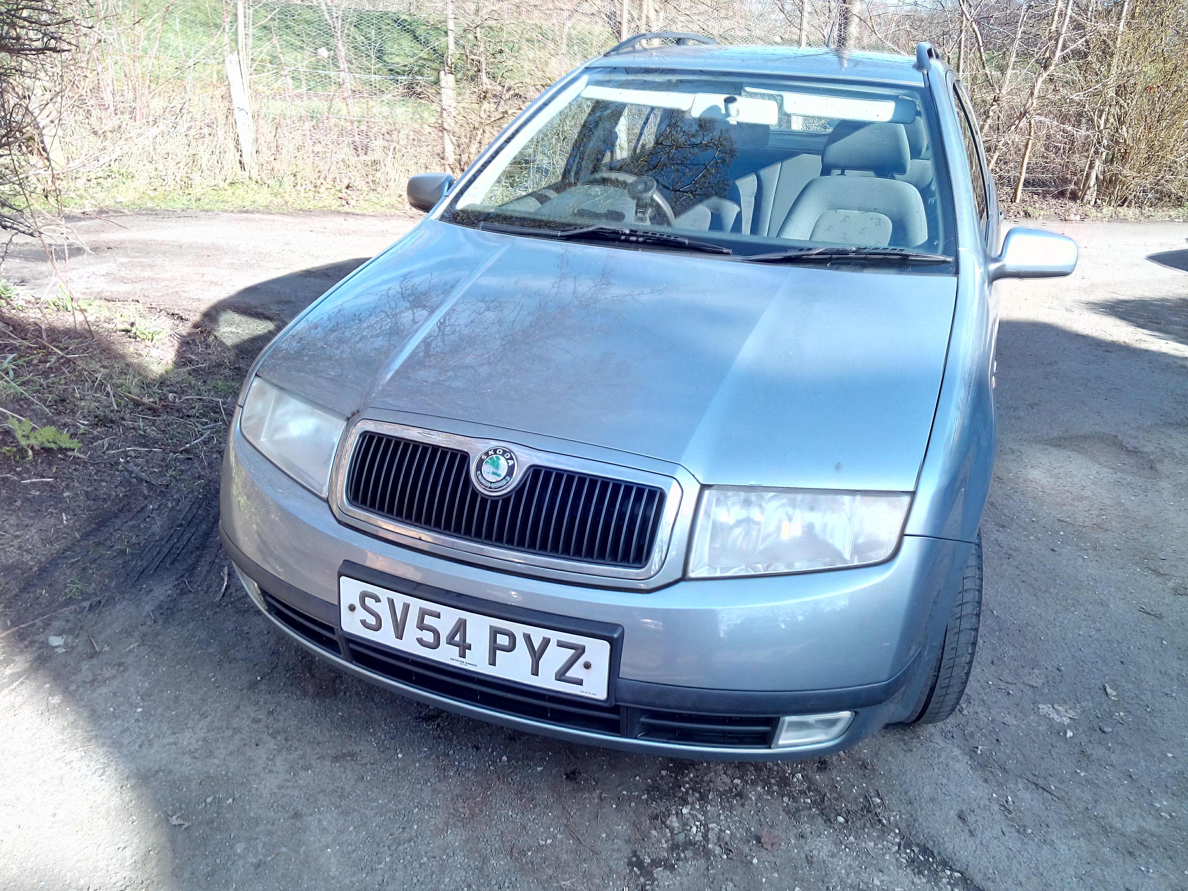

Long story short, I changed jobs mid Dec and took on a role that required a 200mile trip twice a week.
Enter stage left thisIMG_20170325_151629.thumb.jpg.0da65f405a7f9a77e6a33a748f81c0bb.jpg
A 100bhp TDI with 152k on it and MOT til Sept.
I like the Engine, and the heated seats, but there's a couple of things I'd like to get better!

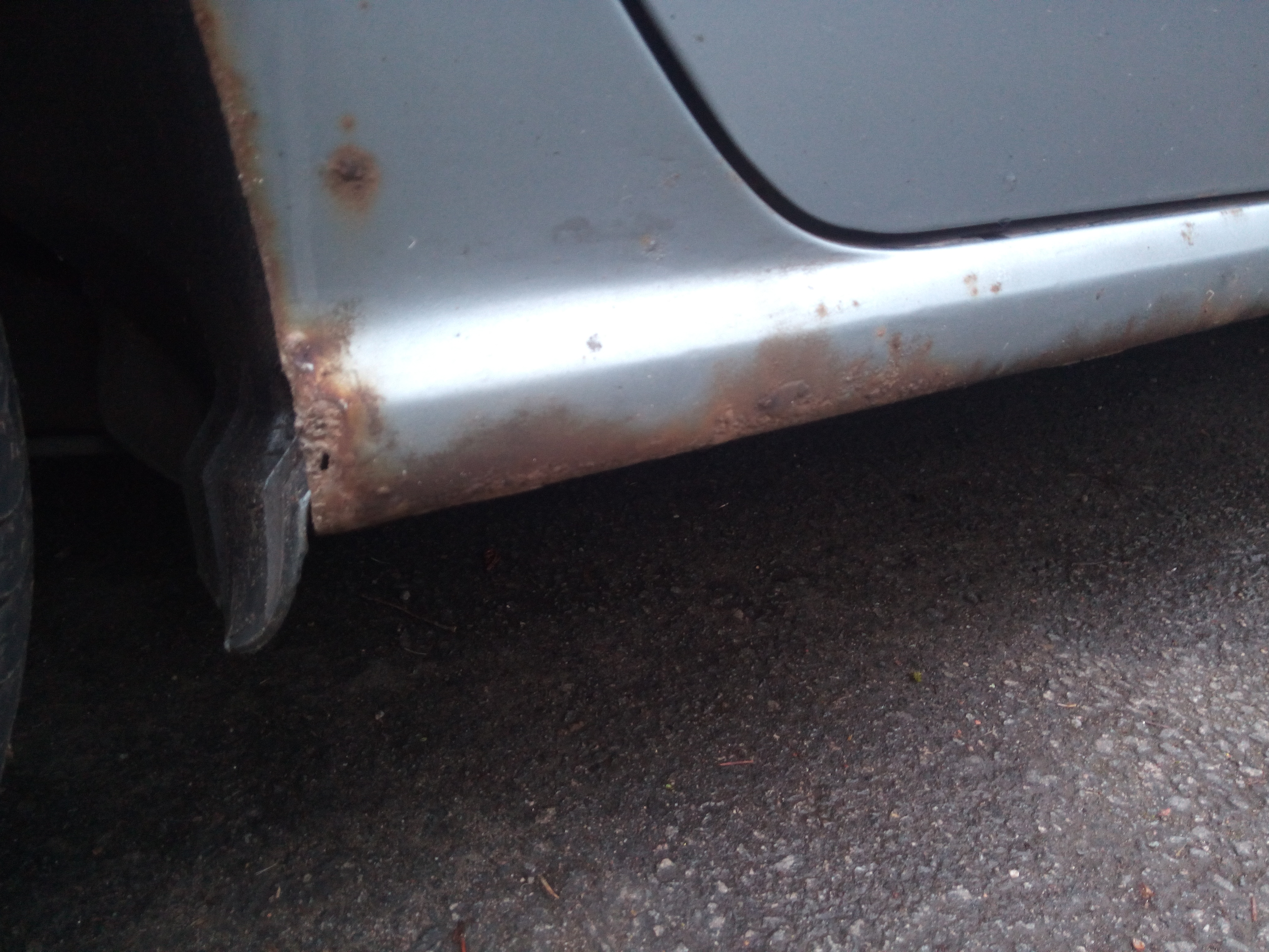

Secondly, she's very frilly about the sills/wheel arches-
I'm imagining the worst all round! Do they rot really heavily in the sills/wheel arches?
I kinda like it as a beater and it has done well for the last 4 months- but don't want to chuck cash at suspension if its gunna fail an MOT due to grot..

I dont think it would be ready to fail on rot yet my man,  even if it did I'm sure a couple o metal plates would sort it .  Give under the sill's a whack just to make sure.   And echoing the above,  new dampers all the way.
Yeah I may try to get her in the air tomorrow for a snoop about and prod..
