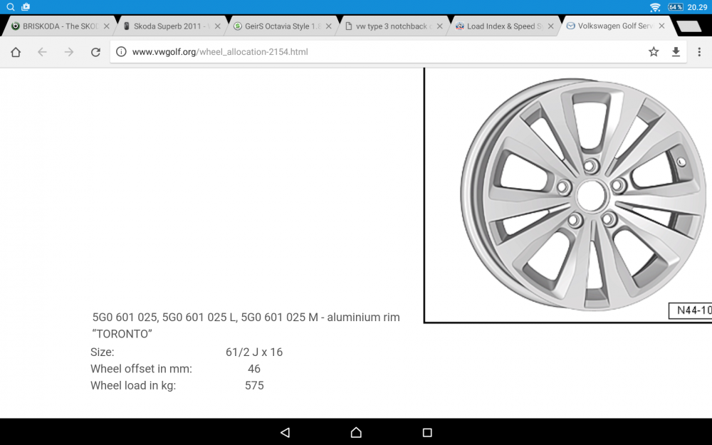

Thanks for that. The wheels I have in mind are the TORONTO wheels from the Mark VII Golf. They're commonly found for sale online at good prices, whereas OEM Skoda Superb wheels are scarce e.g. Spectrum.
The specs for the TORONTO are:
Offset ET46
Rim 6.5j x 16
Centre bore 57.1
Tyre 205x55x16
Speed Rating: V: max 149 mph
Load Index: 91
Rim Width: 6.5J
Should these be suitable for my Superb 1.8 TSI estate DSG in terms of speed rating, load index, etc?

It seems that there are different tyre load indexes for different versions of the Superb, as listed in the web site I refered to, but for 16" it is listed a higher index (strange really). I was pretty sure that the load index should match the maximum load of the actual car as given in the legislation. The load index of the tyres above (91) equals 615 kg. That gives a car weight of 2460 kg in total (1230 per axle).
And it seems that the Toronto rim is approved for 575 kg per wheel, which equals 1150 kg axle weight, 2300 total.
Another deviation is the rim width, Toronto is 6.5" wide, the listed width for Superb is 7.0". I would not call it a show-stopper, but still different.
The Toronto offset of 46 and centre bore of 57.1 is ok. The tyre size 205/55R16 and with a speed rating V is also ok.

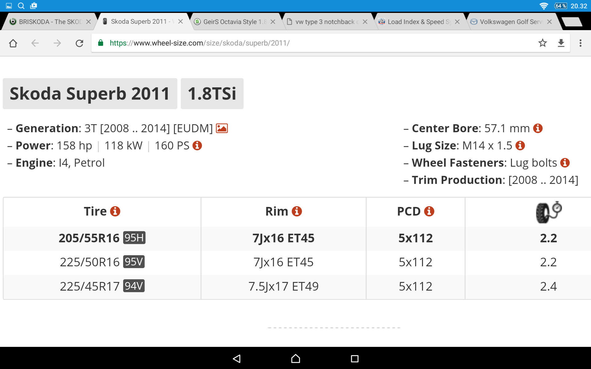

When I saw the screenshot from the website wheel-size.com, which lists 95H as the requirement for the 1.8 TSI with 205/55/R16 wheels, this is what confused me, because I have seen plenty of official and other Skoda information saying the OEM 16" Spectrum alloys for the Greenline and S models are 91H. This would be perfect, because all the wheel + tyre sets I have seen for sale on eBay include 91 load index tyres. I'm just still not comfortable that these will be fine for my 1.8 TSI, but I believe this petrol engine is quite small and hence lighter than the diesel engines.
