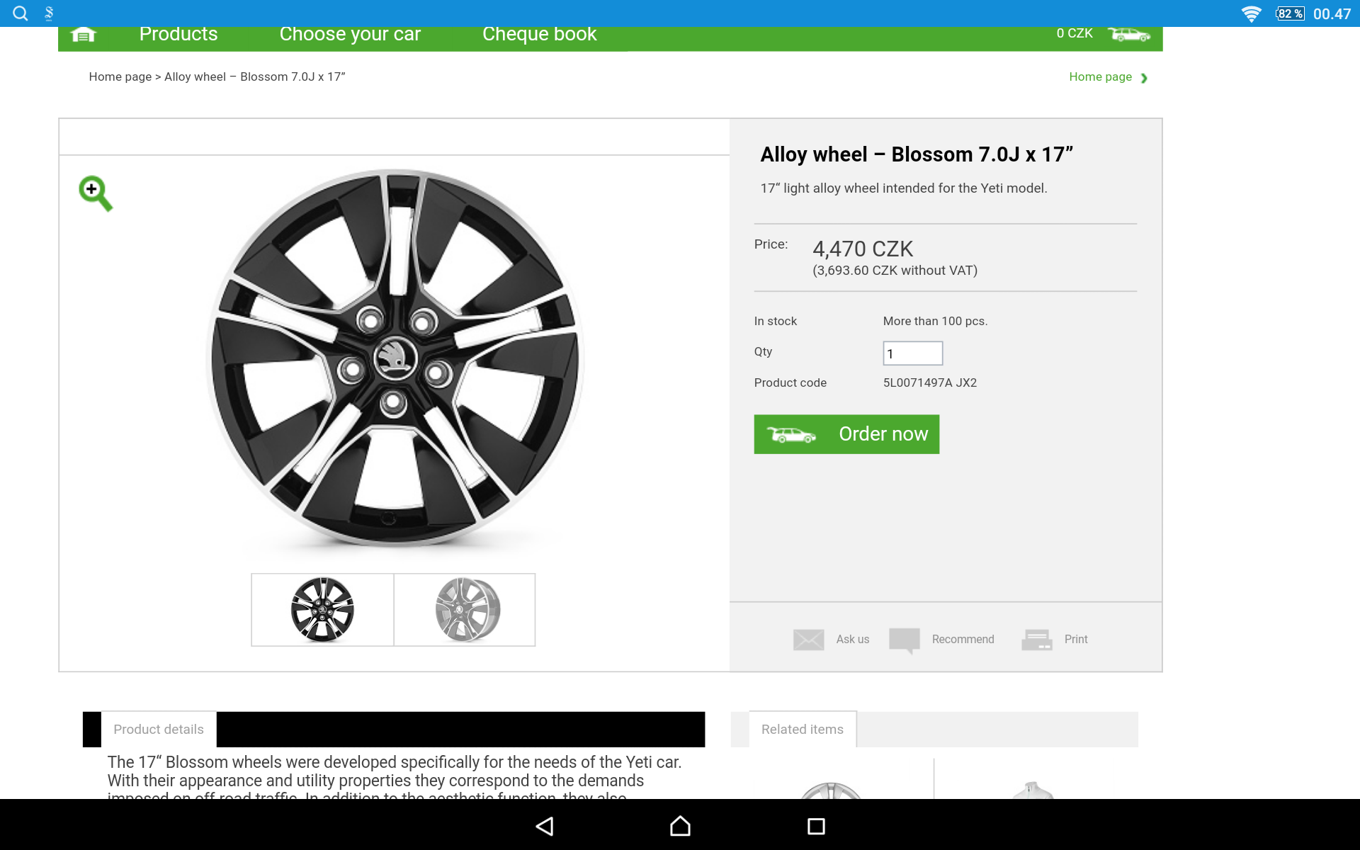

They are the wrong bolt pattern (5x100). You need 5x112 for the Superb.
However, if you look for Skoda Matterhorn rims they are very similar in appearance.
Hmm, we saw a Superb the other day with rims that looked very similar to Matterhorn, but they had a slight twist and not straight spokes
7" rim is suitable for 225/50/R17, and ET 46 will also be ok for Superb II.
Have you seen the Blossom alloys on a Superb?
