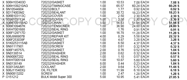

Need to update the signature. I now have an 11 plate MK2 FL 2.0TFSI. Breakdown attached.

Ok, now makes more sense.
The only two mildly expensive gaskets on there are the first two listed.
The first one is the oring gasket for the magnetic camshaft adjuster;
The second one listed is a gasket for the intake manifold.
The repair kit is for 4 injector seal kits.
It sounds like it had the tensioner and injector seals done.
Although, the text references timing chain and camshaft bearing. I didn't spot the camshaft bearing on my quick read down the parts list.
Doesn't seem that closely related to a head gasket on my First Reflection (if that is your current problem).
