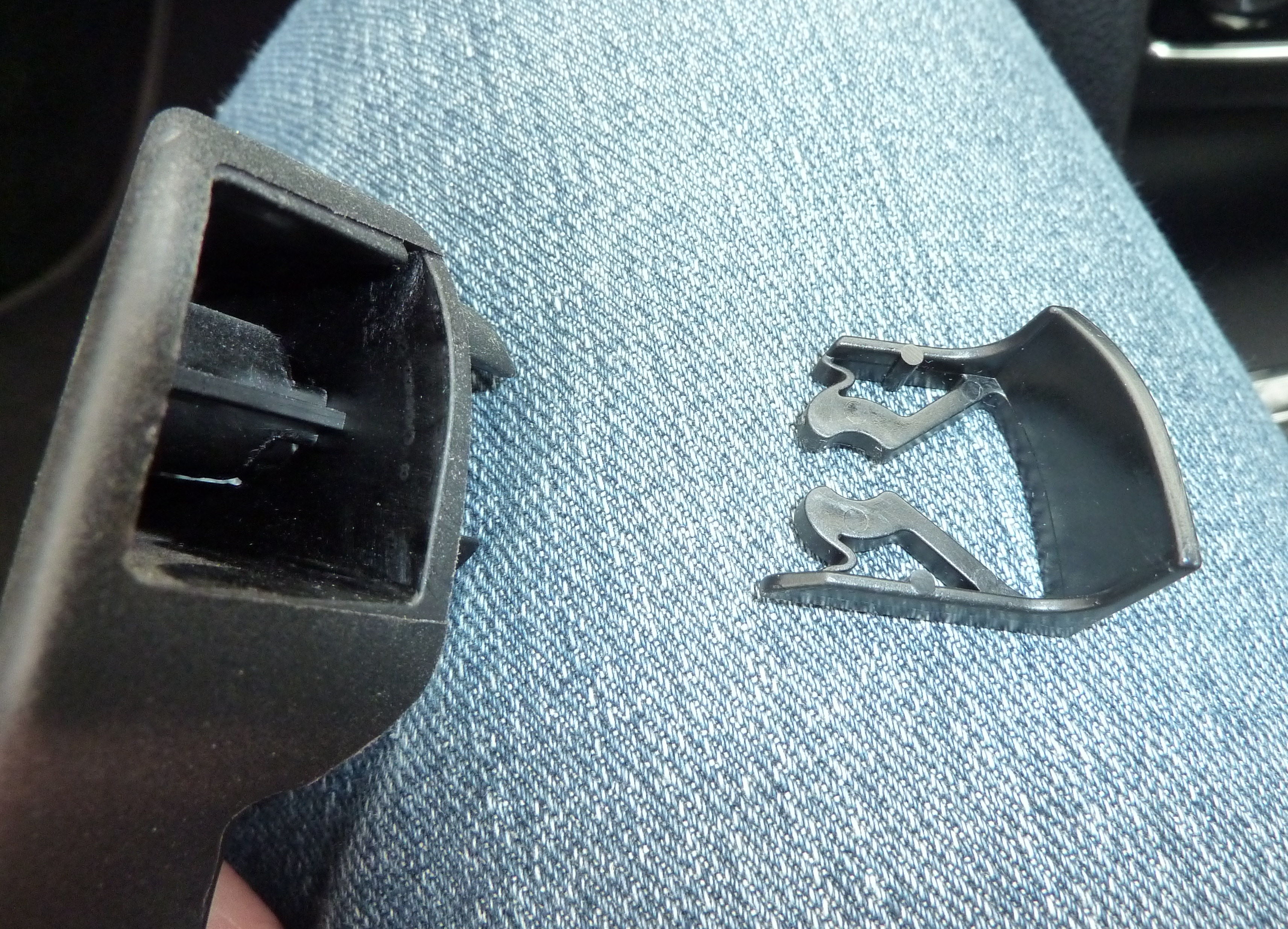

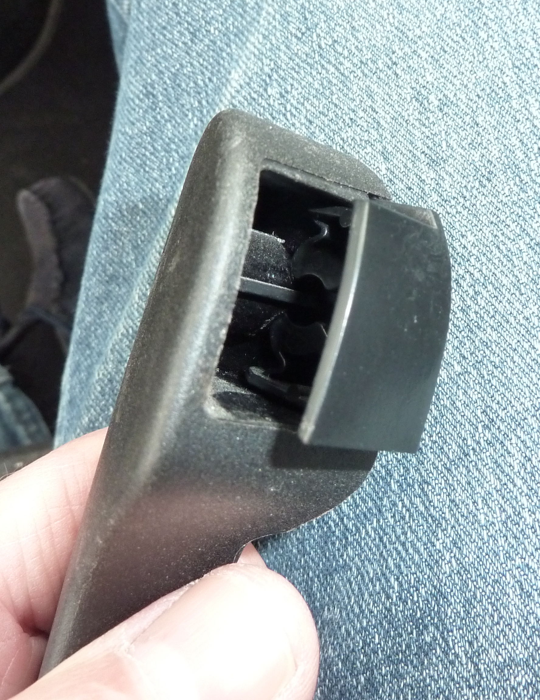

The bonnet release lever looks like this when removed:-
So you need to get a screwdriver blade behind the clip and tease it out,  This is all on the far side of the handle. It doesn't need any force, if it does then you're levering the wrong part.
