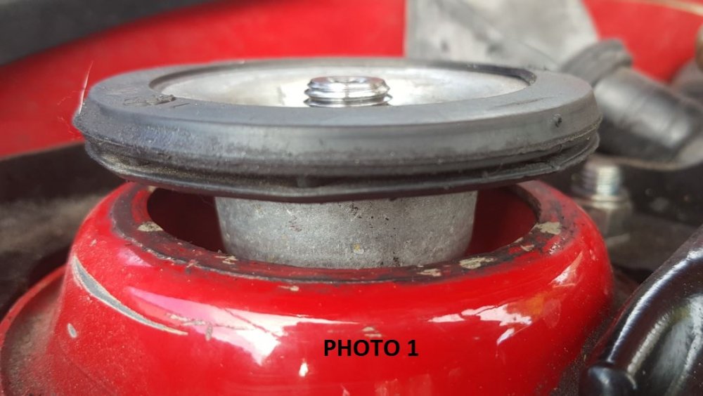

I've got coilovers in my estate at the moment, and I'm experience loud thuds as I'm travelling over pot holes. One of the things I've researched on is the gap between the front top mount cup and the chassis (Photo 1, which is the actual car).

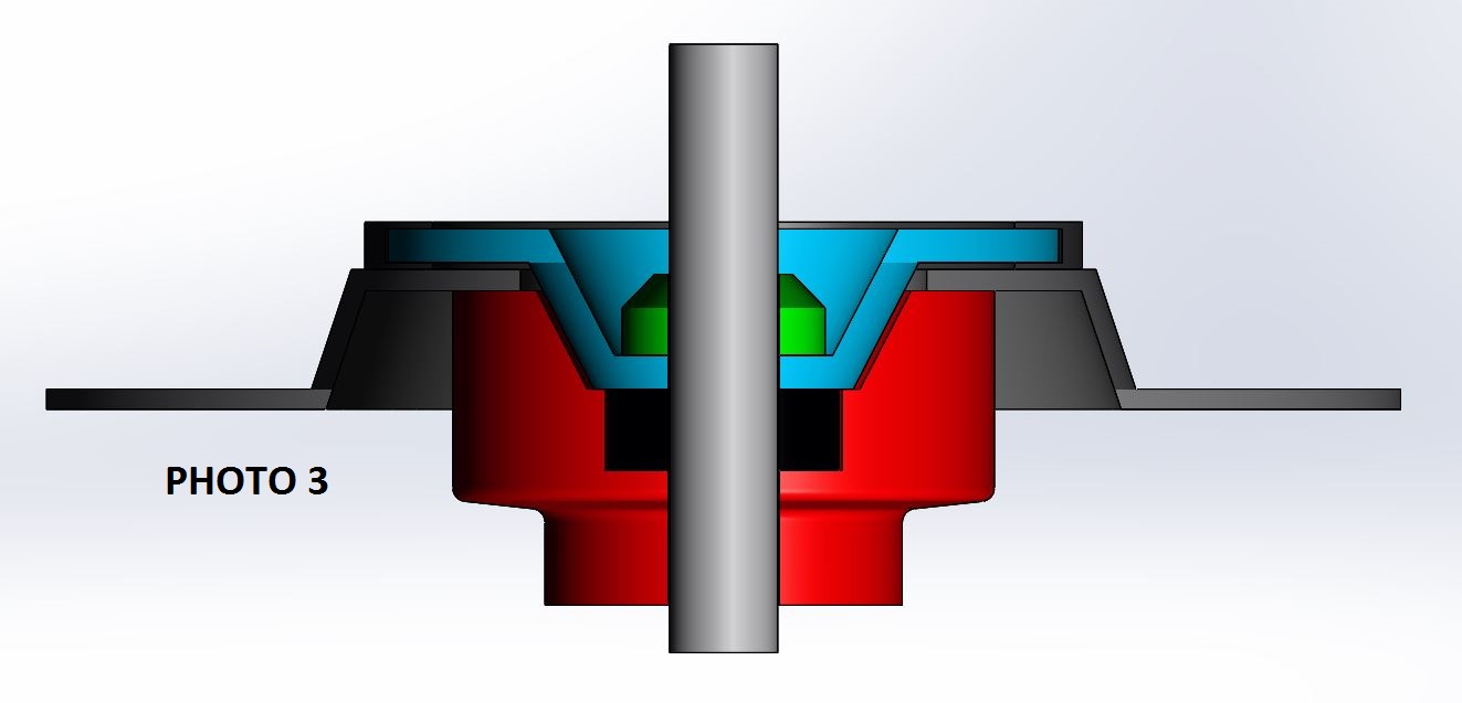

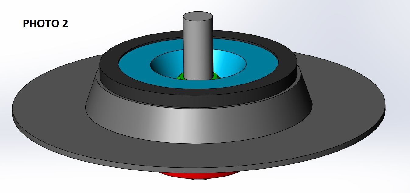

Photos 2 and 3 show what I *think* is what Bowder1's DIY ends up being, where the modified Polo/Octavia cup (blue) is merged together touching the top mount bush (red) and the bottom nut (black). The top nut (green) secures the cup.

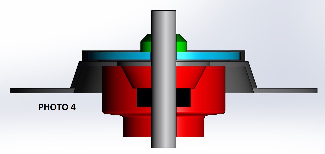

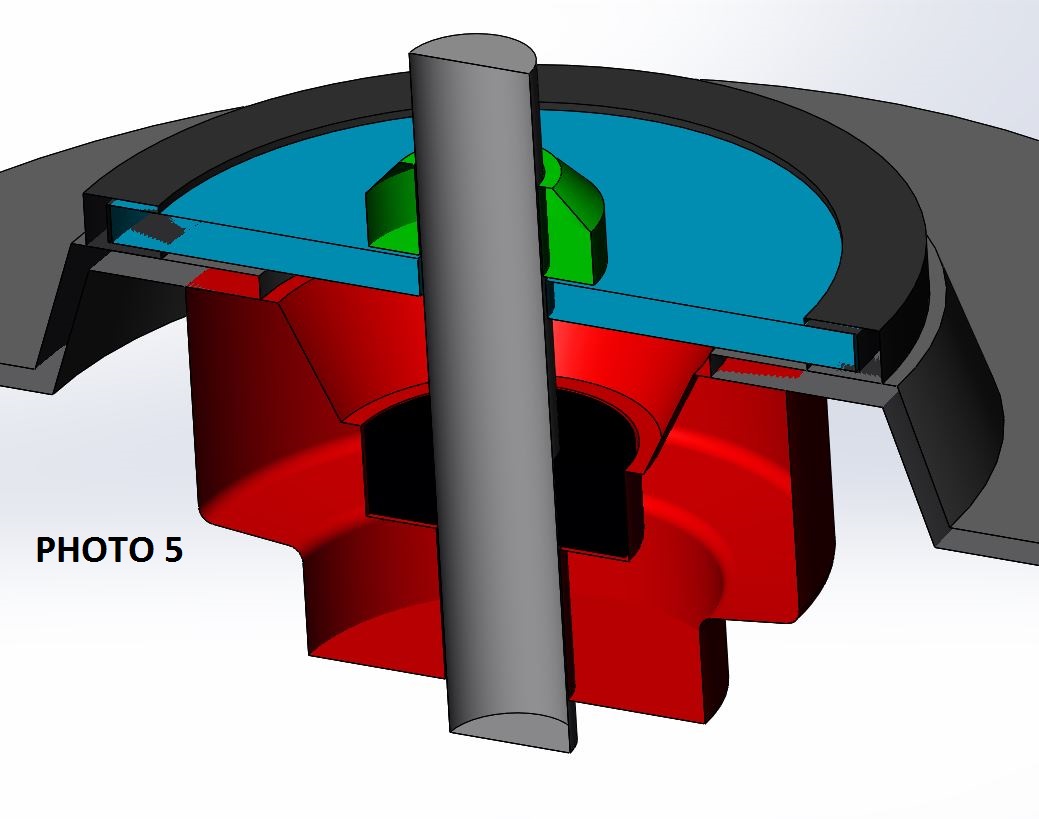

Photos 4 and 5 show what I plan to do. I know the diameter of the cup and the through I need for the threaded section. I can cut a piece of, let us say 6mm aluminium plate, to form the new 'cup' (blue), there is enough threaded section left for the top nut (green) to sit on top. The only down side i see from this is that the new cup/plate may flex when tightening down the top nut, and the fact that the chassis (grey) isn't parallel with the cup/plate. Would this be a problem if I tightened it down so that it is parallel and touching?

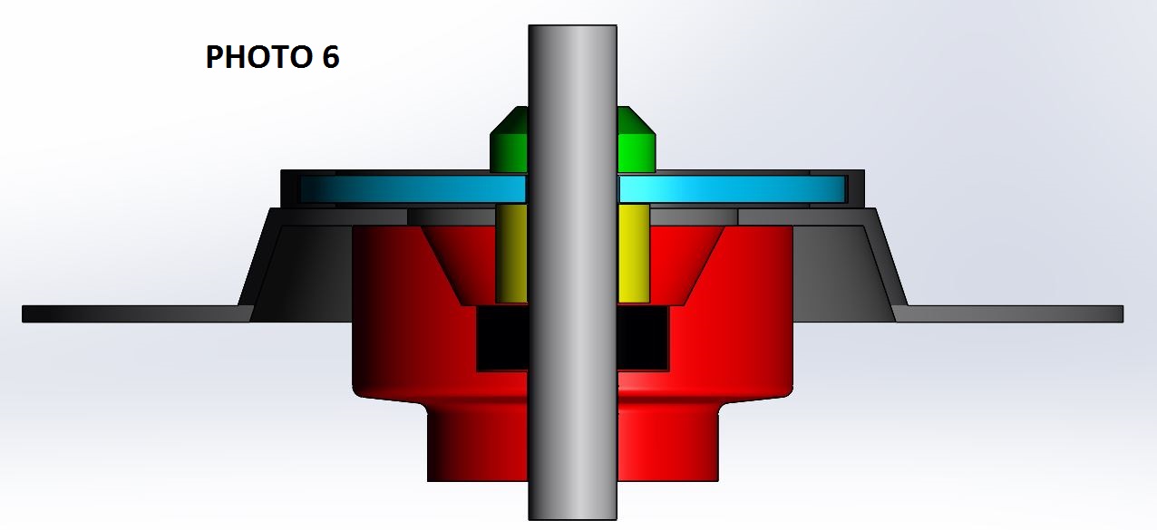

Photo 6 is an addition to 4 and 5 by adding a sleeve (yellow). I am able to make the sleeve separately or as one piece (joining yellow and blue) so that the cup is as close as I can get it to the chassis by machining using the CNC from bar stock.
