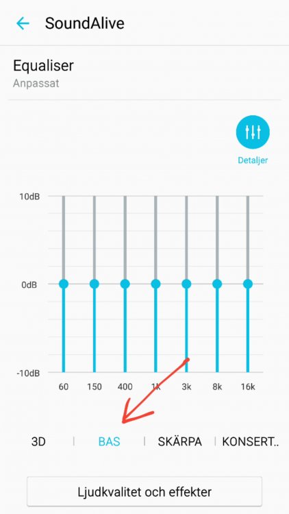

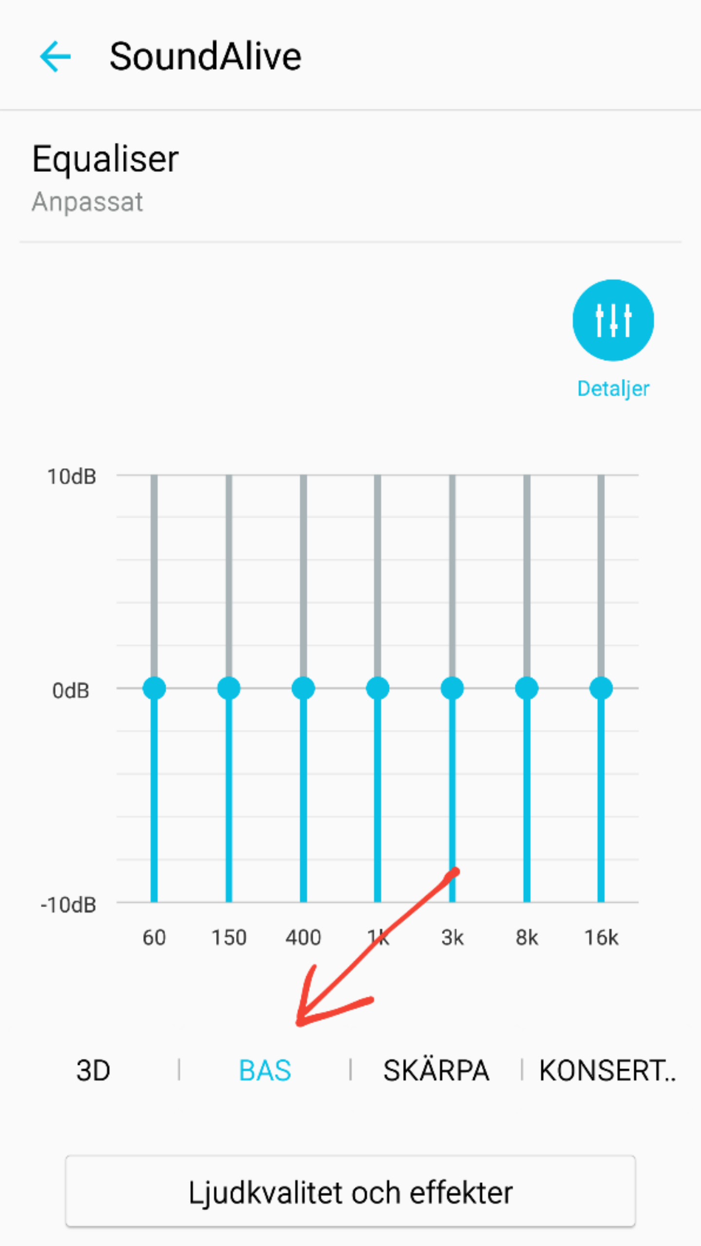

I don't have Canton however I only stream audio via Bluetooth and in my Samsung phone there is an extra bass setting which made a huge difference in the car!
Edited by Wiz83
