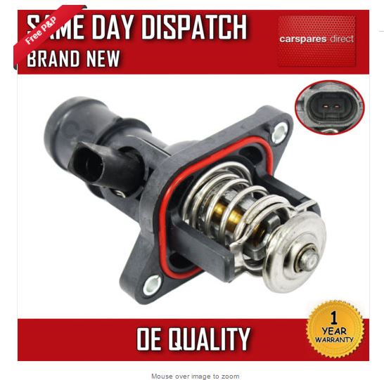

The thermostat was a pattern type from Ebay. If it is at fault it may be possible to get it replaced as it has a 1 year warranty. I assume it is the sensor or the connection that may have failed as the thermostat itself is mechanical (spring type).

Going back to the thermostat. If it is faulty, is it likely to be the electrical sensor? The car reaches 90 degrees when hot (needle pointing straight up on the gauge), heating and ventilation seems good. I cant imagine its the spring assembly, or am I wrong here?
These engines have a mapped thermostat as well as the conventional mechanical stat, which is essentially a mapped solenoid that allows the engine to warm up quicker. It is this part of the stat that has more than likely failed, as to be fair most pattern stats are built to a price, so something has to give, normally the electrical part of the component.

Not quite sure I fully understand your last post. Is the solenoid part of the housing that I showed in the image above, or is it housed somewhere else in the engine. The reason I ask is could I just change the electrical sensor?
It is built into the thermostat body that your photo shows, which is why it requires an electrical connection to the thermostat body, conventional stats do not have this as they are just a housing for the stat itself.
