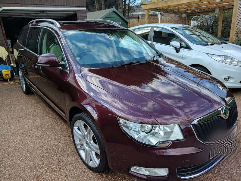

Your car looks in great condition from the photos but I know where you're coming from re the paint correction.

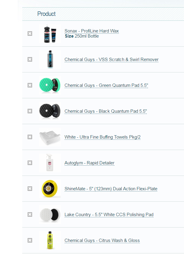

So I've done my research and I am going to go with my gut instinct and will purchase from CYC and I've already been in contact with them and they will allow me to collect and save the postage...Good considering their facility is but 5 miles from where I live.
I am going to get the following products from them. (see attached image)....Quite a lot there but I know given the initial outlay I'll have the tools to do the job for a good while to come.
Thanks for the tip on IPA....though I am going to skip this step as I've opted for CG  Citrus wash and gloss , as coupled with a good claying this should prep my body work for the polishing stage.
I do not want to go as aggressive as an orange pad on my first outing so have opted for a Green CG Hex Logic and followed by a Lake Country CSS White Pad...
If after this I decide I need to go more aggressive then I'll move to a Orange Pad + Compound then Polish but I should get a great result from using CG VSS followed by AutoGlym Super Resin to add some fillers to the deep scratches and mask them a bit..
