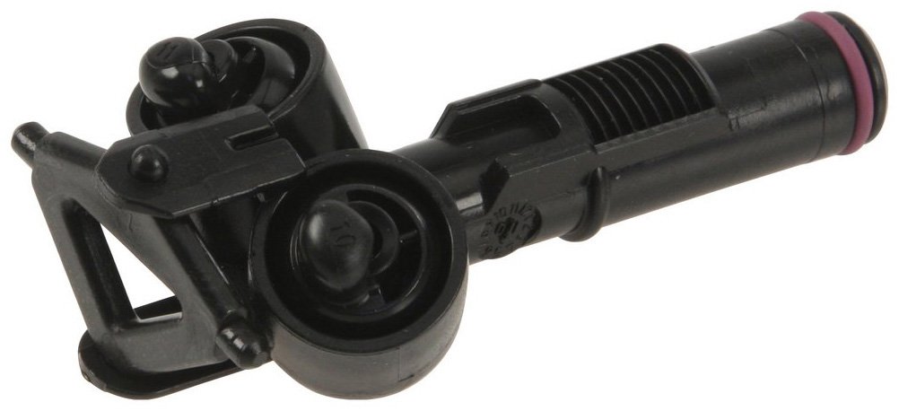

Does anyone know how to replace the Headlight Washer Jet Nozzle for the Skoda Superb II ? I mean this part
Some questions :
1. Do i have to remove the headlight assembly to work on this ?
2. How do you pull this part out from the existing setup. Is there a notch or something or a particular way to turn it?
3. How do you work on this assembly, it take a lot of effort to pull this out and keep it pulled out while working on this?
4. If i do remove this (assuming i find out how), how do i fit the new part as i will have nothing to hold on to, to pull out the telescopic arm.
Thanks folks
You have to pull out the arm and secure it using a cloth and vice grip, being very carefully not to damage the rod. Then you lift up the tab at the serrations and it will pull out. Be extremely carefully as to much movement will cause arm to retract. My heart was in my mouth when I was doing it.
It's an easy operation but be careful.
