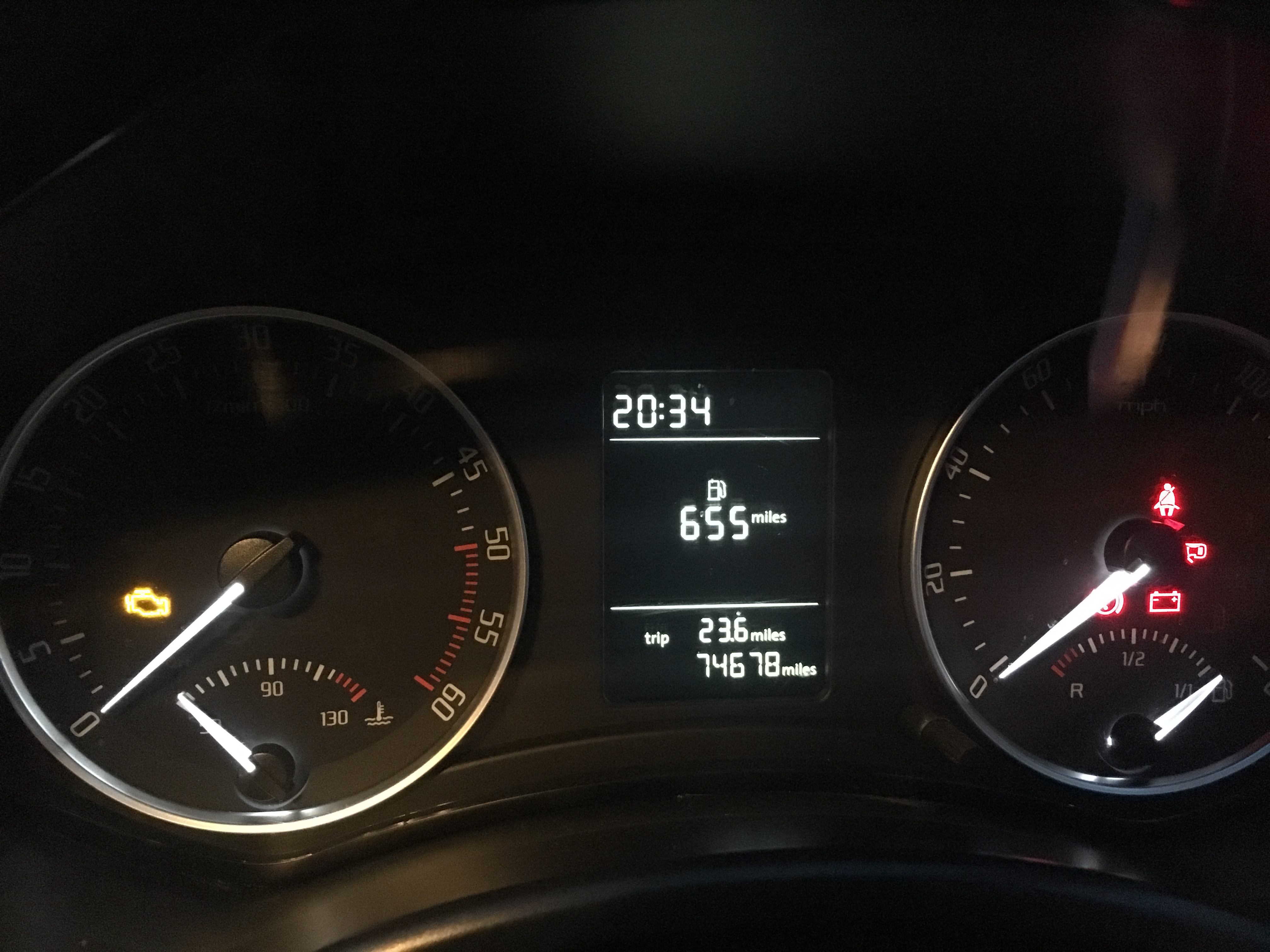

RE: the DIS I am still not sure as i have a Black Display with white text, but no images of car doors etc, please see attached photo of my cars cluster
many thanks !!
That is the non maxidot display then, this affects the functionality of the bluetooth module, and possibly whether you can use one, as it won't be able able to use the dash display for any functions.
