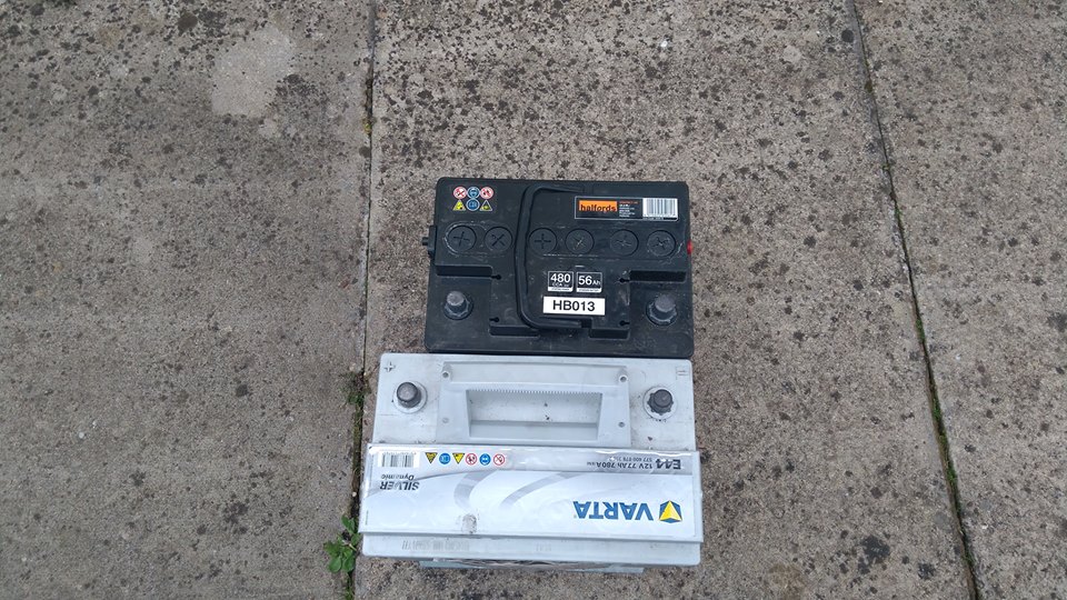

Battery is showing 12.4v on multi meter and I only put it in the car from my other Octavia (Varta E44) the other day as the smaller weaker battery that came in the car was only showing 12.2V.

The old battery removed vs the Varta E44 I replaced it with:
