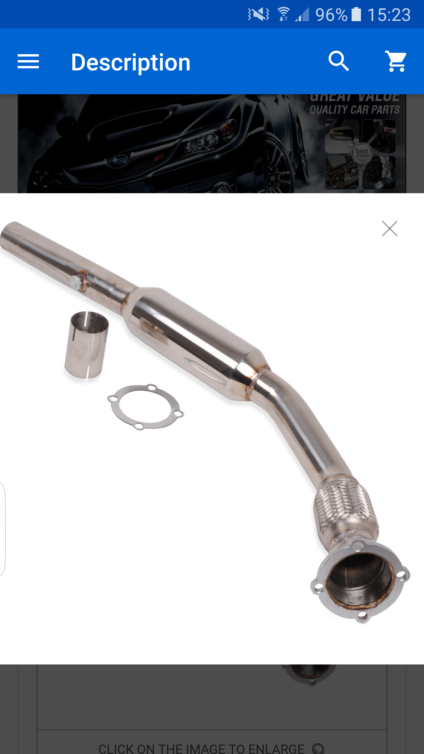

Has anyone put one off these on there car....thanks.
Fit one the other day ... Had to modify heat shield as it rubbed on pull off but fits perfect
Nice one Ramsellocty..Was yours 3" one or the 2.5" and did it have both sensor holes...

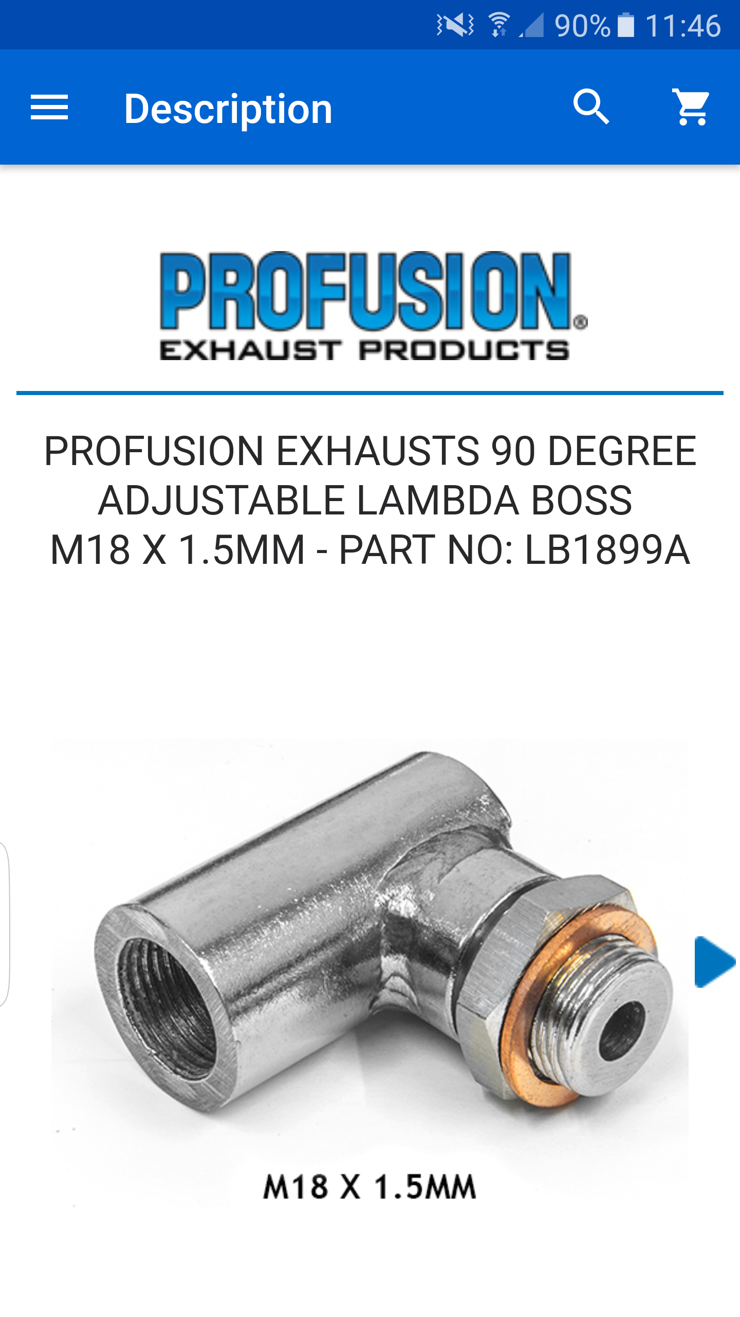

Mine is 2.5" ... yeah both the sensors either side I purchased a sensor adapter the L shaped one so not to rub as it sticks up under car on the back one
Thank you for your help.. i will order one this week..was this the angled adapter you bought..they say the adapter stops eml aswell...
Yes that's the one mate my light hasn't come on yet ... but you can have them remapped out so u dont need sensors ... but for now it's doing the trick

Cheers for the help..ive ordered one and a o2 sensor fooler..(hope it works)...being put on car on thursday....

I bought the sport cat version of this foolishly thinking I could bolt it straight on, but because it's a 2.5" and the exhaust is smaller I couldn't fit. I am know looking at replacing the rest of the system with 2.5". But this is looking expensive at the moment. I remember when you could get a full cat back stainless for £199 for most vehicles....gone are them days, and before anyone comments I am not that old yet.
I have that one, yes it catches the heat shield and I stupidly didn't mod the shield so it sometimes vibrates on it.
Ive had to buy a step down for the exhaust for 10 quid of ebay..and i also forgot to sort out heatsheild...hoping to fit stepdown on the next couple of days..

No but i can do..fitted stepdown today..it was abit of a pain in the arse but its done...i think i should have bought a stainless but i can't afford 400 quid for one...need to find a second hand one...
Hi there I fitted a 3" decat to my vrs and also fitted the sensor spacer makes a big difference I have done a lot of mods to mine if you need any advise let me know
