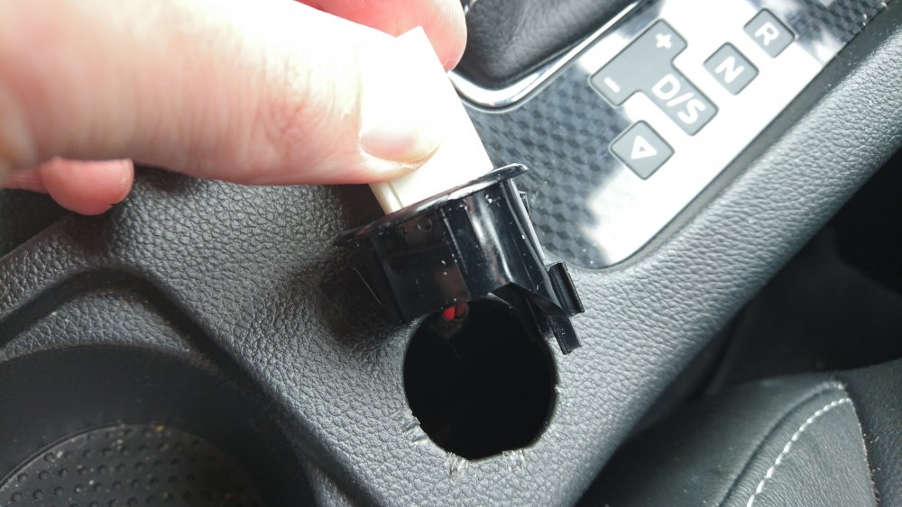

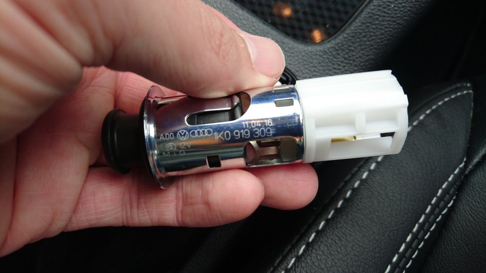

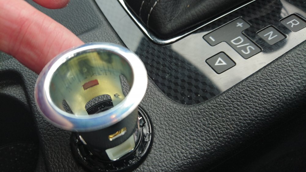

Thanks for above post - it gave me a clue. The tool release two tabs which I was able to do with a small screwdriver without the tool.
For anyone that is interested, the tabs need released to separate the inner metal barrel from the black plastic retainer clip. The tabs that need released are at the 3 and 9 o'clock positions  as shown by my finger in one of the pictures.
Part number is 1KO 919 309
The problem is now fixed

Hey I know this is an old thread but having difficulty getting mine out on a 2018 Mk III. The pictures you’ve posted are great but how did you release the tabs? I can see the small rectangular holes but don’t know if I’m pushing in or how hard etc. hope someone can help
