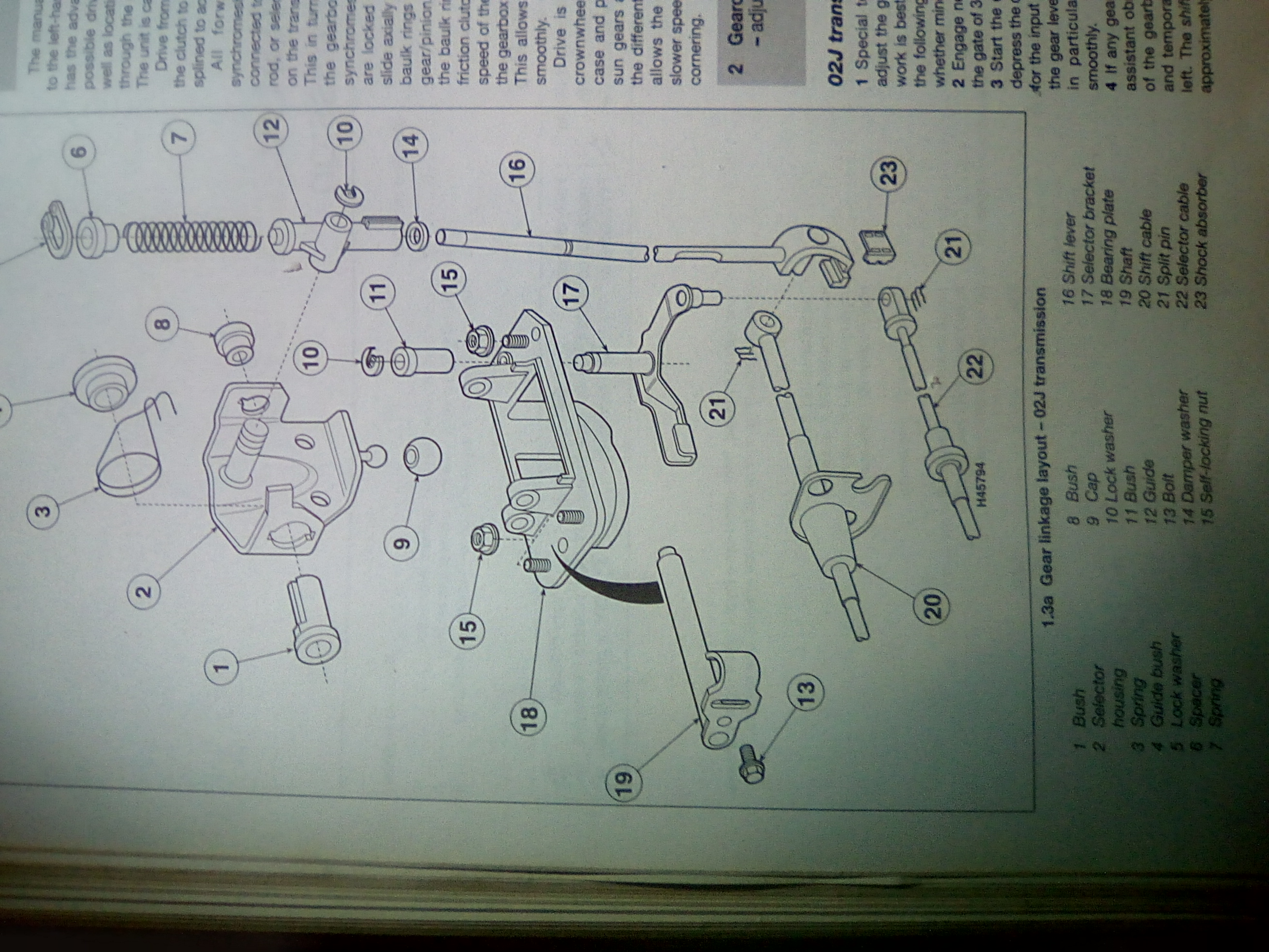

@trainautos watched your tube videos and I have way more play in shift stick, forward/back and considerably more sideways. Will have close look at the bushes in the pic you attached. Appreciate your input
How did you resolve your issue in the end?
I had to get the bush kit done, replace the cable catchers and reset the cables and also the Transmission oil.. hope you have replaced the Transmission oil with genuine GL-4 (G 060 726 A2) one or Redline because VW Transmissions are very sensitive.

There a lot of play in stick so think i mite invest in the bushes
Just about to check the linkage end now and was going to pop out the slave to see if its not leaking everywhere inside.
At the moment while driving 1st,2nd,5th are reliable.reverse noisey going in but 4th is bad trying to select and 3rd refuses to go in most of the time

It is sounding more like linkage wear than oil related to me, definitely get the cables reset, and change the bushes, cheaper option than having the gearbox out - especially if the clutch is working ok/not slipping under load

If you were replacing the linkage cables is it possible to gain the access needed inside the car from above or does it require moving exhaust and being underneath car.
I thought in this pic looked like No.15 three locking nuts when removed mite give access to the cables. Actually looking again now,not so confident,sorry

You might want to check the price of the gear linkage cables, as they used to be in the region of £150 each, but the cable end adjusters are quite reasonable. if you look on Dieselgeeks youtube website, he shows a method to change the lever linkage bushes with the remote housing in the car.
If you want to work on the lot on the bench, then it is exhaust off, heatshield off, and undo the nuts and bolts that retain the remote and drop it from the car. Dieselgeeks version requires patience and the complete removal of the center console. If you have lost your front to rear cable bush, you make an extra access hole in the remote housing with a hole cutter to gain access and do it in situ.
