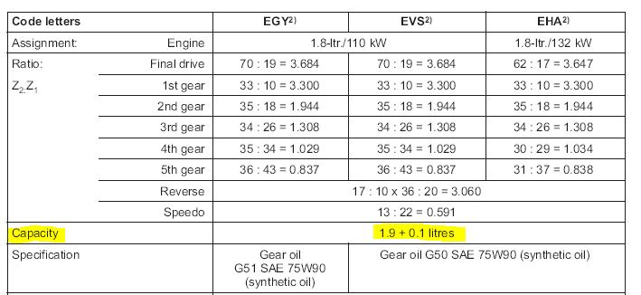

  • This might help - workshop manual for the gearbox Gearbox.pdf

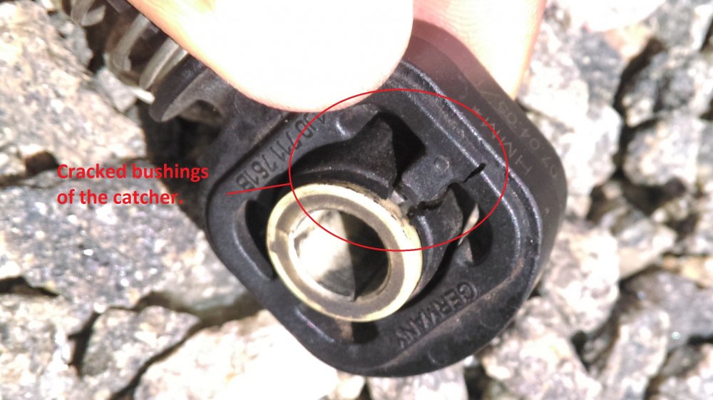

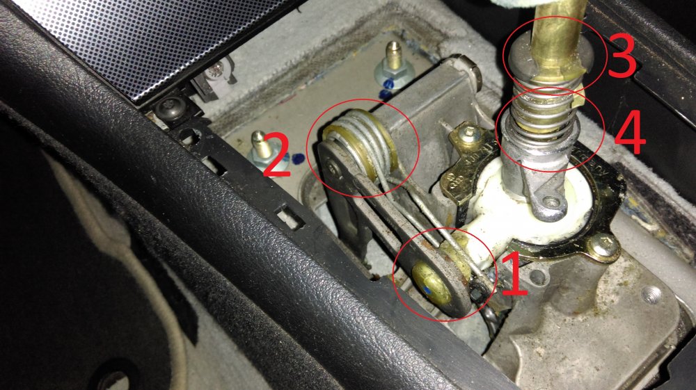

What you are looking for when somebody shifts gears is free movement in the cable ends due to wear in the bushes that fit over the transmission linkage, so that means that the cable is moving but doing nothing to the box end.
Also look for any other areas that are moving a lot in any bushes but not transferring the movement.
You can also look for play in the bush that sits around the gearlever ball and is black and white in colour. With the gearlever gaiter raised, you can also shine a torch down into the hole in the remote casing, and see any movement in the cable end bushes connected to the bottom of the lever, both side to side and fore and aft.

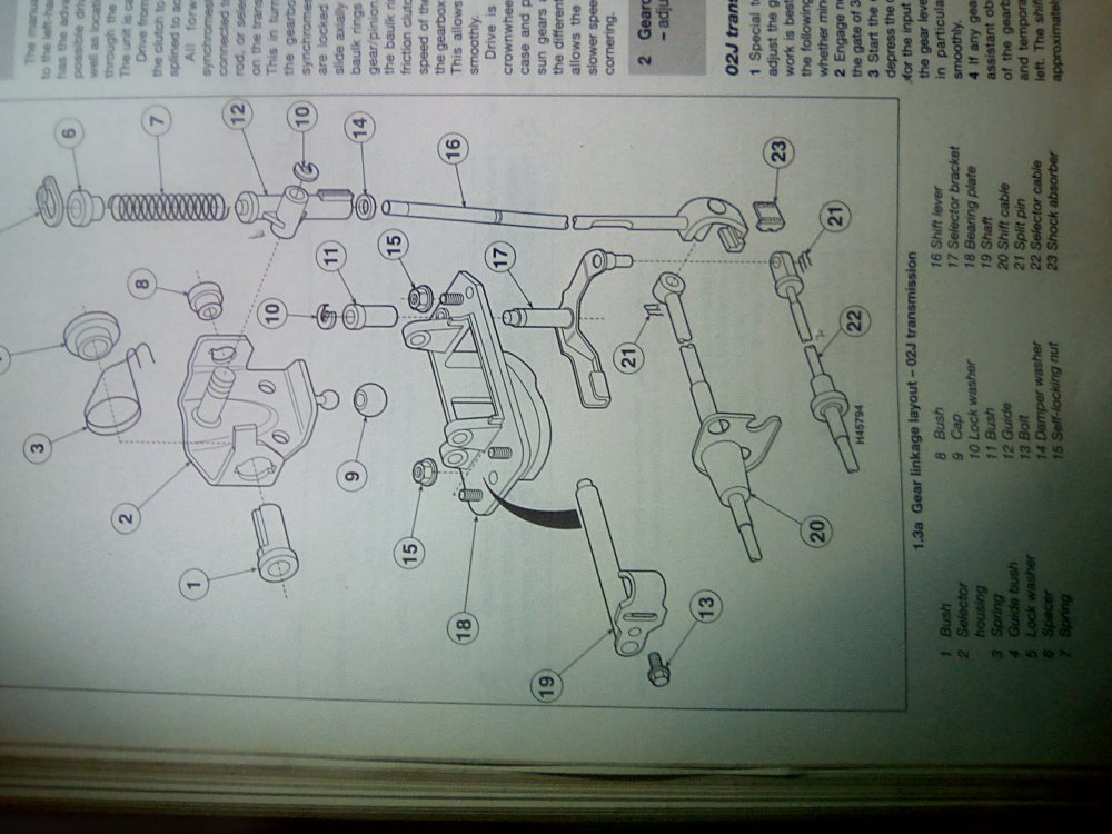

Also, just had a thought, there is a bearing in the tower that supports the gearselector mechanism that can fail. you can normally confirm this by trying to move the linkage mechanism in a side to side plane - like the points on the compass, there should be a little movement to allow it to move, but not mm's worth if you get my drift.
A bit more info on my poor instructions - http://workshop-manuals.com/skoda/octavia-mk1/power_transmission/manual_gearbox_02j/gearbox_mechanicsoperation_constructiondiff./disassembling_and_assembling_the_gearshift_mechanism_on_the_gearbox_side_as_of_05.99/
Edited by kentphil1
Exactly what Kentphil1 says - you are looking for movement that shouldn't be there.
