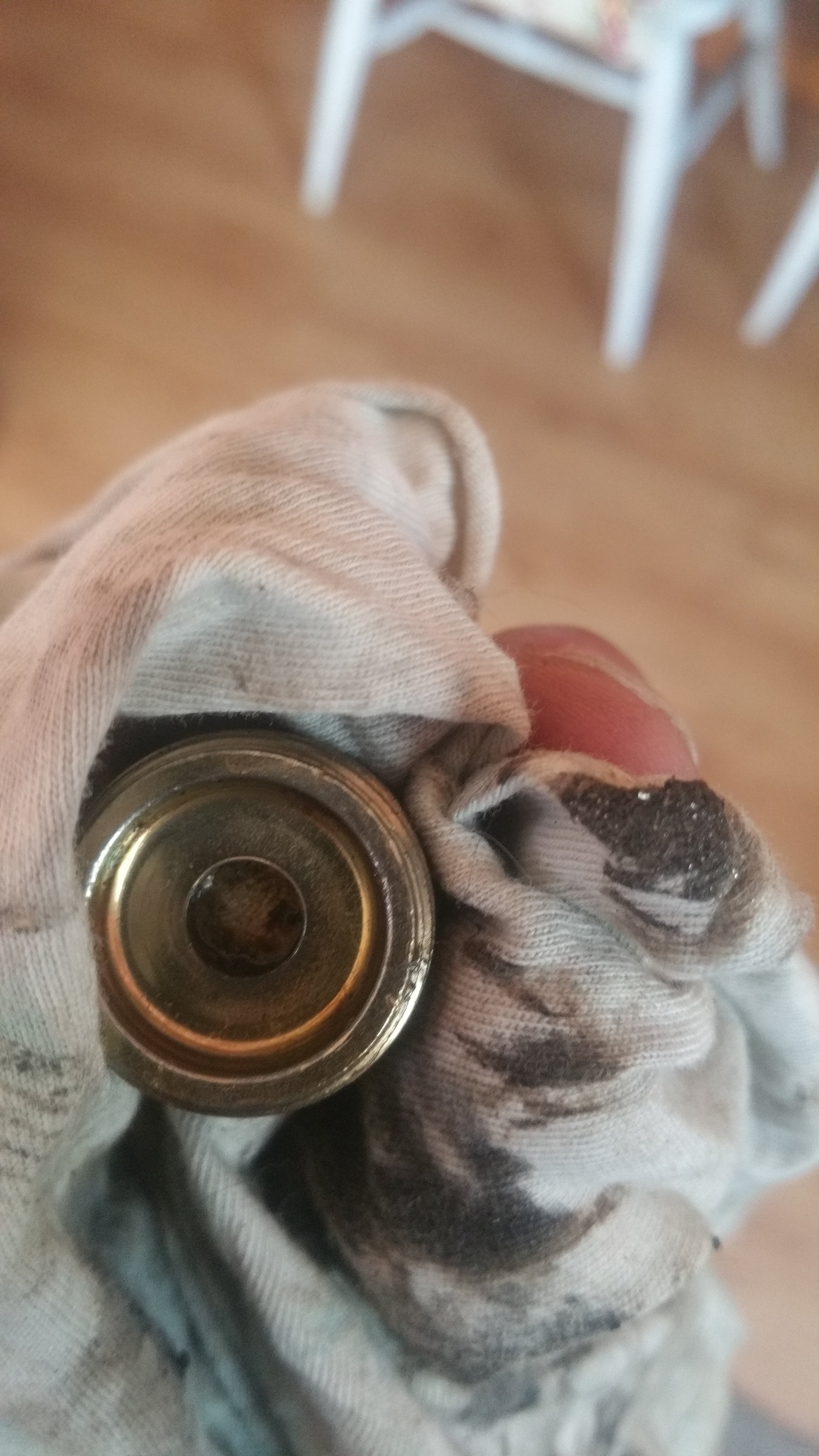

Changing the gear oil today (thanks Bowders for guide) and on the inside of the drain cap there is defo some cery fine metal filings. Hope u can see them in the pic
Will see if the oil change helps...
On that evidence would you be thinking gearbox on way out or could it be something else??

The deposits on your plug look fine to me, if it was like a pine cone, then I would be concerned.

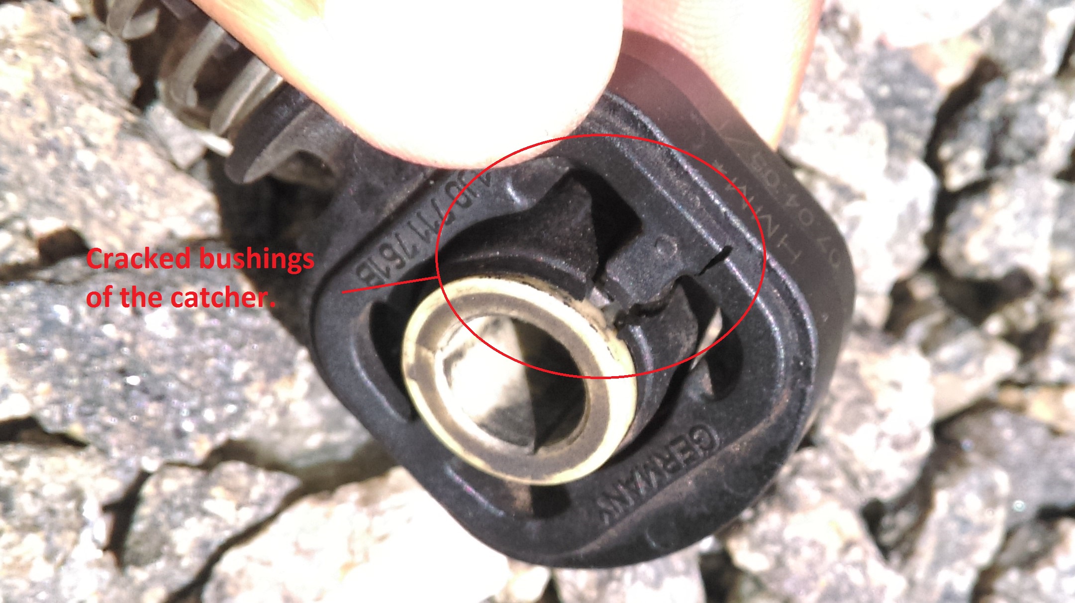

     Myself was chasing the same issue for over a year, at one point almost purchased a used tranny thinking that it was shot. There are many things that needs to checked before the tranny needs a replacement and trust me on this hundreds of old VWs are getting scrapped because they shift bad.. how funny isn’t it??
1.       Gear lever front to back and side to side free play-  The front to back gear lever free play should not be more than 5mm. The side to side play should be zero. If this is not as per the specs above it will show the same symptoms that you face now. You can check the link. https://youtu.be/tnftEgZTykc
2.       There are two bushings that help with the reversing mechanism and usually the bottom bushings would be shot No 3 & 4.
3.       If your car has run more than 100k miles its better to change the cable catchers since its only a few quid. Mostly the rubber bushings of the catcher will be shot. Skoda Part Number 1J0711761C & 1J0711761B
The bushes that needs checking are marked in the pics below and after inspection if it needs replacement a kit is now available
link below
http://www.ebay.co.uk/itm/162556017889?ssPageName=STRK:MESELX:IT&_trksid=p3984.m1555.l2649
Regards
Train
Edited by trainautos
pic

@trainautos watched your tube videos and I have way more play in shift stick, forward/back and considerably more sideways. Will have close look at the bushes in the pic you attached. Appreciate your input
