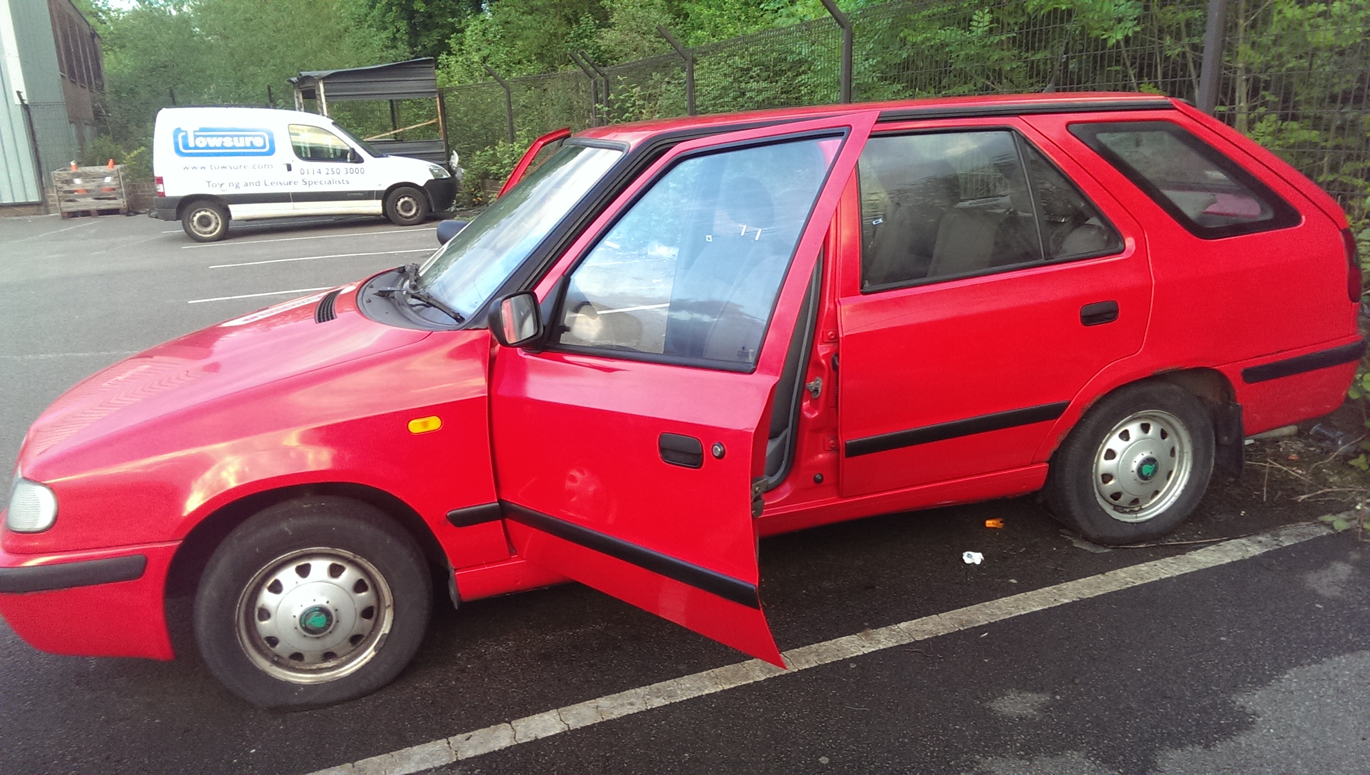

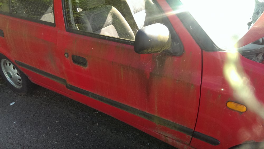

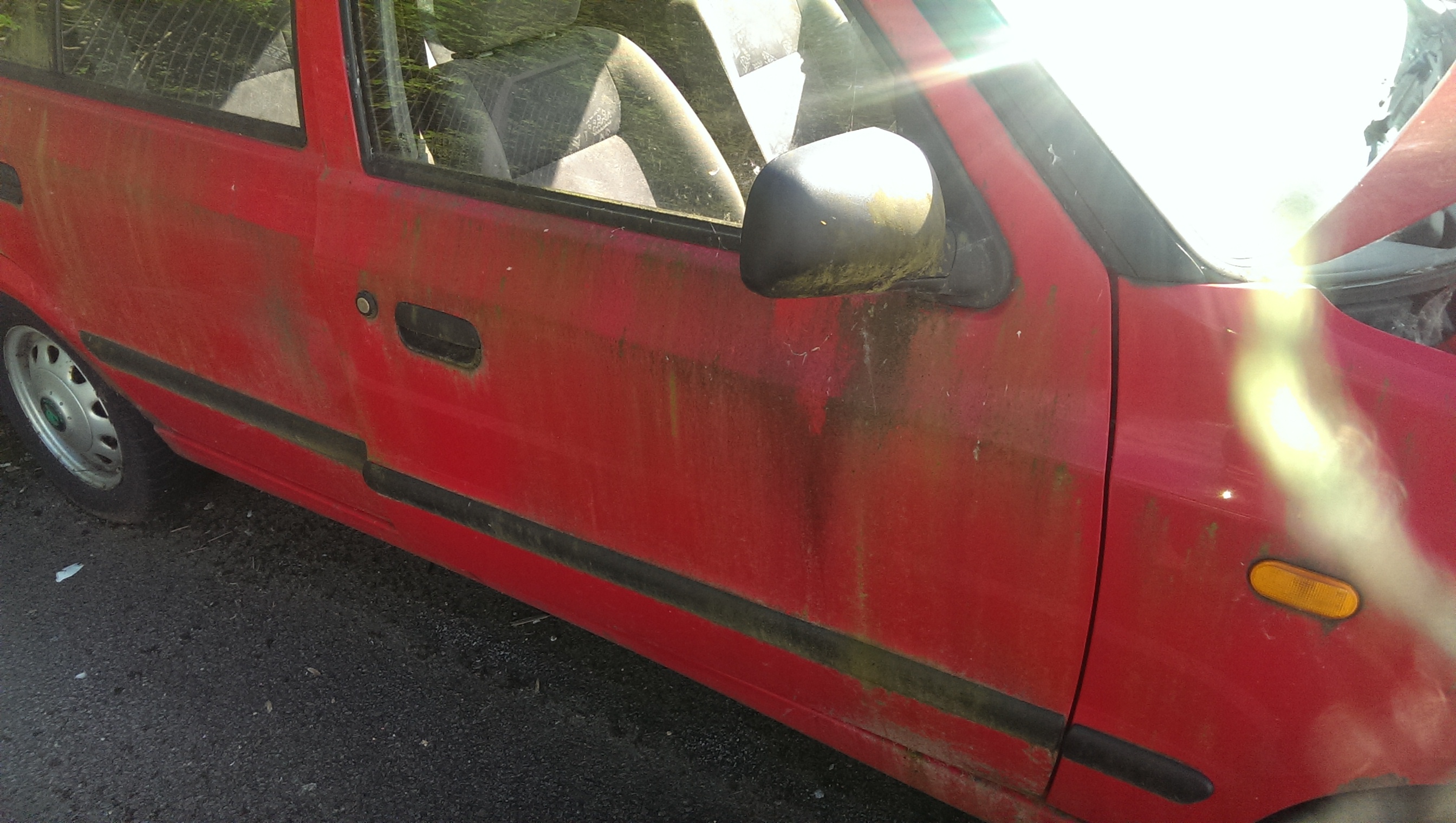

It's been a while since I started my Felly...I laid it up in June 2014 and I hadn't touched it until last night...it was looking tired and unloved (awwww....)
Anyway 3 hours of graft later....
And what's more, after 3 years I charged the battery with an optimate charger, connected it up and she started instantly; as if she'd been running daily!   I love these 1.3 lumps, they forgive so much! :D
Okay, there's an overheating issue but those thermostats standing 3 years?  Hopefully a simple fix

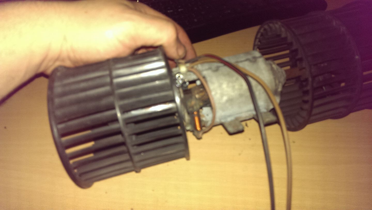

Like the blower motor...
Easy to remove.  £53 for a new one or just rip a spring out of a ball point pen and the brushes are making contact againblow.thumb.jpg.7b93c943cb234ebfa97353c0243d0838.jpg
That can go back in tomorrow...
