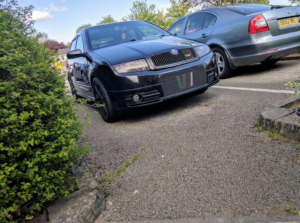

OTish - Nice looking wide-mouth; I take it there's an FMIC lurking back there?
