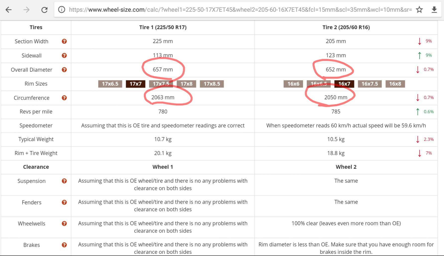

https://www.wheel-size.com/calc/?wheel1=225-50-17X6.5ET45&wheel2=225-45-17X7.5ET40&fcl=50mm&wcl=30mm&scl=50mm&sr=0mm
Scroll down to minus sizing.
205/60/16 is a different diameter. It's 3% bigger diameter according to the calculator.
@spottydog I think you have to recheck your table, are you looking at the overall diameter or circumference of tire? Both 225/55R16 and 205/60R16 matches thr PO's original tyre size with a margin of -0.4 to -0.7 % (which is next to nothing).
My point of having 205/60R16 is to have the smaller tyre width for a better fitment into the spare wheel well. If OP specifically want a 17" size, use 205/55R17, which has the same cirumference/diameter as original tyres on the car.

I just read the data on the tyre comparison chart.
Yes you're right. I had put the wrong ratio in the table as they were the tyres on my Octavia. I need to pay more attention :-)
