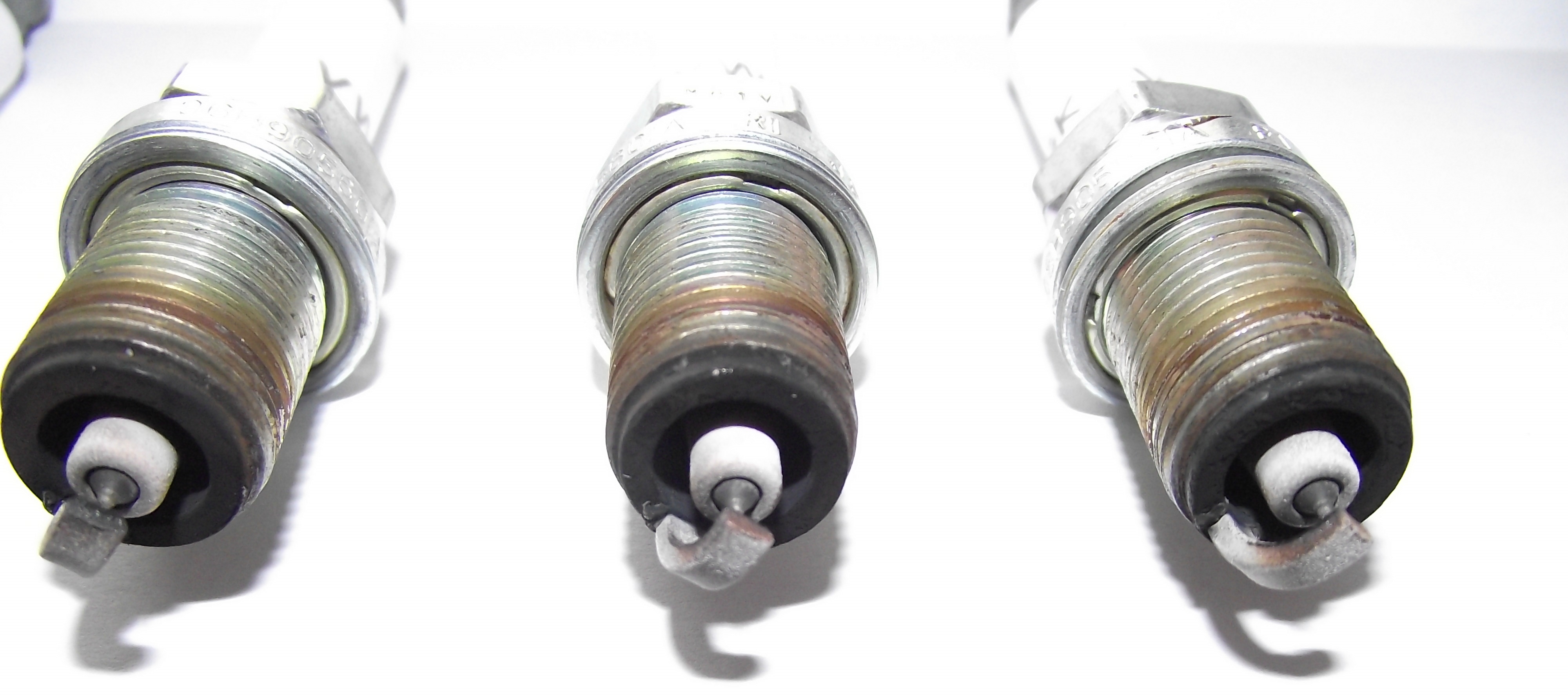

I am sure with that much oil in the cylinder as on photo above would give up any spark plug.

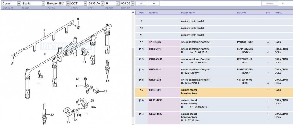

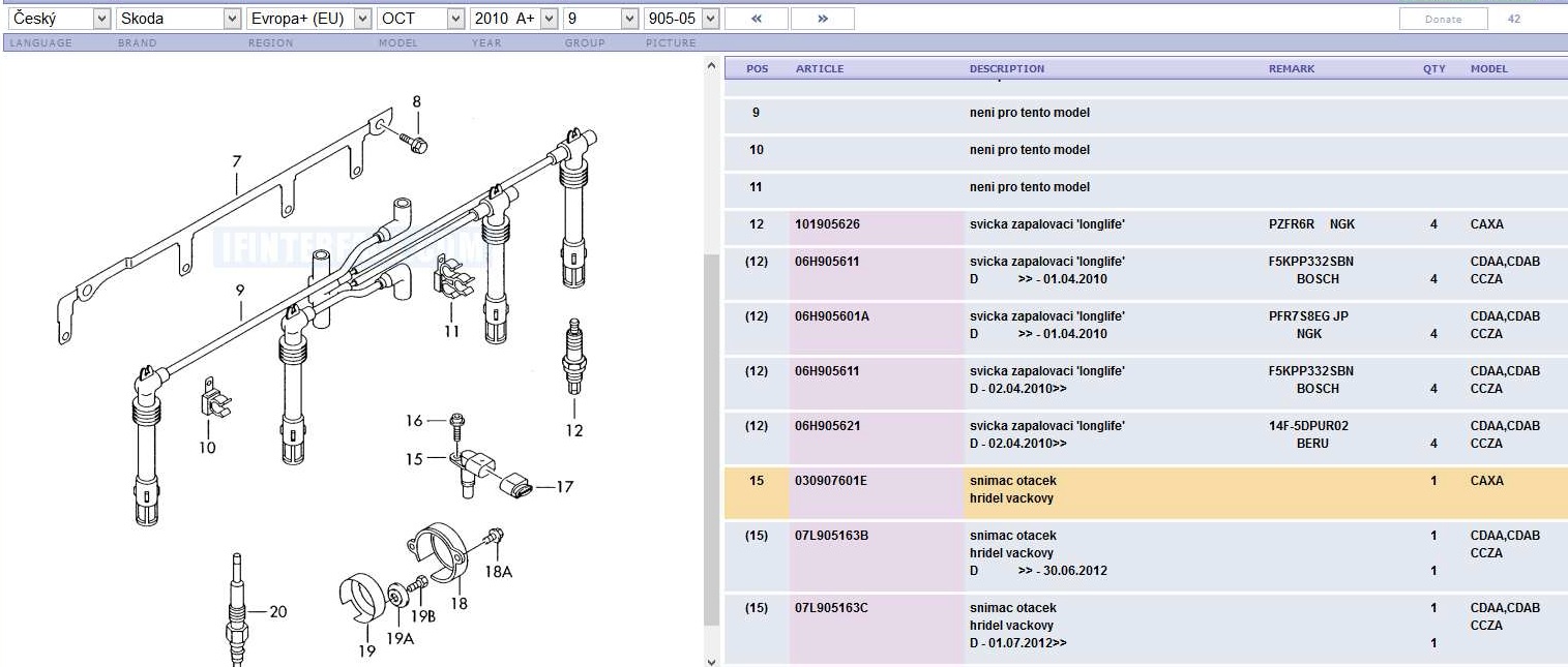

I believe this is enough to confirm, ETKA before latest updates ... VAG numbers and their versions from OEM suppliers. Again, it is always about information and right source. The same info is in workshop manual. Hope one number has only one part version, see below why I mention that.
Concerning resistance, as you can see, Bosch plug 06H905611 is F5KPP332SBN and acc. their catalogue it is 1KOhm too. What is a bit strange, Bosch has for the same VAG Nr. yet plug  FR5KPP332S, and yes, this one is 6KOhm, but according the info from ETKA not the right one ... When links does not work, try this one and search http://www.bosch-automotive-catalog.com/en_GB/product-search

Skoda will give you what they see in ETKA, it can be either Bosch or Beru (now 06H905621 replaced by 06H905621A).
NGK they say not used anymore, I personaly still stick with it, but now aftermarket ones.

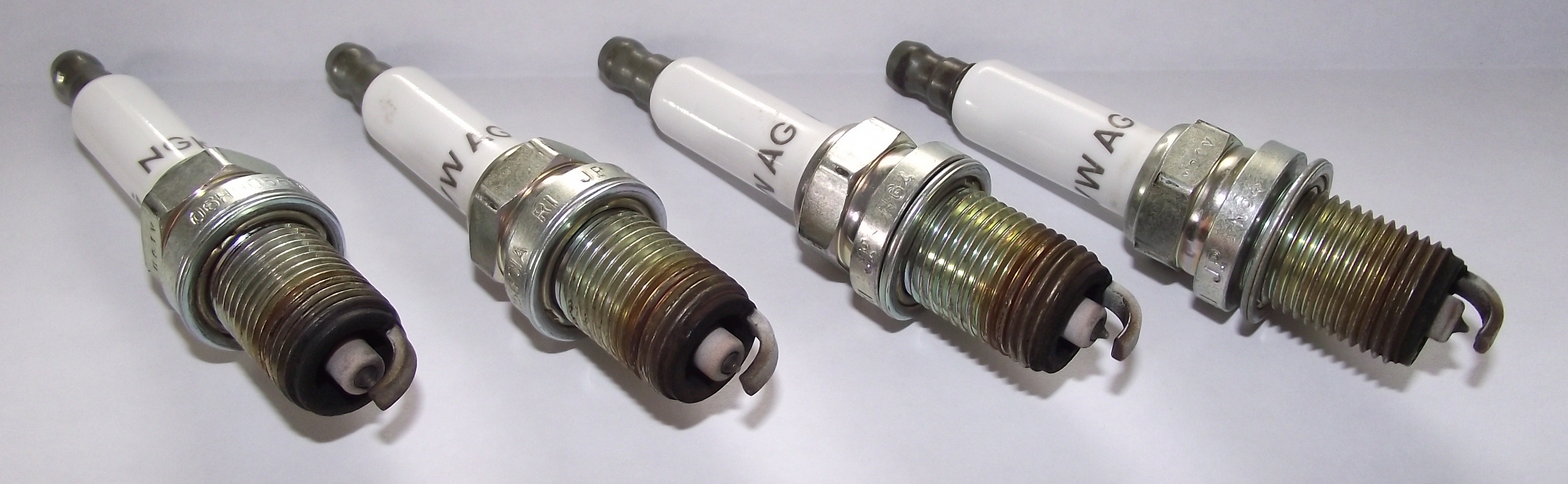

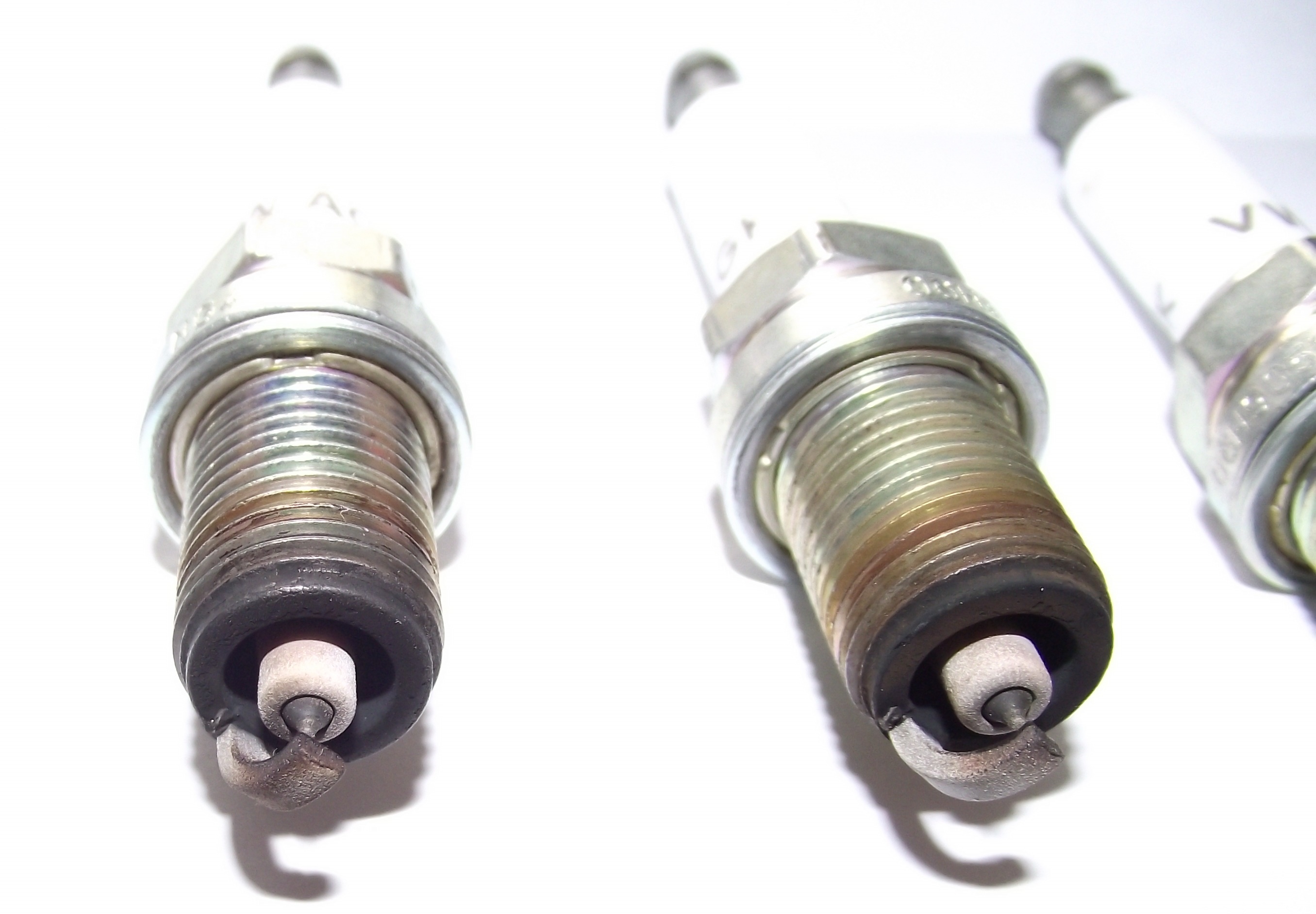

Just to answer my curiosity, I got my old 06H905611 out of the garage (they were original in Apr 2011 CCZA) and measured the inline resistance just now - 1.5k ohms.
So far, on our discussion, it seems there is a choice, ~1k resistance go for NGK, 0.7mm gap go with Bosch or genuine VAG bosch (edit 06H905611) you get ~1k ohm and 0.7mm!  Can't seem to do both aftermarket, maybe in the Beru haven't looked at those. AFAIR the densos aftermarkets  are at 5k ohms too.

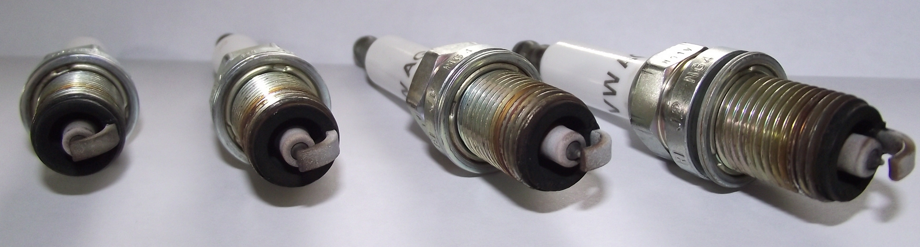

As this topic is general, no problem :cool: I notice on photo you posted the Denso ones are shorter. Would be interesting to measure on dyno, looks when electrodes moved off the designed centre it copes better with that beast, but are the hp/torque same? True is, I rather give up few hp/torque for longer engine life :cool:
