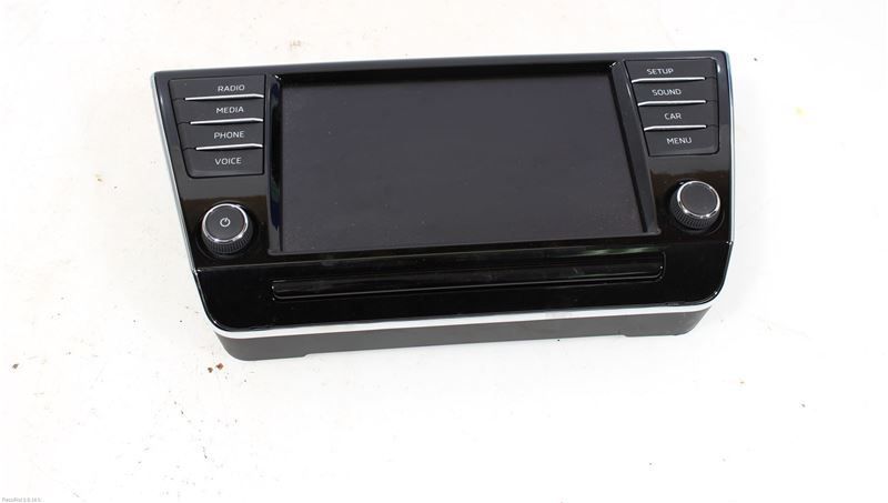

Do you mean this?
Ok thank you
Is this from a real bolero ?
Because bolero( 8 inch) must have a diferent partnumber from columbus or amundsen 8 icnh , buttons are diferent ,bolero has setup button and sound , columbus has nav and traffic so they must be diferent.
I want to swap just display but i need the correct pn.

If you see the screen in the next link you will see the buttons are different it has setup and sound button ,  the part number is 3v0919606B but you can´t find it on the web.

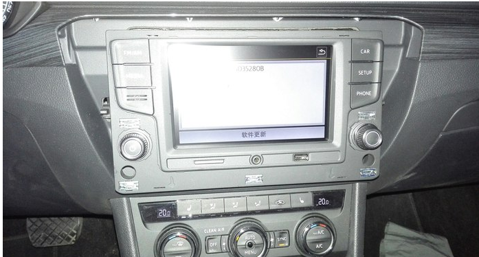

I am on the same page with you. I am also trying to find 8" bolero to replace it but I couldn't so far. I don't know why.
ps. I have also tried to install passat's 8" screen, it was working with no issue. As you mention there are funtional differences.

Here is the one we need.

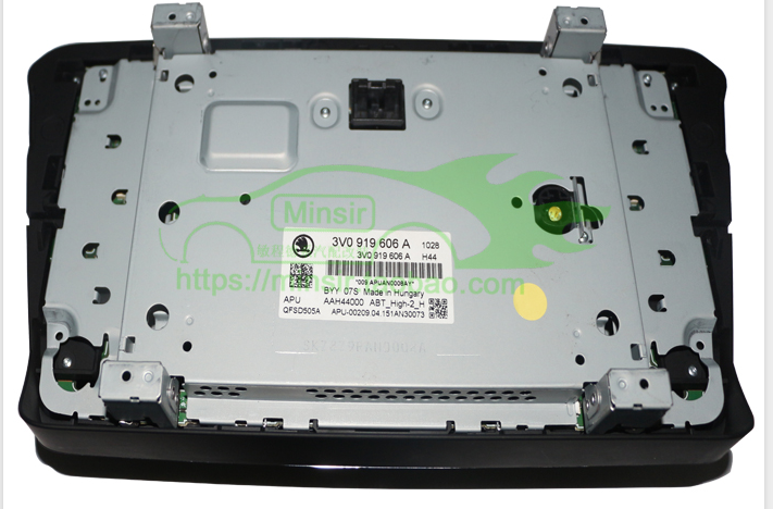

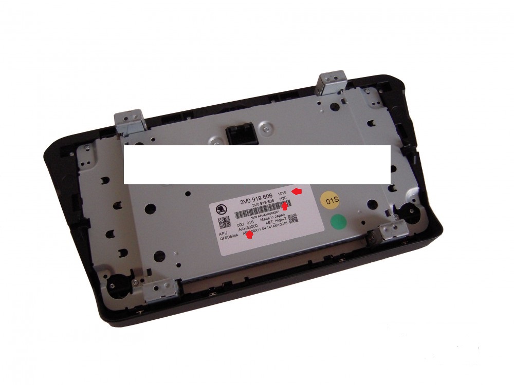

Searching in bing i found the back of the correct screen (Car  equipment), the red arrows point to the diferences .

Finaly found the images from one car.
Confirmed reference 3v0919606B
