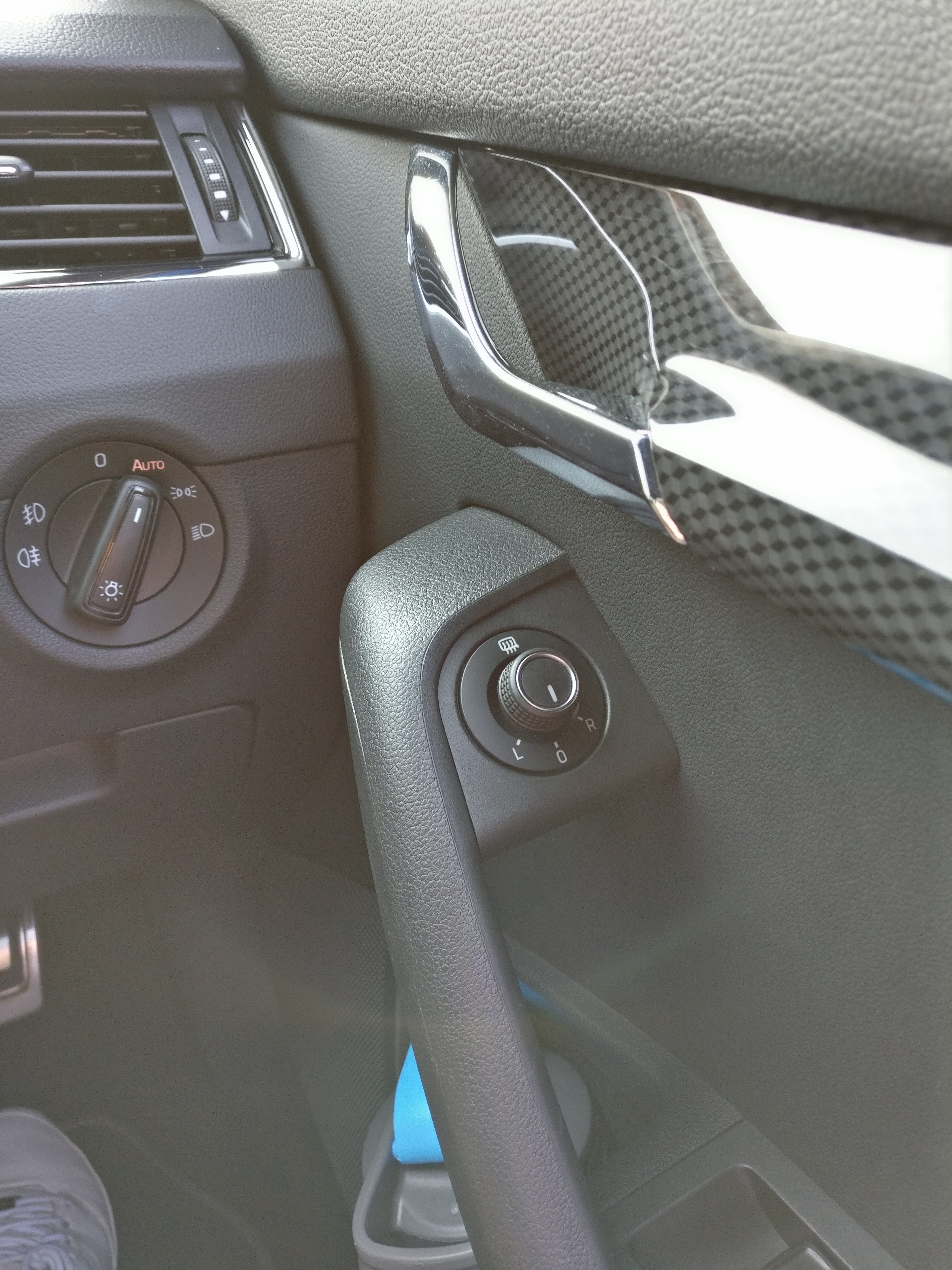

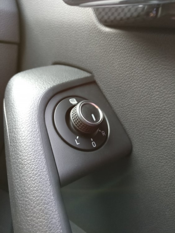

Found a solution for the mirror switch adjuster. Part no: 5G0959565Q (for LHD) or 5G0959565S (for RHD) - Guessing it won't matter if the knob comes from an LHD or RHD, but probably easier to source the RHD part in UK. Looks like you can take the chrome knob from the Golf 7 part and fit it to the existing bit in the Octavia. Looks neater than the standard one.
Edited by ahenners
The knob should just pull off. And go back on with a dull click.

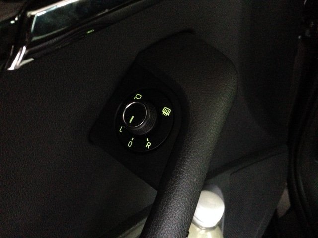

Minor update: My Golf 7 door mirror switch arrived this morning (£12 used on ebay - 5G0959565S) so I removed the existing mirror adjuster knob and replaced it with the one from the Golf.
The knob was quite stiff (steady!) to remove from the Octavia, but managed to prise it off eventually with a trim tool/lever wrapped in a cloth to prevent scratches/marks around the knob. The bit that it attaches to looks quite delicate, so care needs to be taken otherwise you could potentially break the shaft (not doing this on purpose - honest!).

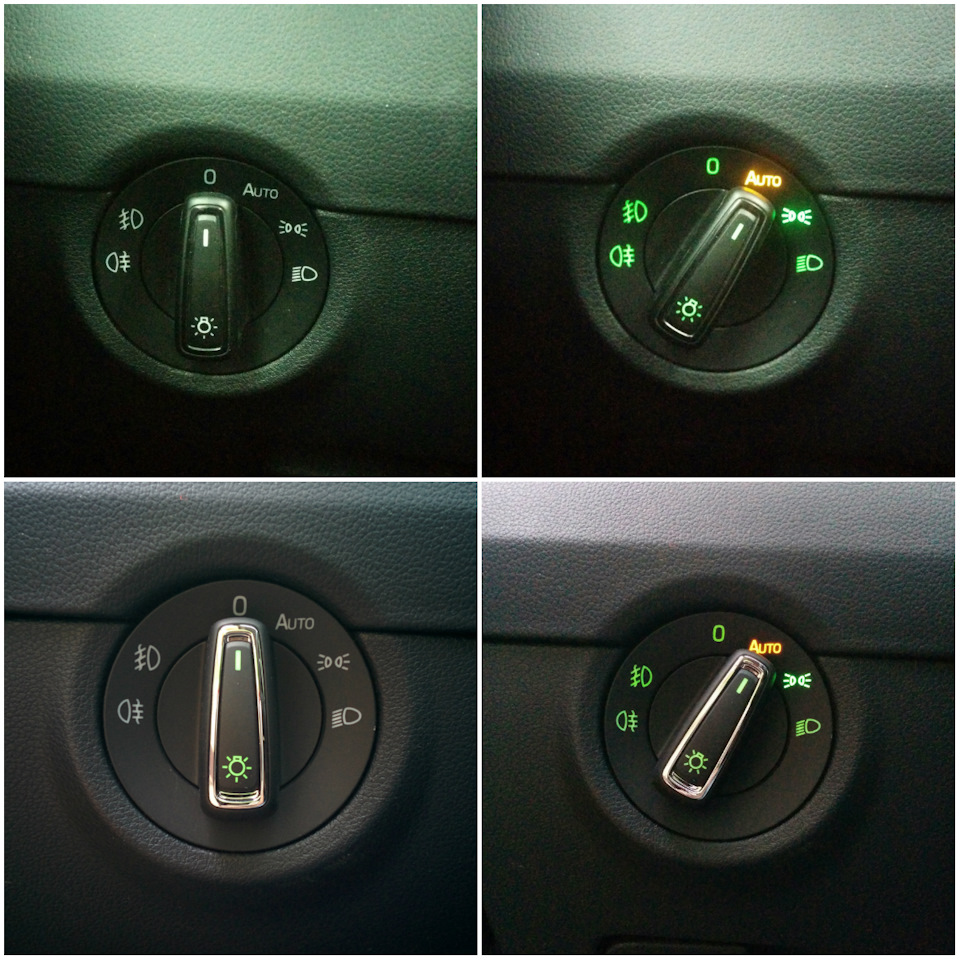

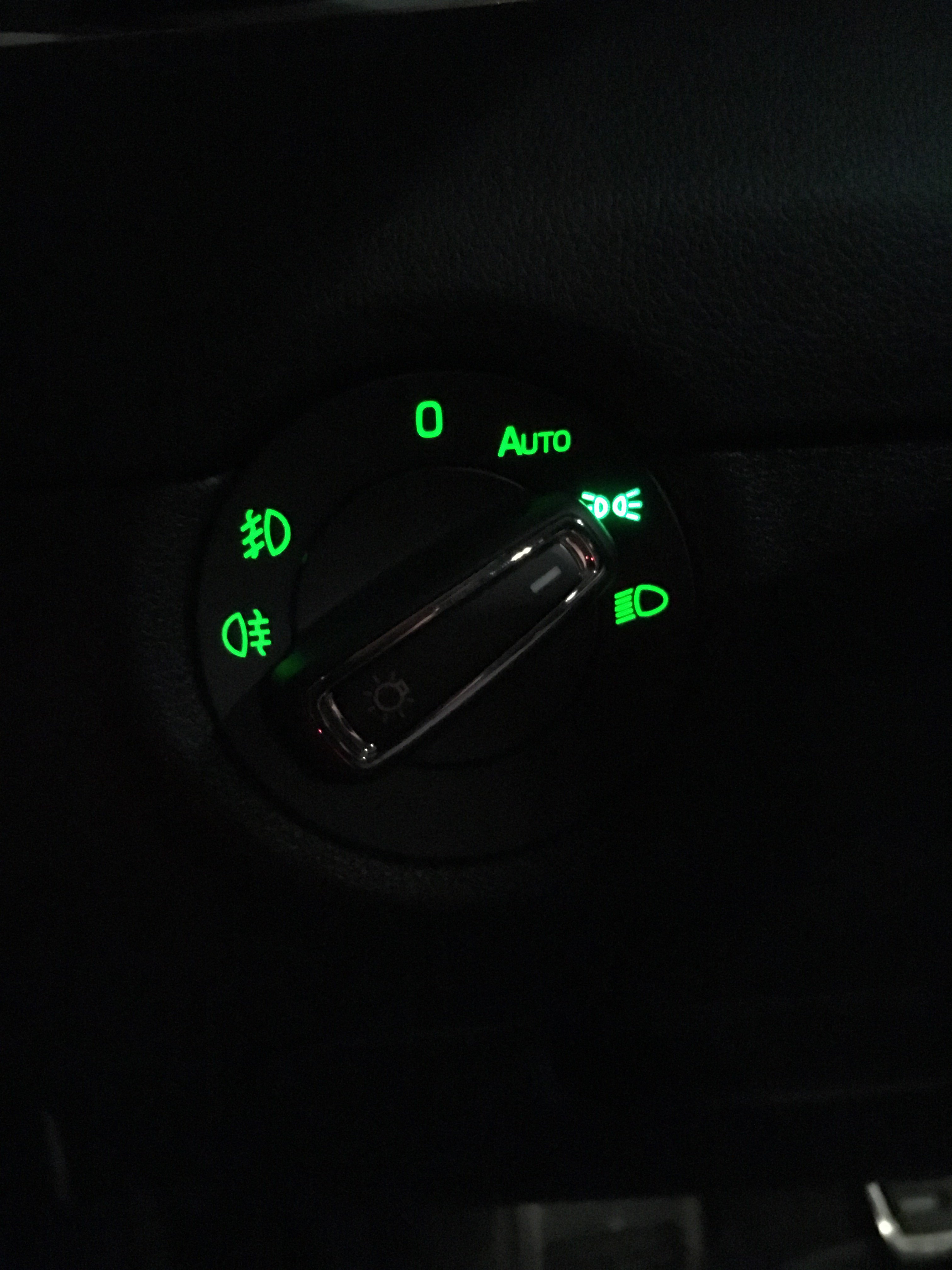

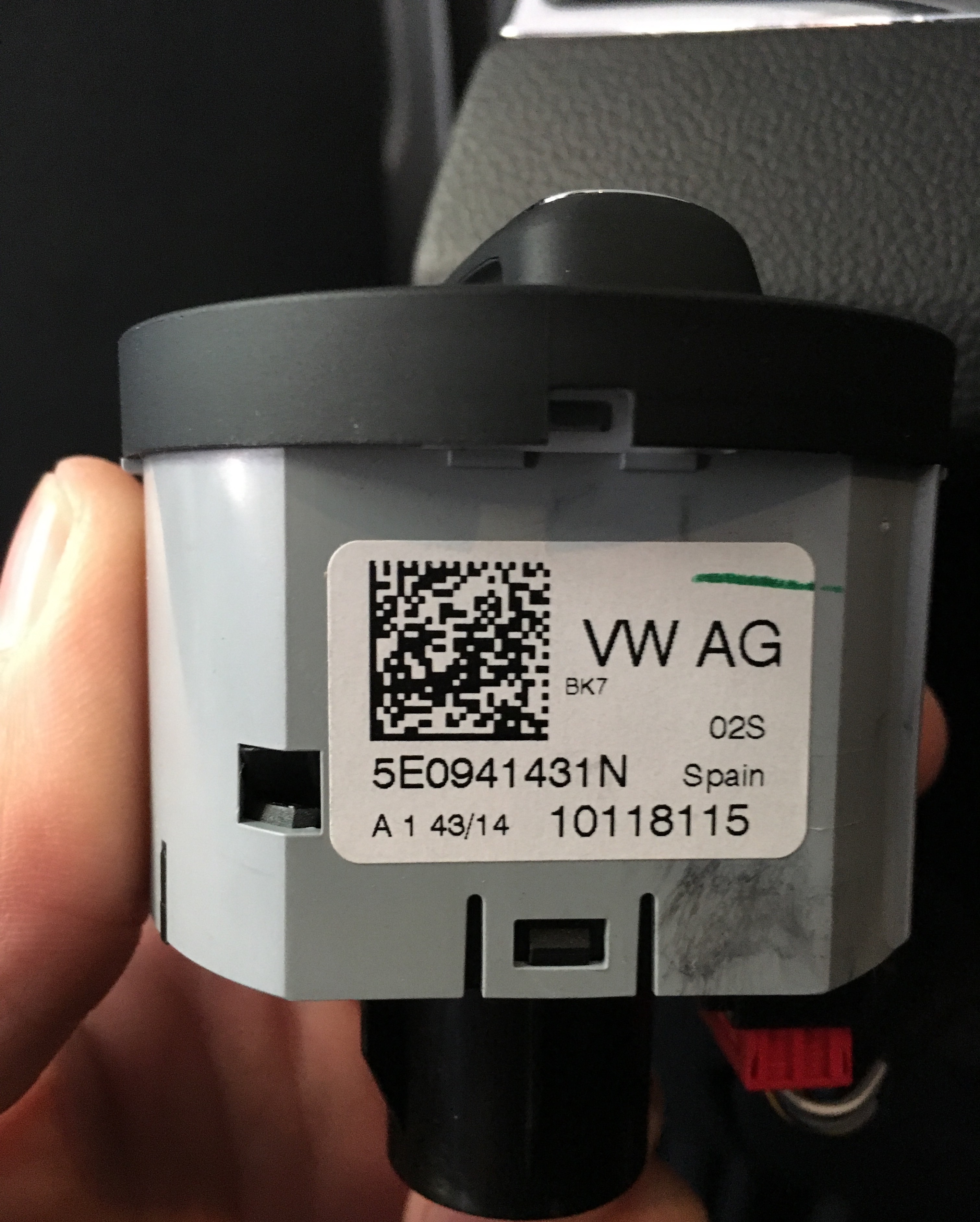

Also ordered the Chrome auto headlight switch from the L&K yesterday, for £57 :blush  I've been scouring eBay and various breaker sites for the part 5E0941431N over the past week or two but had no luck finding one. Took the plunge and ordered a new one, at what seemed to be a pretty reasonable price including postage, compared to other dealers. Briskoda parts (Mike @ Seat Worcester) were considerably cheaper than my local dealer (£80) and Skoda Parts Online (£68). Helpful bloke too and would use for other part quotes in future.
No ETA as of yet as none in UK stock, but expect it should be a couple of weeks at worst.

Sorry haven't added to this thread as I haven't had the time with both cars in my possession simultaneously for several weeks - however, the auto light switch for my FR is identical in terms of backlighting to the VRS (but different to green L&K) but does have the chrome bling bezel you seek...
The VRS switch also has Green backlight like the L & K. Are you sure your FR switch isn't red or white backlit?
Just checked and you are correct for the Leon - I have instrument lights set to the lowest setting as most of my driving is at night (to satisfy the inner Saab Driver / Fighter Pilot in me!!!) so do not notice them too much. This mod is obviously not for me...
Leon light switch settings are:
Auto - Amber
Side Lights - Green
Front Fogs - Green when activate
All other controls are dim red.
The light switch colours do not change when the mode is switched to/from sport mode - unlike door cards red/white.

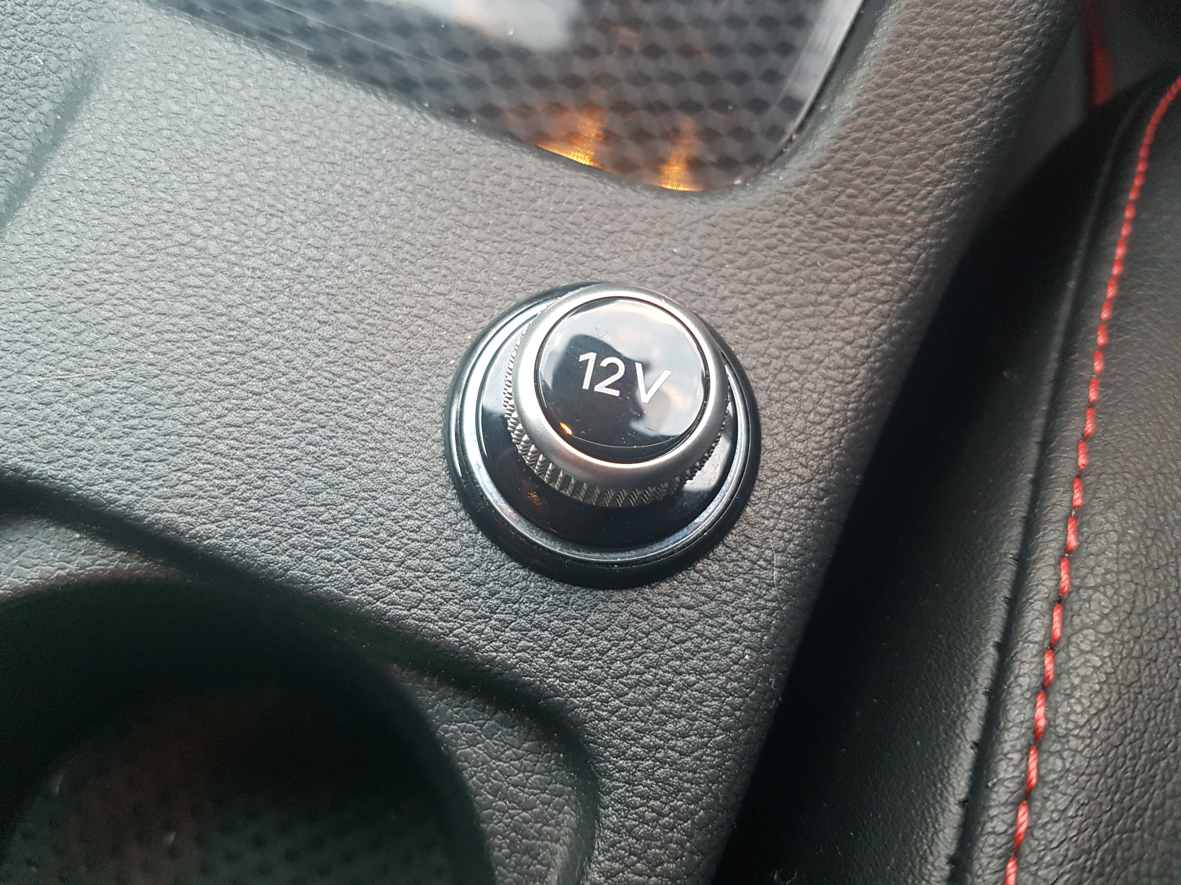

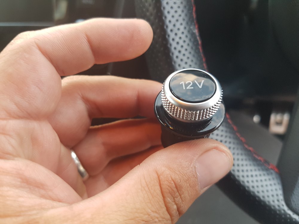

I thought about doing the switches in my vRS but changed my mind when I saw the price but I did nick this from and Audi A4 hire car the other day, could be a nice little touch if you want to go all the way with chrome
Thanks for posting, that does look good and fits well with the chrome theme. However I have a flush fit dual USB permanently fitted to my 12v socket, for charging my phone, so it's a function over from scenario there :)
