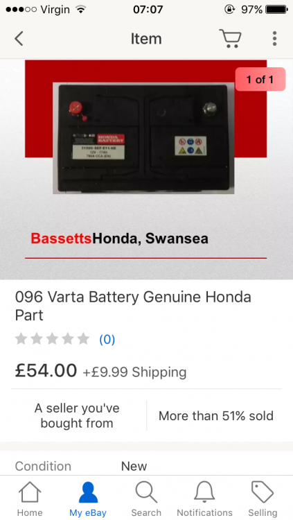

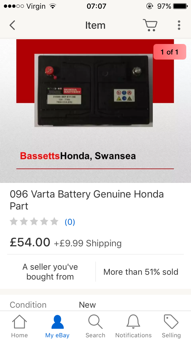

In my quest for a good quality affordable battery, I have stumbled across this:
https://www.ebay.co.uk/itm/132081207380
£63.99 delivered and says it's a Varta 096 (so I'm assuminh the E44 model?).
Doesn't have my engine listed under the petrol Octavia option in description but hoping it would work?

I'm confident it should be okay, described as 096 with specs as follows:
AMP HR - 77
Length - 278
Width - 175
Height - 190
Picture of item appears to show 'E11' and CCA 780 on the battery which is odd as the Ah of 77 & CCA of 780 are the specs of the E44, often recommended on here from the research I've done. Also only comes with 3yr warranty, which is what the E11 is whereas the E44 has 4yrs.
I phoned Swansea Honda who couldn't tell me anymore other than what's on the advert!
Shall I take a punt?! £64 for what possibly is a honda branded Varta E44 inc next day delivery is much cheaper than anywhere else online...

Jap cars quite often have the terminals the opposite way round.
Yes, I had a look at that, as far as I could tell it was ok. Neg left, Pos, Right.

I've posted the eBay link again above, hopefully you can see it now? For £64 it seems pretty decent, everything seems right about it in terms of size and spec...
Should still fit the Octavia tho right? If they're the 'wrong way' round, do the cables reach?!
Usually not.
Don't worry about what car it is listed for.  as long as the dimensions & terminal position are the same, you'll be OK.
4 hours ago, brad1.8T said:
Usually not.
Yes the dimensions work as 096 is confirmed by ECP and numerous posts on here as a comfortable fit. Terminal position appears the same as far as I can see...

Fitted the battery yesterday, fired up a treat first time and car feels great having done a few journeys now :)
Was quite a snug fit as others have said with the larger 096 size so padded sleeve was a little short in wrapping round but just used a cable tie to join it together.
All in all, very pleased. Can definitely recommend this battery. Considerably cheaper than ECP etc and higher rated at 77ah and 780cca, Varta branded :)
