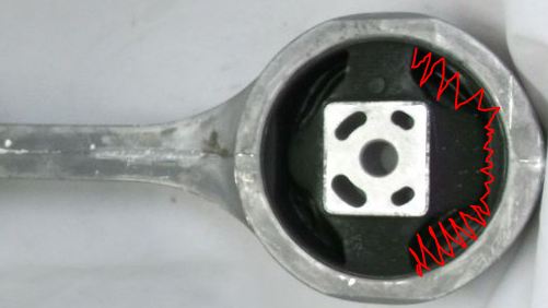

If Std, then will try to fill half of rubber bush with window glue- to reduce engine jumping front and hold vibrations in acceptable level.
