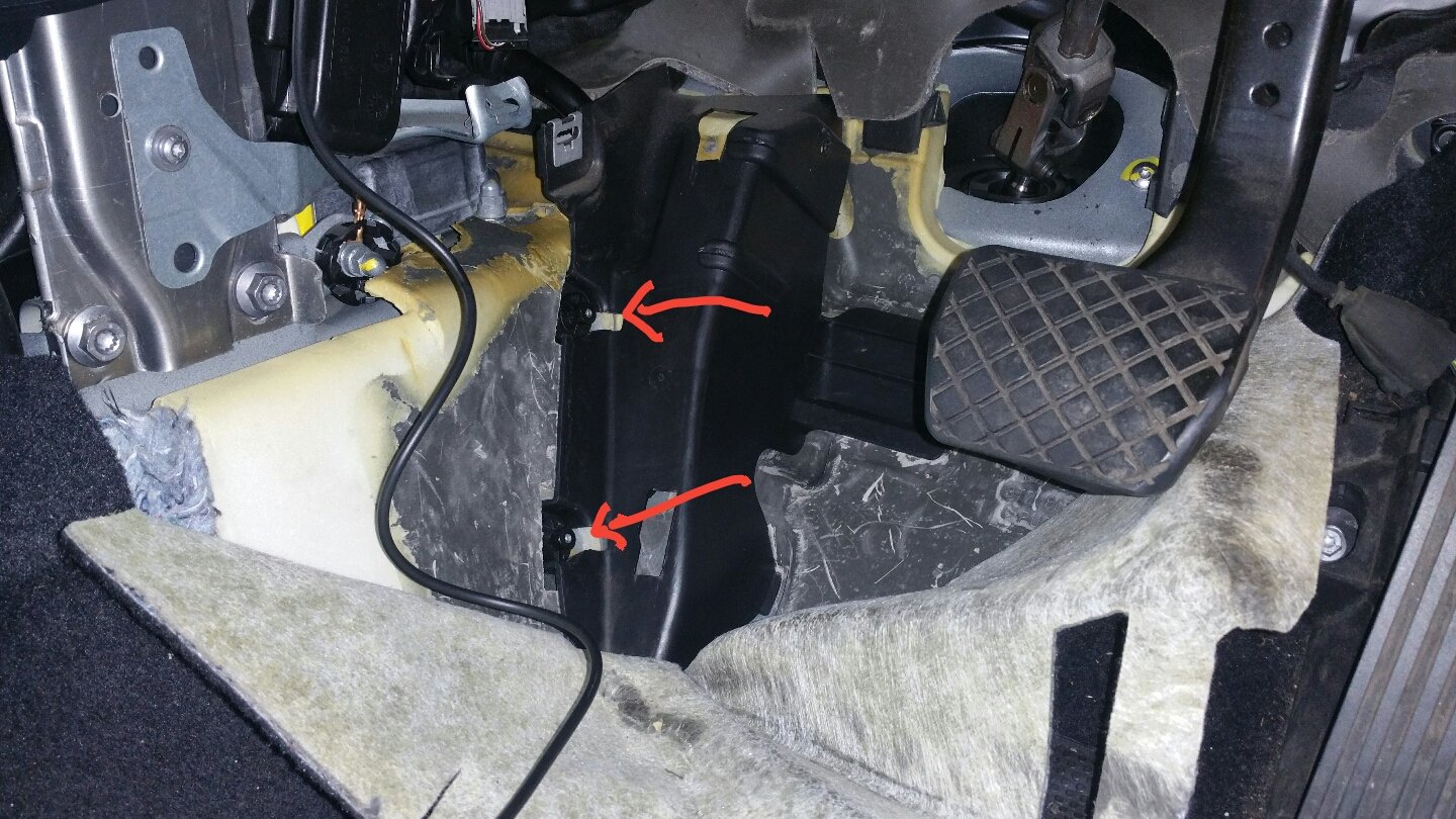

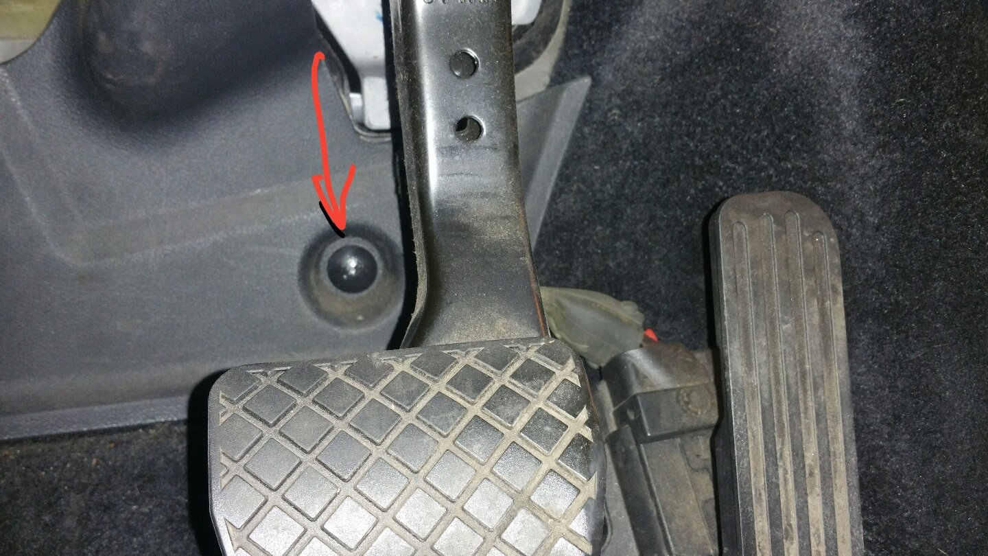

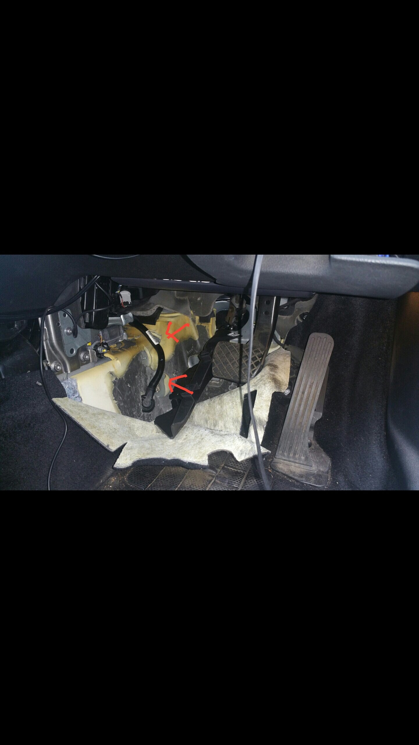

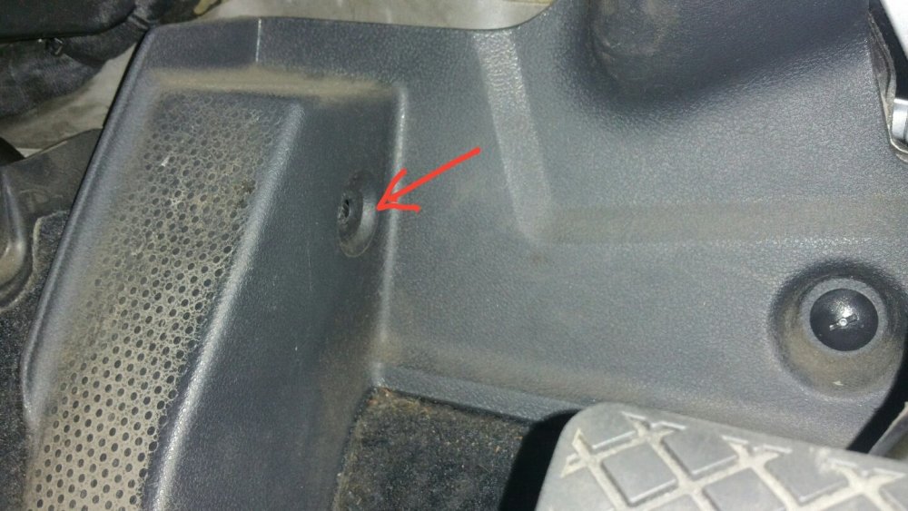

On my skoda superb mark 2 the aircon drain pipe hides under the footrest in the driver side footwell.   Footrest piece is held down with a plastic tab and a big plastic screw behind brake pedal,  once removed pull the carpet down and you will see a brace which sits on top of the pipe location with some insulation covering the pipe . Brace has 2 plastic nuts 10mm undo them , brace comes out , pull insulation up and you have the pipe.

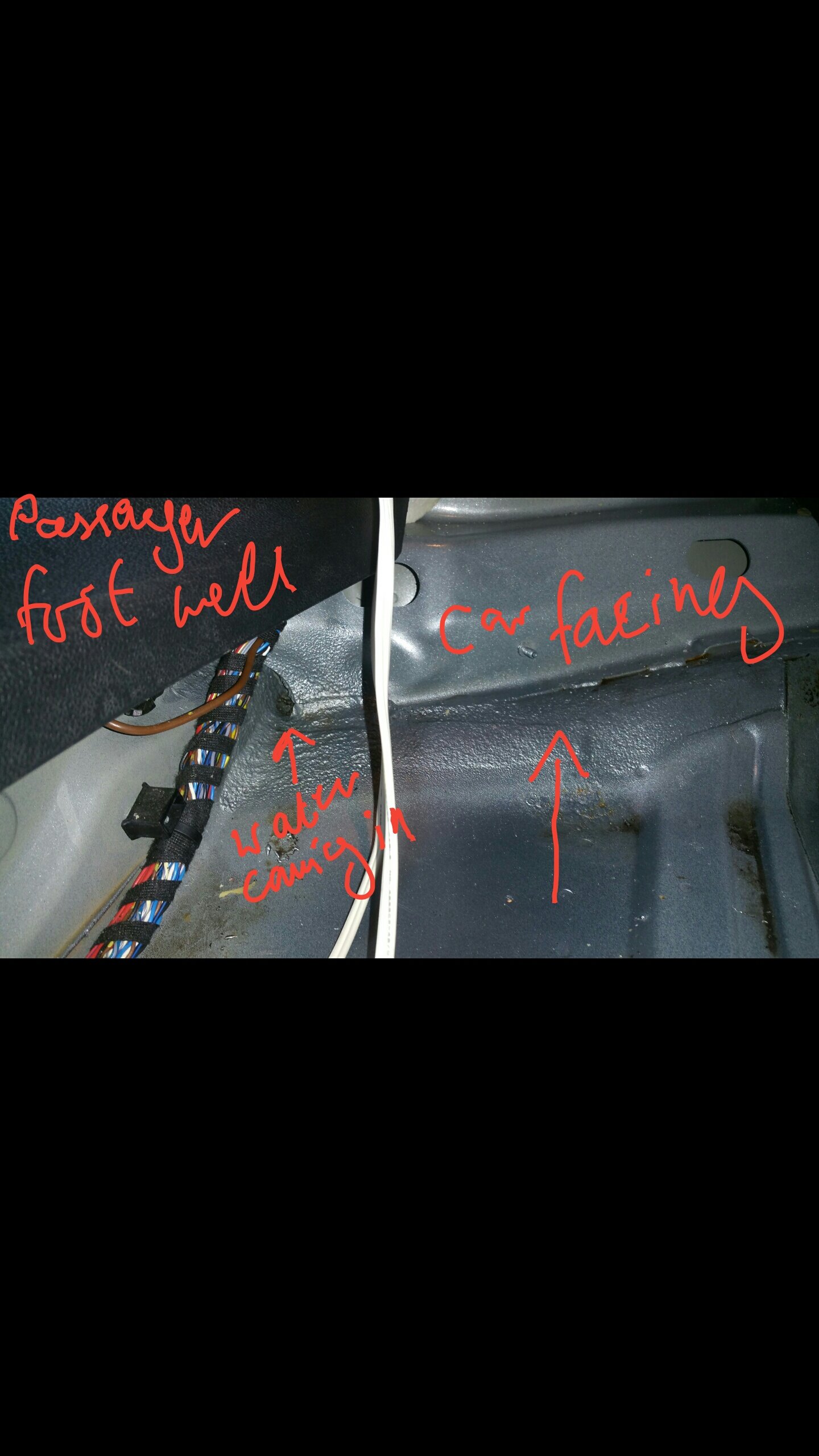

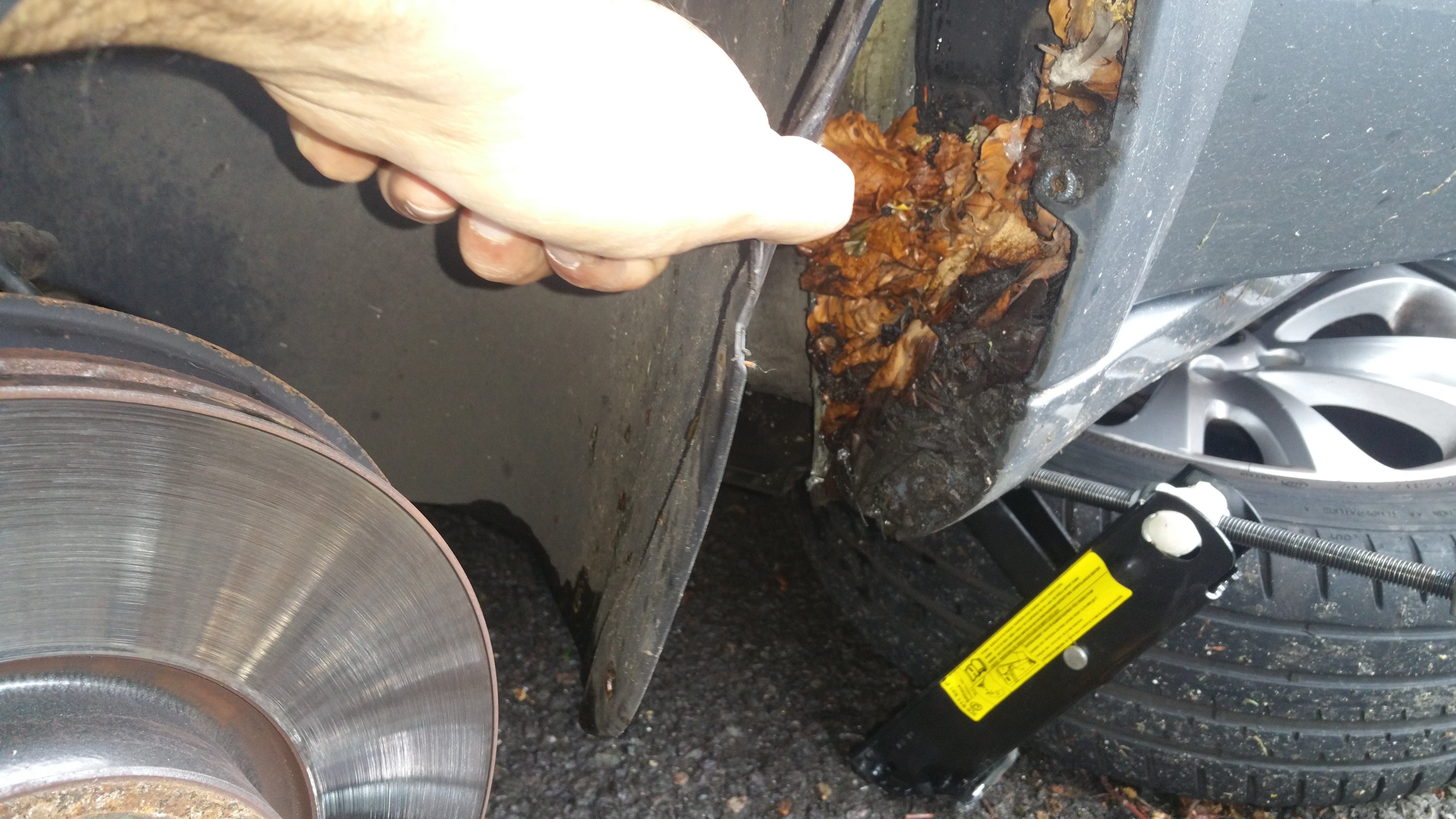

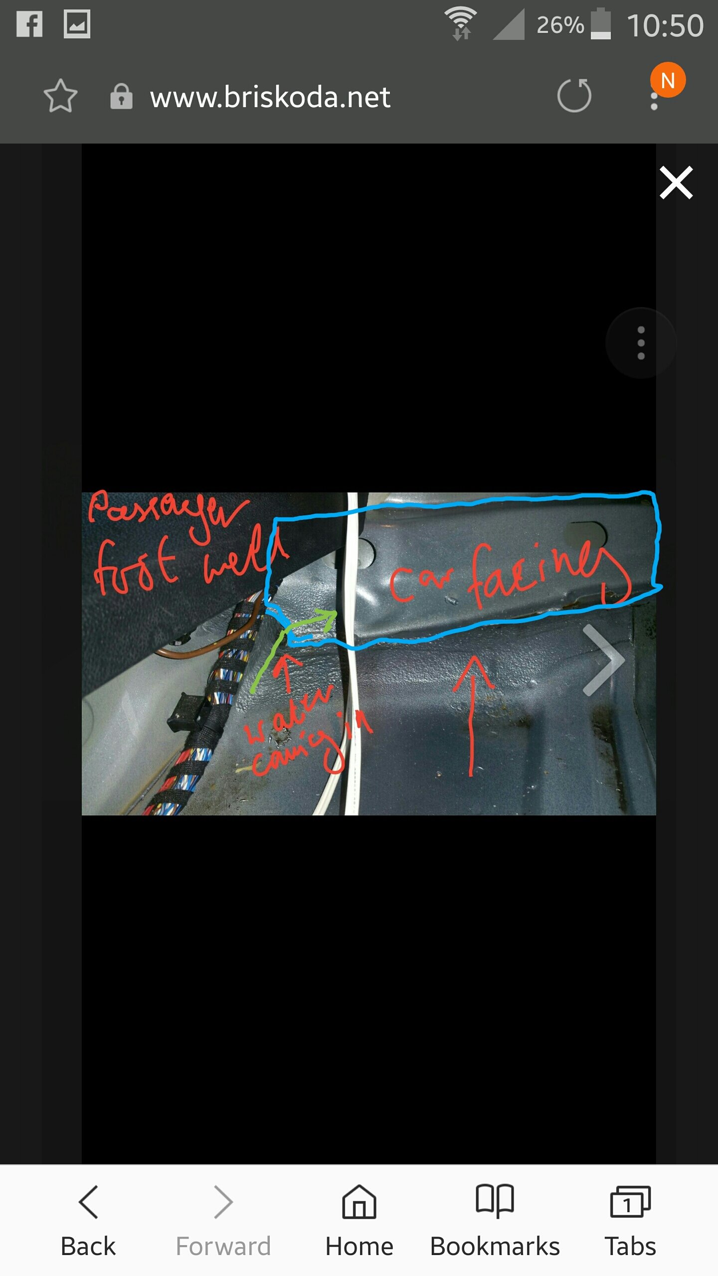

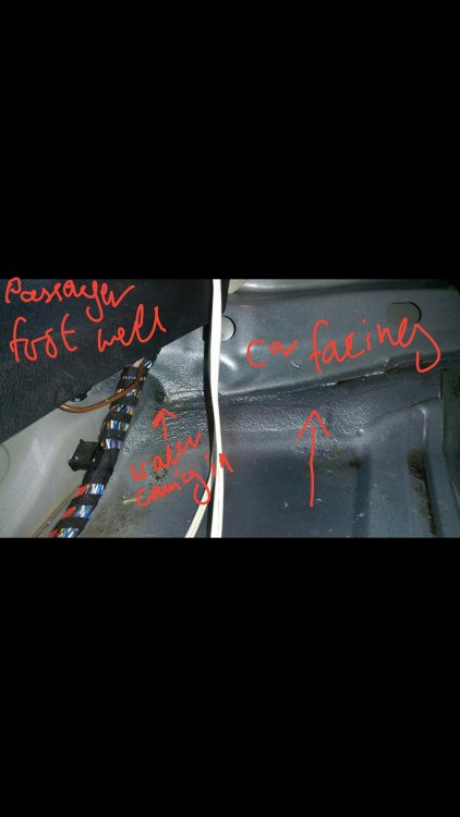

Found a hole in the very corner ( wheel side ) in the passenger side footwell which is part of a brace and that is where water comes in.  Pulled the inner arch trim out and found a stack of leaves and mud pilled up quite high,  cleaned it all out  ! Could this be the reason 🤔
Will leave under carpet insulation out and if water still comes in then investigation continues🙄

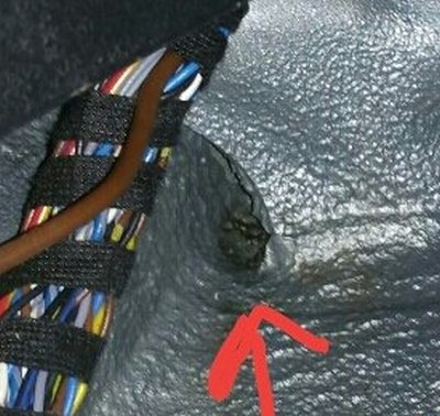

Is that a drain hole or does it appear to be corrosion?
Well water comes in under the carpet from that hole which seems factory but an odd shaped hole with paint all around it and with no corrosion what so ever 😞🤔 I wonder.
An enlargement of your photo appears to show a crack and a small split at the back of the depressed area ...
It seems that way in the picture as it is dark and wet in there . The part you feel is the crack is in fact the lip casting shadow inside the hole .
Area out lined in blue is a brace and that lip which looks like a crack is part of that brace. The green area is running under the lip and continues behind the brace towards the right. We've had the car jacked up with all trims in and out removed and no breaks or cracks are apparent.
Investigation continues 👓
1 hour ago, TheRobinK said:
Have you seen the thread below - look at the 13th post by "Karppa_"
https://www.briskoda.net/forums/topic/322415-water-ingress-in-to-brand-new-skoda-superb/page/2/
I think the open scuttle hole issue shown in his picture happened to someone else recently
Thanks for the link yes had a good look around and nothing is missing or anything out of place. Spoke to a mechanic,  will ramp up the car with inner arch and carpet pulledback down and spray water with a jet wash in certain places to duplicate the leak. Let's see,  will report back ✌️
