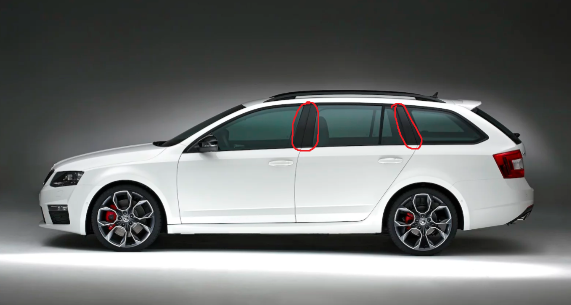

Hello guys, i want to ask you if its possible to buy a new outdoor plastic frame for octy3 rs doors, mine on my octy 3 rs are shiny and they are made from a very sensitive plastic and they are now very scratched and its looking really bad, is it possible to dismantle them and replace them ? or did they come only with a whole doors ?
I mean this :

I can't answer the question about replacing but it is possible to machine polish them back to looking new.
Autoglym Super Resin Polish and a bit of elbow grease will make a huge difference, circular motion and a bit of pressure, if you can get it over there
If you have a machine or know someone with one then that's best
Think there bolted on. Open the doors and see if ypu can see any fixings.
I would try to machine polish first tbh. it looks to be a PITA to remove
This stuff's really good for dark colours and hiding the scratches in the trim :
http://www.cleanyourcar.co.uk/glazes/poorboys-black-hole/prod_494.html
I plan to machine polish mine over the summer - some parts are really badly scratched thanks to the way it was cleaned before I bought it.
Also have LOADS of annoying scratches on the gearstick surround ... black hole glaze tends to hide them pretty well too.
One of mine is like this also OP. Planning to machine polish it which should hopefully bring it back. Failing that you can probably do it by hand with a polishing pad, a cutting polish and some serious elbow grease! How deep are the scratches? If you can't feel them with your fingernail then they should polish out.
These look really rubbish and mark far too easily IMHO. Even fingermarks seem to scratch them - I try to avoid touching them, but try telling the missus and kids... :dry:
Machine polishing will sort them, but make sure you mask the surrounding rubbers first, and be careful not to overheat and damage the plastic.
Polished mine up  by hand with some Meguars crystal polish and then black hole glaze. Come up a treat.

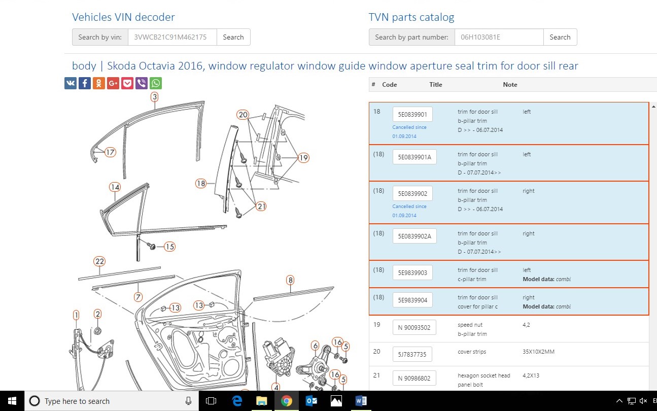

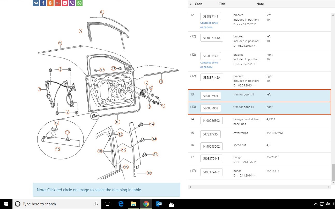

Thank you guys for your answers :) i am planning to polish it with but i want to be sure i can buy a new one when something goes wrong, im super cautious since i damaged my old octy2 headlidhts when polishing :D i guess i will find some cardetailing garage and let them polish it :)  Thank you @imikk3 for scheme i will look at it tomorrow :)
